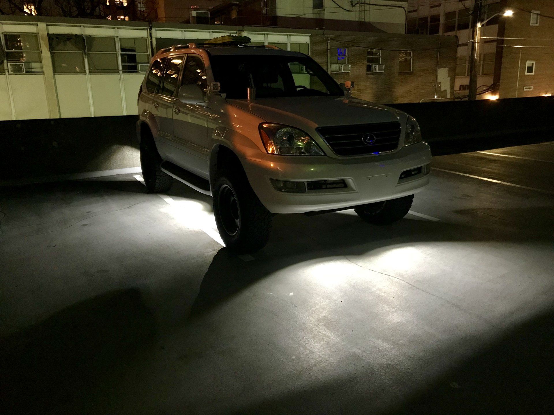

Sliders are soon to come but in preparation I picked up the OZ USA rock light kit for install. I used an aluminum “L” piece cut in to 2” lengths and bent from 90deg to about 45deg. Used self tapping screws to mount the brackets to the frame and rand the wires inside the frame rails. Two lights on the rear and one under each door. More pics to come.
Oh, I wired to my Switch-Pros controller. Plans to wire into the factory courtesy lights at some point.
How bright are they?
Pretty bright. The switch-pros is nice because I can dim them.
