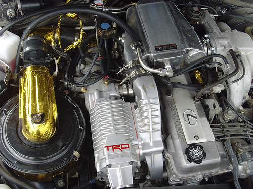

WAIC - Water to Air Intercooler
WAIC - Water/Air Intercooler for TRD SC
