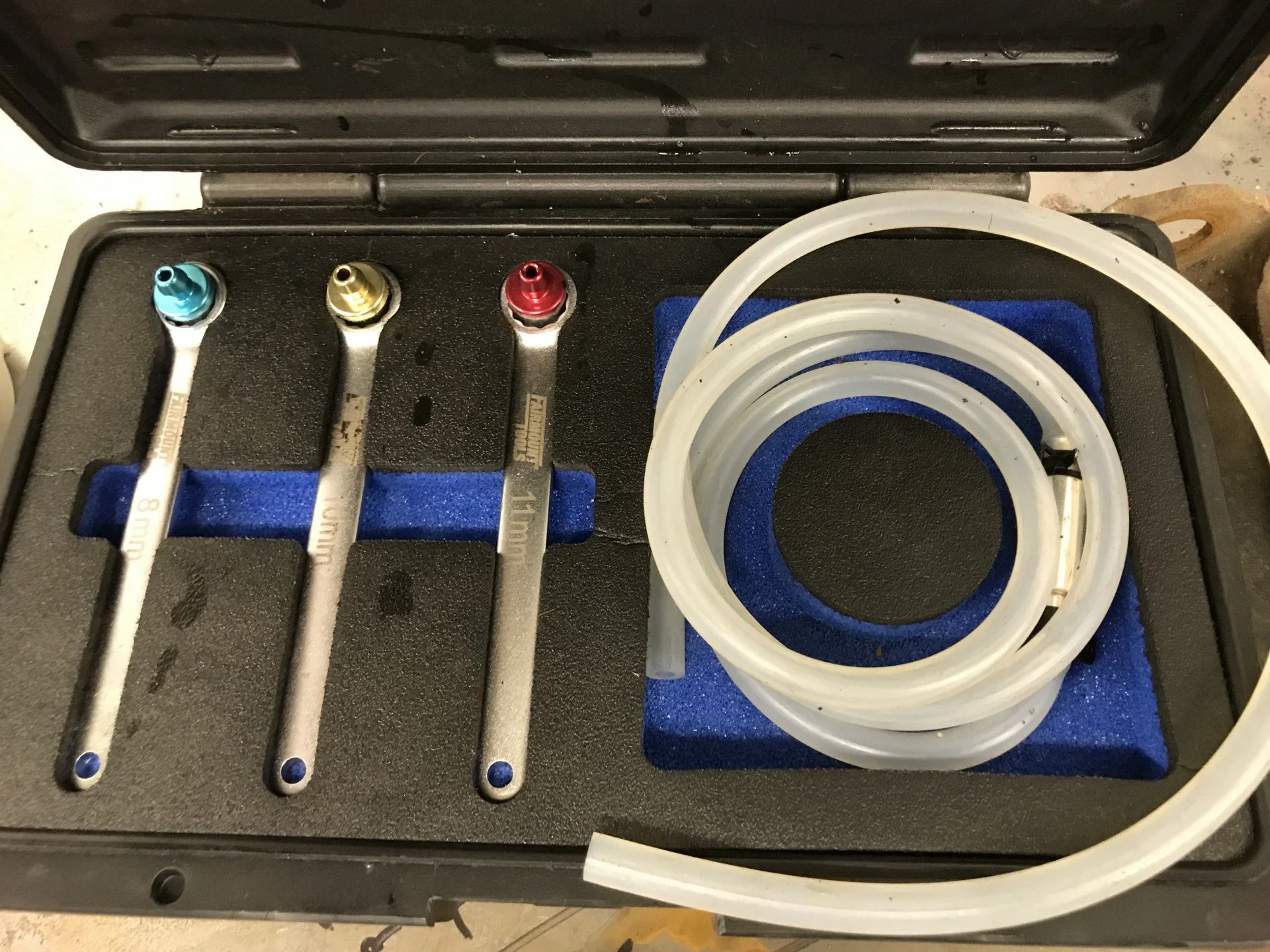

I got a Mity Vac and have used it a lot.
This is my preferred tools these days though.
Works excellent.
