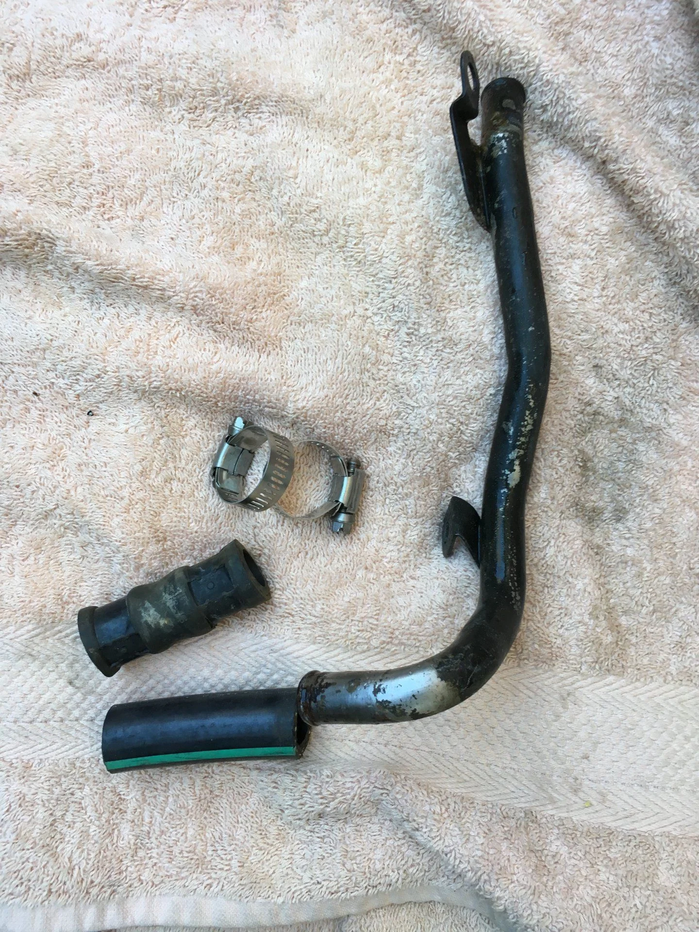

refer to my scribble below:
1. remove the hard line bolts and hose to heater valve
2. under truck, remove hose clamp on engine and
3. entire thing will fall out - clamp on the new hose to hardline and reverse procedure.
So you only are under the truck to push in/pull out the phh, and loosen/tighten one clamp.
If I had the Toyota OEM hose and clamps, it would have been even easier because OEM clamps just have a pull tab- no need to spin a wrench.
I used Gates green stripe Rubber hose and stainless clamps, it's what I had handy. I would have used the OEM clamps but Gates green is too fat.

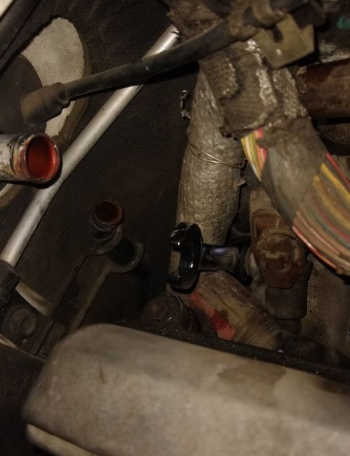

Discovered an old Daiso (Japan dollar store brand) ratchet wrench could grab & spin out the lower pipe bolt. The outward "snout" setting the smallish head 23.3mm OD away by ~3mm helped:
My HF Pittsburgh Pro 12mm box ratchet measuring 24.7mm OD didn't line up when I tried. YMMV and worth a shot with tighter tools:
I can't find the 4-in-1 ratchet wrench available at Daiso anymore, but something like a Channellock 841M set could work if the head is 23mm-ish:
Went with Gates Green Stripe this time, thanks to everyone's advice & options.
If Heater Valve dismount is an option (changing hoses), circled the lower bolt visible under the EGR.
I gave up topside approach due to ill-perceived limited swing, 2nd pic was my stubby 12mm box ratchet 🔧 not really lining up.
Then, only AFTER viewing my flash pics spotted a foreign object there -- yes that's a stubby driver hiding from PO!
Posting in case helps another with an offset / open end / slimmer box wrench can succeed where I failed :doh: topside.
If ever the valve cover is off, should improve topside access? I snapped this during cover gasket replacement, red box where bolt once was:
Bottomside approach reference, with wheel + starter + transmission dipstick tube extension slid off yields a tunnel ~14" long to the frame rail:
