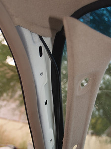

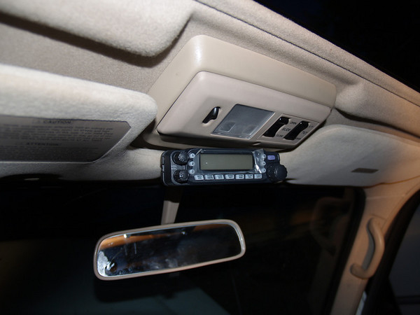

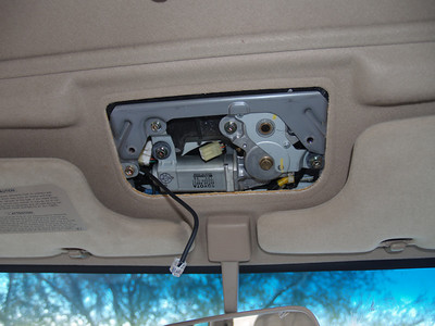

first a little fishing trip threading the "phone cord"
thru the headliner...
then i pulled the rearview mount and added a RAM
mount ball, nice and solid....
dropped another ram mount on the back of the head
mount that comes in the kit...
and there you go. sunvisors have room, sits above
the mirror, doesn't block the map light...
not sure what about the mic location yet but the
barleypops were calling so thats it for today...
Now that's what I call a clean install. Did you use the ram's short arm? I think it's a 3incher? Curious to see where you mount the mic - post em up :grinpimp: Time to redo mine...

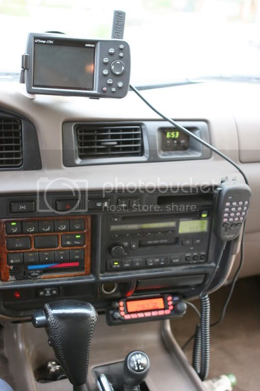

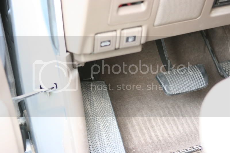

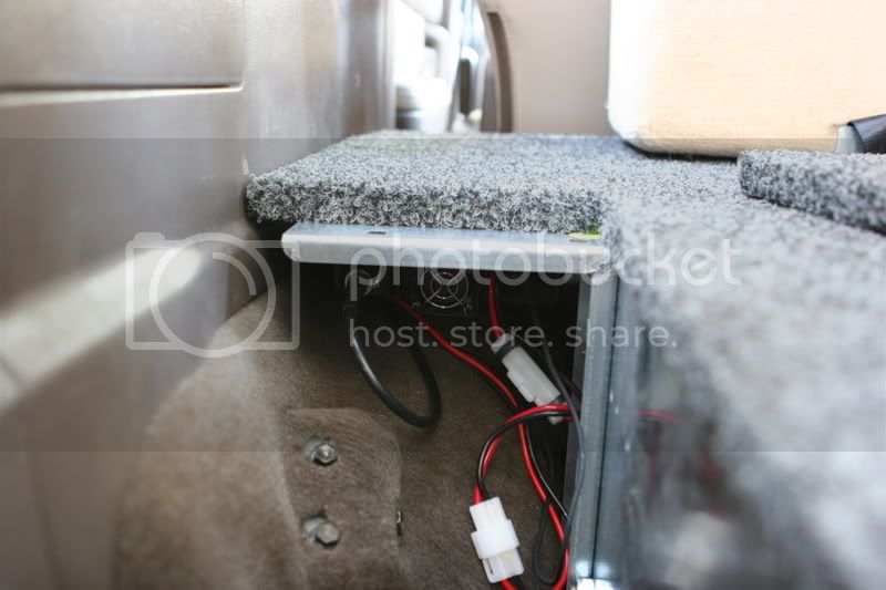

Coincidently I just finished installing mine as well. Here's a couple pics.
radio under the aob drawer system. This location allows me to hook up a notebook for frequency programming. Also doesn't rob storage space. If it gets super hot I'll wire in some computer fans for added air flow.
Here's an external speaker, above the footrest. I wanted to put it in the dash where the factory 3.5" speaker is for a stealthy install but decided against it. I'd like to upgrade the 3.5" when the rest of the sounds are upgraded.
And finally the faceplate/mic. I wanted to keep the faceplate out of the sun, keep a factory look, not have the mic cable hang in front of anything. I like JM's install more though, very slick.
Additionally, there's a ram bracket that fits right to our rear view mirror?
i took the plate that holds the rearview, drilled it and mounted a
ram mount ball to it. i used it because it was the most rigid thing i
could find to mount to, it's tapped right into the roof structure...
.. i'll shoot some more pics tomorrow.
yes it's the smallest arm they make...
me to. i ran out of time today so i'll be looking at a couple of
different things tomorrow. i may run an extention back down
to the dash for the mic...

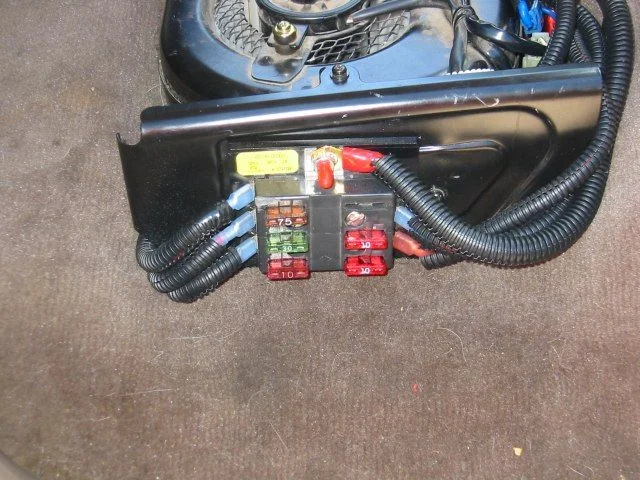

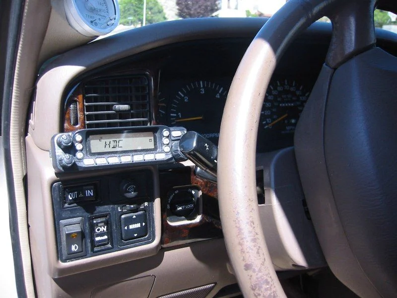

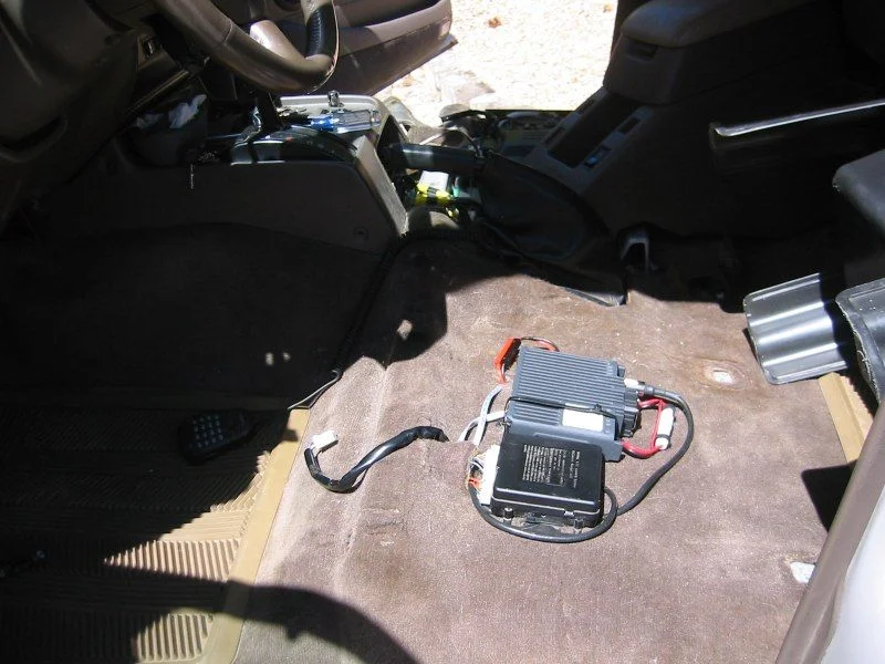

I installed my FT-7800R under the driver seat with the head mounted to the left of the steering wheel. The flat cord for the mic comes up by the parking brake. The radio is currently wired to the aux fuse panel. Remote speaker is attached to the DS headrest.
