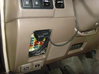

I have to pull the plastic panel and route the wire behind it but it's a 2 minute install. Just plug it in and set it up! The only thing is the fuse panel cover doesn't fit w/ the plug in there so I have to trip the cover or leave it open- no biggie.

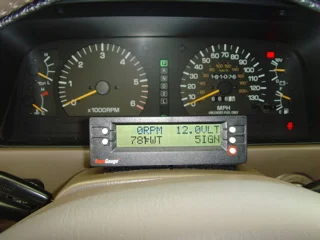

I set it up so the water temp and rpm are over to the left, volt over to the right (like the dash). You can pick what you see.

I decided to try and match the stock toyota green backlight. lots to play with... I want to read actual MPH, so I have to read how to set that up

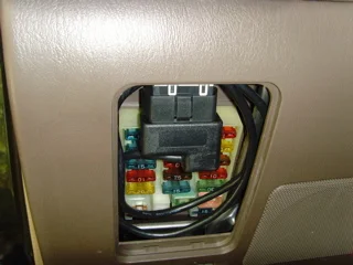

As for the cable/plug, on other thread(s) I've read where at least one person simply unscrewed the OBDII port from the dash so it and the connector could be tucked back in there. I haven't done that yet (been 4 months now) myseft and not sure if I will as for emission tests here the tech has to have access to the OCDII port. But, doing so will allow you to tuck that stuff in there and put the fuse cover back on.
I've had mine for a few months now and its great. Actual numbers for temps, adjusted speed for tire size (and displaying it in km/h eh!), and the code reader to get rid of the pesky 0401 code that my truck loves so much:rolleyes:. I unscrewed the ODB II port, flipped it up 90*, and screwed it back to the panel (there are two hole there for that mounting config) so the cover fits right back on.

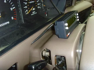

The only thing I'm looking for is a better place to mount it. I have it velcroed to the front of the shifter console where it meets the center dash piece. Only problem is that the screen can be quite difficult to read, especially on sunny days or with the sunroof open. My buddy mentioned making a fibreglass mount to integrate it in below the radio (aftermarket single din), so I'm going to look into that idea.

Cut a hole in the fuse cover for the cable. I don't know how you have it mounted on the steering column. I tried it there and it blocks almost all the idiot lights. I mounted mine below the heater controls:

thx for the tips,
so I tried to mount the OBD port facing up but there is no room for the plug, so I unscrewed it, plugged it and screwed it back in facing downward- it isn't ideal but now it's all hidden and the cover fits back on :). Fed the wire behind the dash and out at the steering colum gap-
It's clean thanks guys
