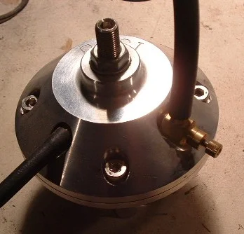

Still baby steps (under 4 lbs). I swapped in the Supra TT fuel pump but still have the BEGI rising rate regulator sitting on the workbench. I'm in the process of re-doing the intercooler plumbing as I did a rush job using the 105 stuff just to get it on the road again. It's an odd metric size that is essentially 2". I'm going to go to a full 2.5" tubing (I think the 3" is just overkill) and get the angles a bit tighter. The one good part about it now is that it lets me keep the air filter in the normal place and the second battery tray and the windshield wiper fluid bottle (Scolaro Corolla relocation version). So it dind't make me compromise on those things. Once I have that cleared up and I can get it on a dyno I may take Darren McRae's advice and plumb those throttle body injectors with boost regulated H2O/methanol.

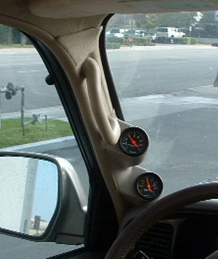

Here is the boost and egt gauge pod, both Autometer with green backlight so it comes pretty close to matching the stock dash stuff.

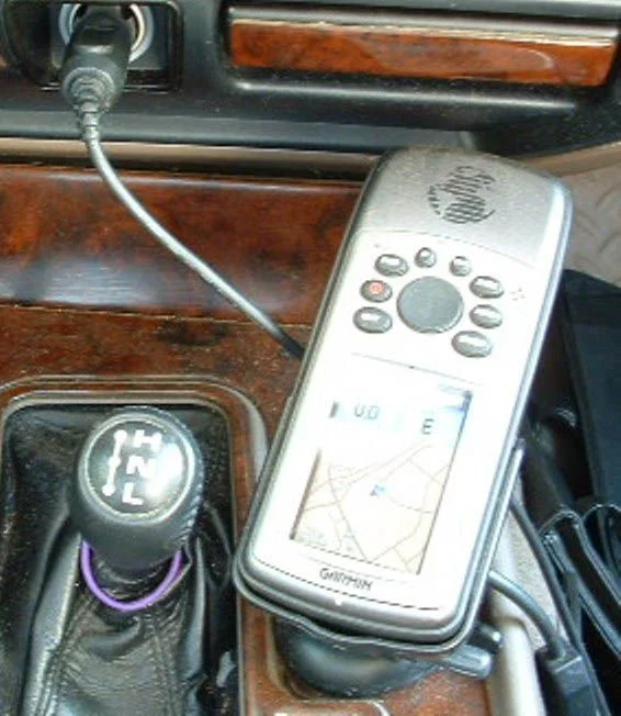

I also added a Garmin GPS76CS that I have mounted down by the shifter and patched into a laptop that currently just sits in the passenger seat. I mounted the external antenna on top of the snorkel head like shown on Slee's site. The one change I did was to silicone a base plate to the snorkle and then attach the antenna "pod" to it using the magnet. This allows me to pop it off if needed like if I use the pre-filter head for the snorkel or needed to service the snorkel or GPS or if I just hit it hard against some branches. It does stay on at high speeds though.

This is the BEGI rising rate regulator that needs to be plumbed in.

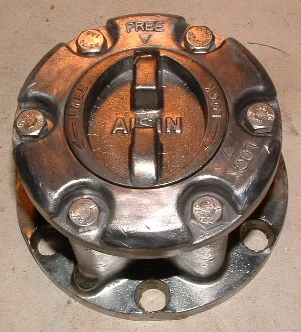

I also had these front locking hubs on but wanted them to match the Sequoia wheels so I'm busy cutting out the center of the plastic center cap so these look "stock". At least out here in southern CA I can do this and not worry too much about corrosion.
