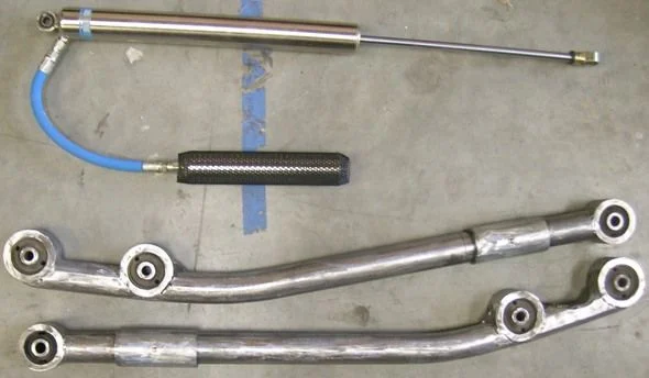

While doing the front control arms and trying to determine how much travel the front could get I got a lot of info from a couple of folks here about running the Bilstein 7100 shocks in the rear. Here again, the extra 1" from the body lift allows me to put the top mount up a bit higher. These are the 14" travel with the remote resevoir. Valving is 275/78.
Clown whats with the remote resevoir? It looks loke carbon fiber in the photo.

for the 7100's what did you do about the upper stud? I thought they came stock with eye/eye. Did you use an adaptor or get a custom stud fitting. Also what are the exact dimensions?
Semlin, those 7100's have the eyes at both ends. I'm only using them in back for now until I can prove I can get more travel out of the front than the OME 73L's can provide. In the back I'm just cutting the bottom pin off and welding in a C pin bracket. At the top I'll do a modified version of what ActionJackson did using a plate with the center cut out to mount where the stock one that accepts the shock pin is now with plates raising the eye mount bolt as high as I can get it.

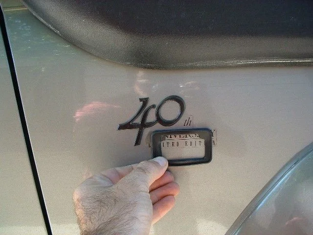

Still undecided about how to proceed in mounting the non-US oem side-marker lights. The "40th" badge is right where it should go and these decals are no longer available. Mine is showing some wear so I'm not too inclined to keep it but have considered just keeping the "40" to completely confuse folks and put the side marker like so. I'm planning on having the corner, front and this side marker all flash.
