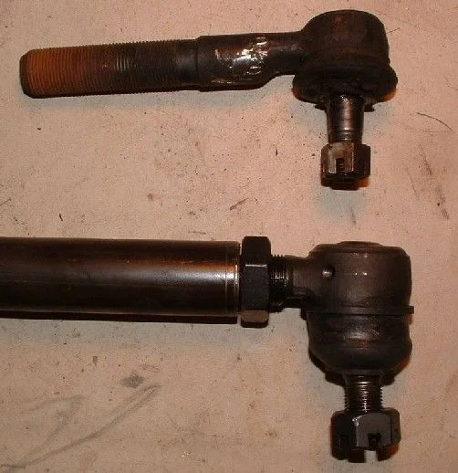

One thing that comes up with the added lift from the bigger springs is the the clearance between your steering connecting rod and the tops of your front control arms gets tighter. But you can't raise it too much either due to the driveshaft and swaybar. AMMO has gone to a heim joint setup that fixes it pretty nicely. I probably should have gone that route but I liked the idea of TRE's on a truck that sees a lot of miles on the road. I saw a sweet setup in the Hardcore section of 4x4Labs set up using GM 1-ton TRE's that have zircs and a 0.25" DOM tube. Luke had it to my door a day after ordering it since he was cutting and threading tubes when I called. I'm now waiting for my own tapered reamer (since no one in their right mind loans the out!) so I can install this bad boy. Top is a stock 80 TRE bottom is the new set up. Still not sure if I'll go with them in front with the draglink but mulling it over.

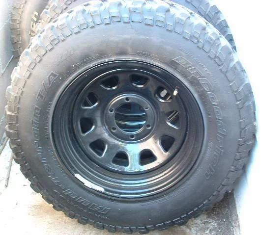

Well Matt, these are the 17" x 9" steels I have but I keep watering these 33's that are mounted on them hoping they'll grow to a set of 37's but no luck...

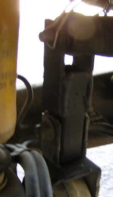

Front sway bar "quick" disconnects
I got Slee's sway bar drops for the front and rear quite a while ago but have long since removed the rear swaybar and only put it back on when doing a long cross country trip on pavement. I will probably make the disconnects someone (sorry I'm forgetting) posted pics of where the rod is cut then tubed and using the same type of cage-pin I'm using up front.
The front is much, much more noticeable when it is not connected so I wanted to have "quick" or relatively quick disconnects. Previously I was just unbolting it from the axle and then zip tying the ends up to the frame where the mount is for the bumpstop (that we don't get).
The first thing that bothered me was that the mounts were so low on the axle it was really difficult to get to the bolts or a pin to pull. These mounts are 1"x1"x0.25" stock. An 8-mm bolt was welded in the bottom as a centering pin so it sits in the existing hole at the bottom of the stock mount. It can't be too long otherwise it will hit the top of the control arm bushing ring. That's why there's no nut on it too. The thought was that it needed to resist moving forward or backward. Then it was just 1"x0.25" flat stock welded on the sides of the square stock to replicate the mount higher. Simple cage-pins are used to hold it in place and can be pulled at the trailhead.
I still haven't got around to making the "receiving" end that I will mount on the frame. Once the control arm is free from the axle it can be rotated up to the frame and conveniently is very close to the tapped holes for the bumpstops.
I've had these on now for a few weeks, road, gravel, dirt, trails, etc. and no problems at all so far. Not a true QR but functionally close enough for me.
Thanks to Iverness for doing all the hard stuff - mainly thinking...
ok, that's a really bad pic I took in the parking lot. Will get a better one here in a sec.
