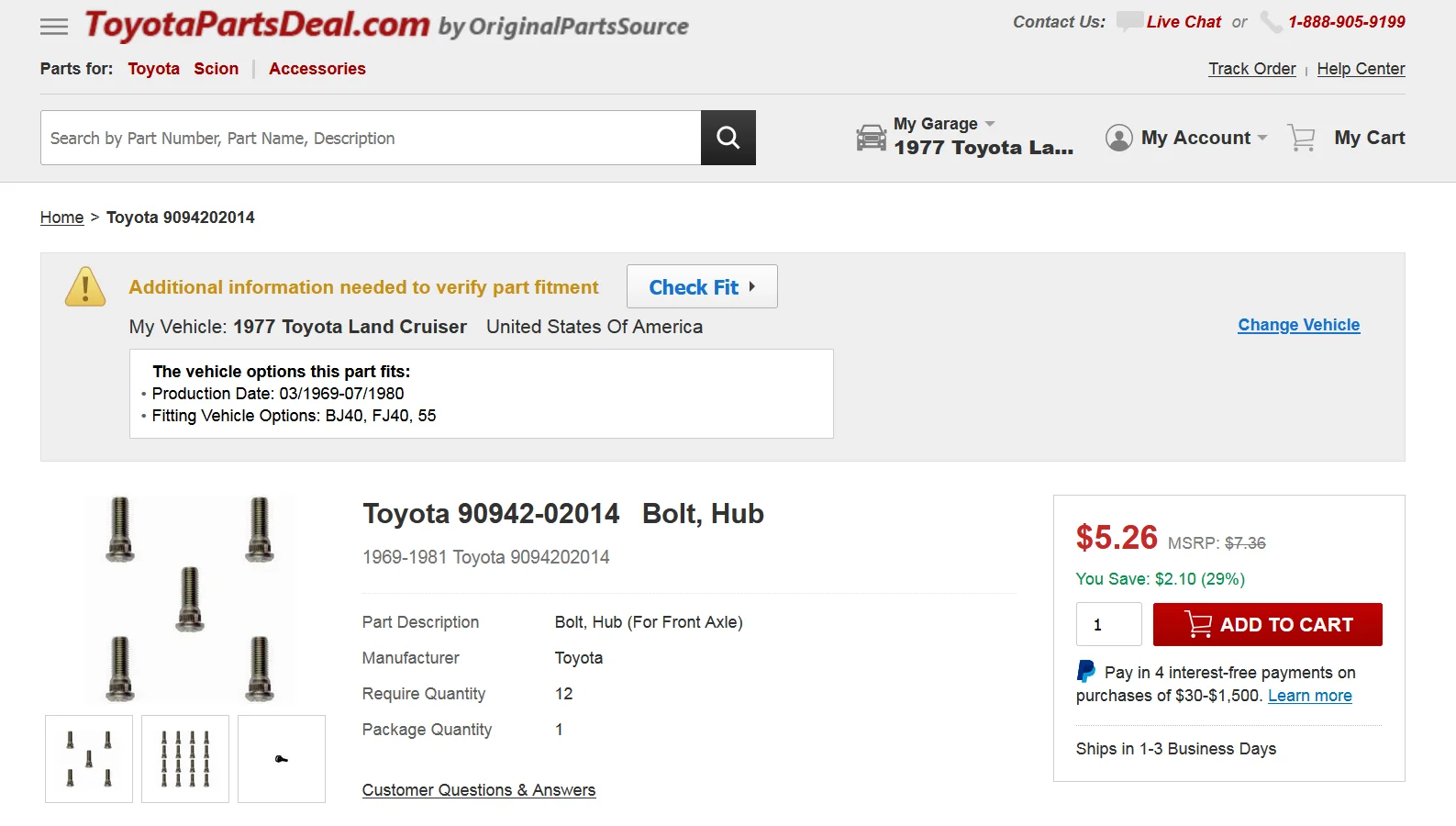

The studs that are listed for the later model 40s are 90942-02014 (no idea what the dimensions are)
at least one online vendor, Toyota Parts Deal (I have no experience with these guys)
I used this part number search
Matt beat me to it...
Now that I am on desktop and can see better I think I see the recesses and 2nd set of holes for the shorter studs, he may have the 75-80 disc hubs that bolt the rotor to the hub rather then the lugs that press through on +80
