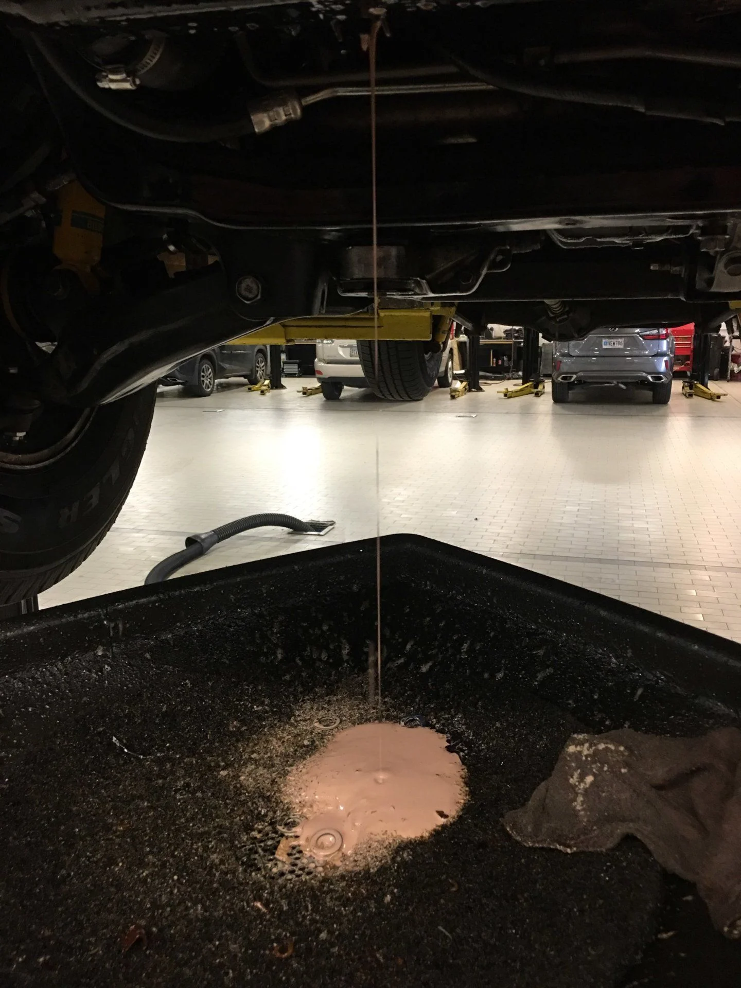

Hey All,
I am going to be doing a larger post with my entire situation surrounding the unfortunate circumstances ( quick hint: Denso radiator from Amazon fulfilled by Parts Geek) that led to the thing you never ever want to see:
Long story short, I have done a few things to get past this, swap a transmission ( thanks to the camaraderie and help of this forum in sourcing AND installing), flush the transmission cooler lines, buy a new transmission air cooler, flush all metal hard lines, new rubber A/T hoses, new radiator ( the other 'new' denso that caused all of this was trash and will outline with pics in my next post later today).
Here is where I need your help/ advice the most:
I have no idea the best way to flush my engine block of the remaining "strawberry pepto bismol" type crap that got sucked in with the radiator.
Does anyone have the best steps for me to clean out this stuff from my motor BEFORE hooking up a new radiator ?? ( I bought a CSF, wish me luck)
This is my final step and really could use the advice to ensure I get it done right.
I really appreciate your help and your support as I come back from this disaster. Many kudos to all of you that took the time to read this and help on my journey to recovery.
