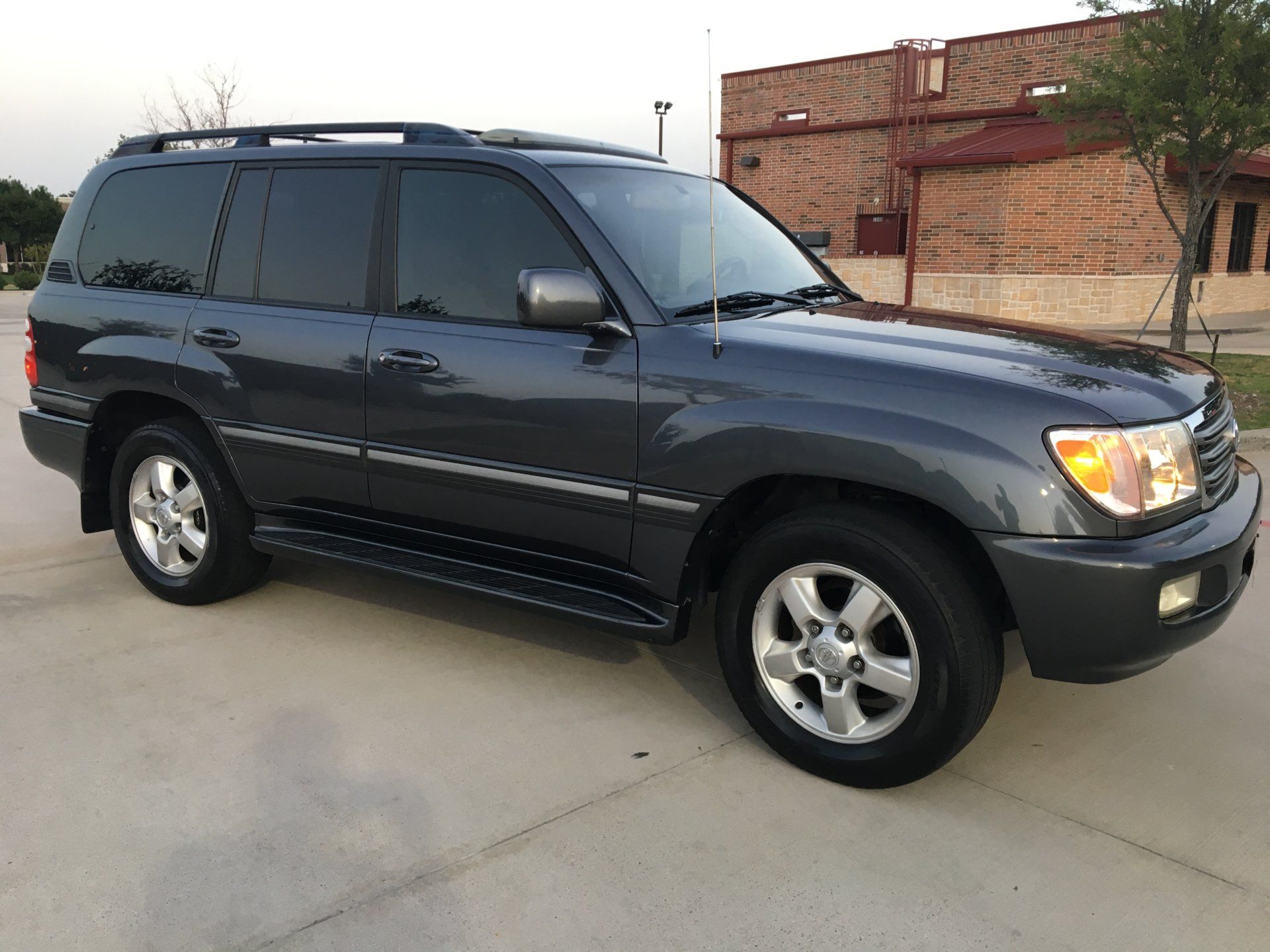

New member. Been looking to get a family expedition vehicle for a while since we traded in my xterra three years ago and just purchased a 2006 Lx470 in West Palm Beach, FL last weekend.
I'm slowly working my way through the issues (no matter how pretty they look, there's always something to fix!). So far I've gotten a new exhaust, I'm literally writing this post in the tire shop getting 33's installed (and found out all five tire sensors are dead) , and my mini vci cable will arrive tomorrow. I really would like to turn off the auto retract steering wheel. Also replaced the non-working auto antenna mast.
There's still a list of things to get through, however:
- only have 1 key
- check engine light for emissions (p0441 and 0455). Hoping a gas cap fixes that
- vsc and trac lights come on occasionally for code c1340... Bought new center diff lock sensor to try and fix. Any other thoughts? Read all the forum posts I could find and none really helped
- ahc fluid reservoir is a bit low
- driveline thunk is coming from the front drive flanges, so have those on order
Edit:
- also saw a b2799 code pop up once. Any thoughts there?
Unfortunately, I've had to spend a fair bit fixing these things so far, but hopefully I've got it all covered now!
On the plus side, everything works and it's only got 135k miles on it. The interior with the exception of the drivers seat is in like new condition. Timing belt and water pump were replaced at 105k as well, so big plus there.
Anyhow... Hello!

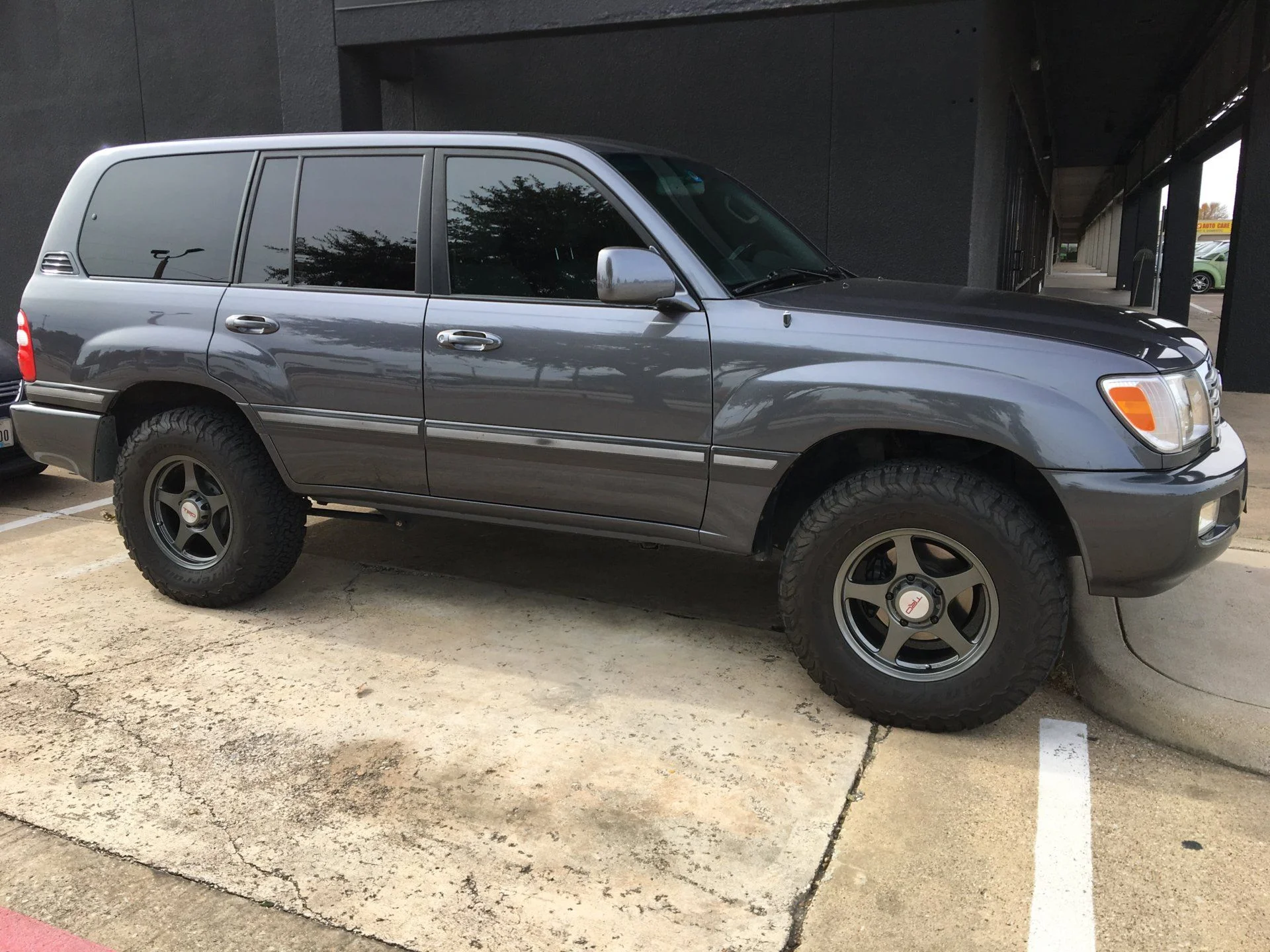

If you’re not reliant on the running boards for entry, take hem off. Big difference in appearance.
Yeah definitely makes a difference in looks, went from a nice looking cruiser to hmmm not so good looking.... In my opinion that only looks right with 33s, roof rack, steel bumpers, without that its incomplete...
but hey thats just me...:flipoff2:
happy holidays ask santa for them 33s:santa:
Like these?
