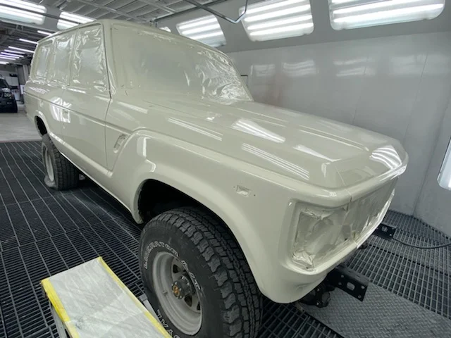

Wrong...
033 just a few months ago. Single stage no clear over.... Redding, CA
Wow!
I was given bum information! (From a paint shop)
Unless it is lead based... Single stage is allowed. Sprayed several vehicles.
Most shops only spray bc/cc because they can charge more for labor and have a lesser experienced painter apply. Shpps can actually provide a sub par initial coating and let laborers repair for less but charge a higher price.

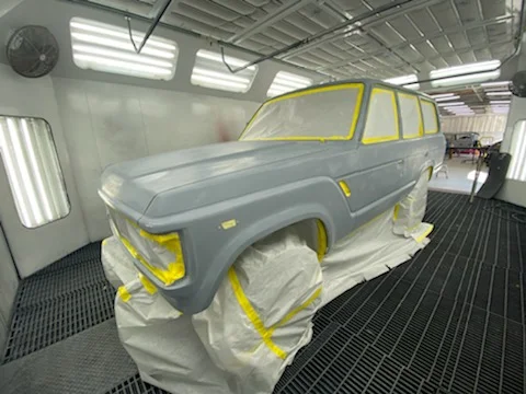

So it sounds like single stage enamel is the way to go? In the process of rust removal and then to paint. This will be an at home job, trying to figure out how many coats of primer and paint. Any suggestions would be appreciated!
yea. follow the TDS for the paint, most say 2-3 coats, I'm doing three. I'm painting the entire car, inside and out in dismantled pieces. (inc under it, where I put colour over rockprotection). I dont recommend doing it separated, so lesson learned. (the thing I would change is to do it panel by panel (repair/rust on the way, primer etc), but the final solid colour, either do the insides panel by panel, but re-assemble everything and paint the externals in one go.
Its a bit tricky to figure out how much paint I used for Primer, as I made many mistakes on the way. Overall I used 2.5 x 4L tins of Epoxy Primer (with prob 1/3 tin left). And 3/4 of a 4L tin of high-build primer. Thing I mainly learnt was that Epoxy Primer is a good sealer to put on as soon as you finish welding/body work, but before filler, as it prevents further rusting. Then use high-build primer on anything that needs work (filler etc)- (you need the depth to be able to work, and epoxy certainly does not give it). Te definition of 'needs work' is any panel that needs repairs or metal sanding/rust removel. The only panels I did'nt use it on where doors, where I stripped the paint chemically, so the underlying metal was perfect.
But for the solid colour coat, I've used 1 and 1/4 Tins so far, with likely another 1/2 tin on the weekend, so 2 x 4L tins. Might be a bit less, as I get wastage with the 3M PPS system, as I do only enough for one cup.
