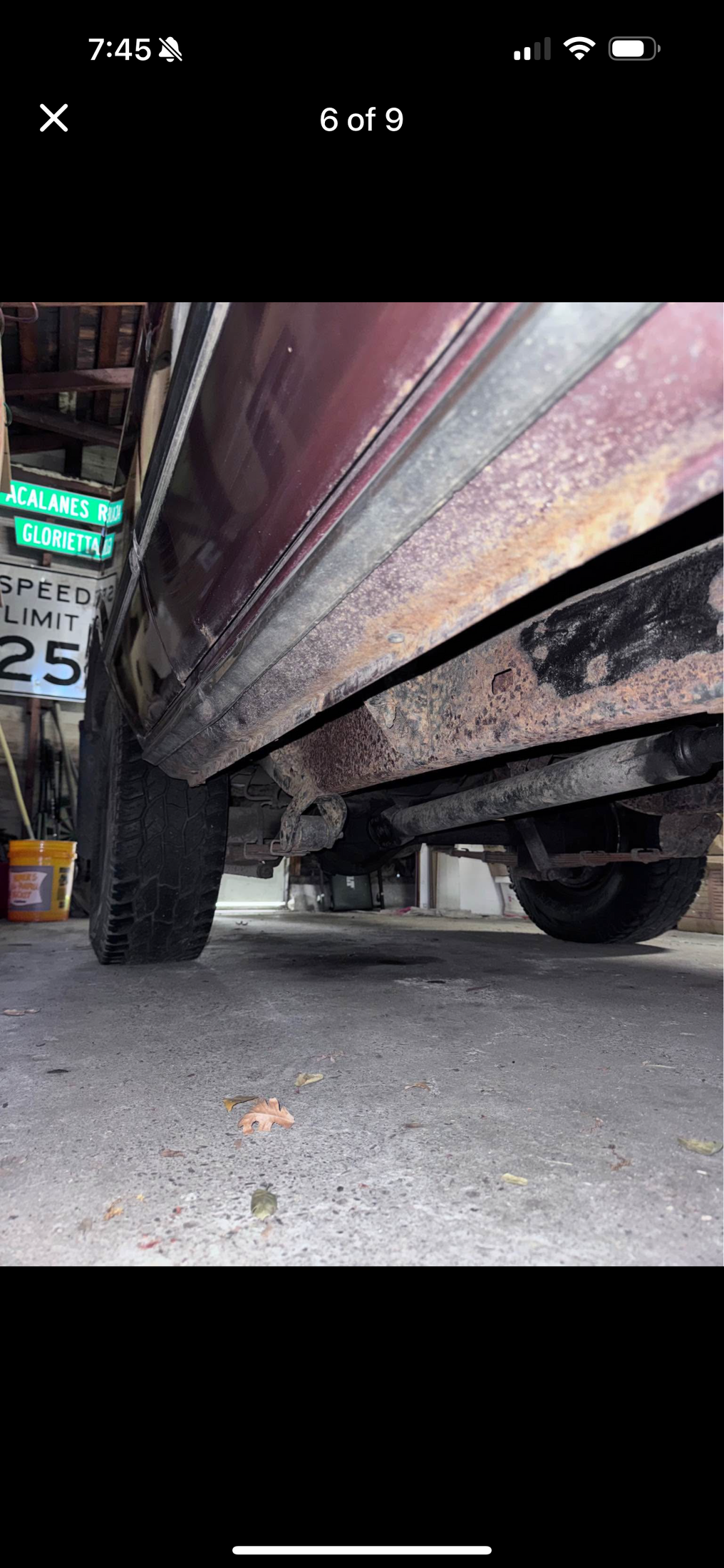

Have wanted an FJ60 since I was a kid. I periodically look at them, but they’re usually out of my price range. Found this one for sale for $6,000. Guy is moving in a week and trying to sell. He says it runs and drives fine but needs a muffler. My big concern is the rust. I’m thinking this is more than surface rust and I should keep looking. I don’t want a truck that’s beyond repair or would require frame off restoration. I just don’t have the time or money for that.

It doesn’t need to be shiny, I like the patina of the original paint and I plan to actually drive it. But, I’d like to get something that I can work on and eventually eliminate the rust. I don’t want something that’s going to just keep deteriorating underneath me, if that makes sense?

So that rust on the frame doesn’t concern you? I know nothing about rust (having grown up in dry parts of California). Looks nasty to me, but I’m hoping I can just hit it with wire stripping tool next summer and then paint over it with por 15 or something like that.
Check the rear C-channels and rearmost spring mounts. There's a C-channel insert that rusts and turns all pillowy, but if the outer frame rail looks ok other than surface rust it may be repairable. Trail Tailor sells new inserts that can be installed but it's a total pain in the a$$. Body rust can be patched. So can frame rust for that matter but it gets $$ fast. Also check the rearmost crossmember under the back bumper.
Surface rust is not a worry, but run from structural cancer.
Your location states California - while the rust is all fixable, and I have fixed a little on my cruisers body, there are definitely nicer vehicles out there - the balance is how much you want to pay now vs pay later for rust fixing
I looked around the immediate CA region - a nicer version is at least 2x in cost...

thats medium to a lot of rust, needs checking over in person, how far into the frame and body is it.... at 4k it would be less of a concern

I haven’t driven it or seen it in person. It’s located about 6 hours away, but I have a friend who lives in the area. I was going to have him take a look, drive it, etc, but neither of us knows much about rust which is why I wanted to post here. There are definitely some nice 60s out there with no rust for about twice as much, unfortunately I don’t have the money for that. I don’t want to purchase just because I can afford it, so it this looks like $6k in rust repair, I’ll just hold off.
6k in rust repair dont go far at all,
id say no it wont
and you still got the frame to deal with

It's missing the entire rocker panel lol. I wouldn't buy that. If you can't afford more than 6k I would keep saving up. I see lower tail gate cancer. The rocker panel is gone, and quarter panel rust. At a body shop that is probably at least 6k in rust repair not including paint. A pillars are likely rusting too. And you still have mechanical repairs. Unless you have a nice garage to diy everything, I would set 15k aside instead of 6k. The floors look solid which is a big plus.

Something that hasn't been covered is the SMOG topic. Since you plan on registering in Cali, you'll want to make sure it can pass smog now. I don't live in Cali but reading what others have to go through to get vehicles to pass would make me want to have a solid understanding of what lies ahead on this topic with this truck.
Best of luck with your decision. From my perspective and if your budget allows, going up to the 8-10k range might yield a better selection.
