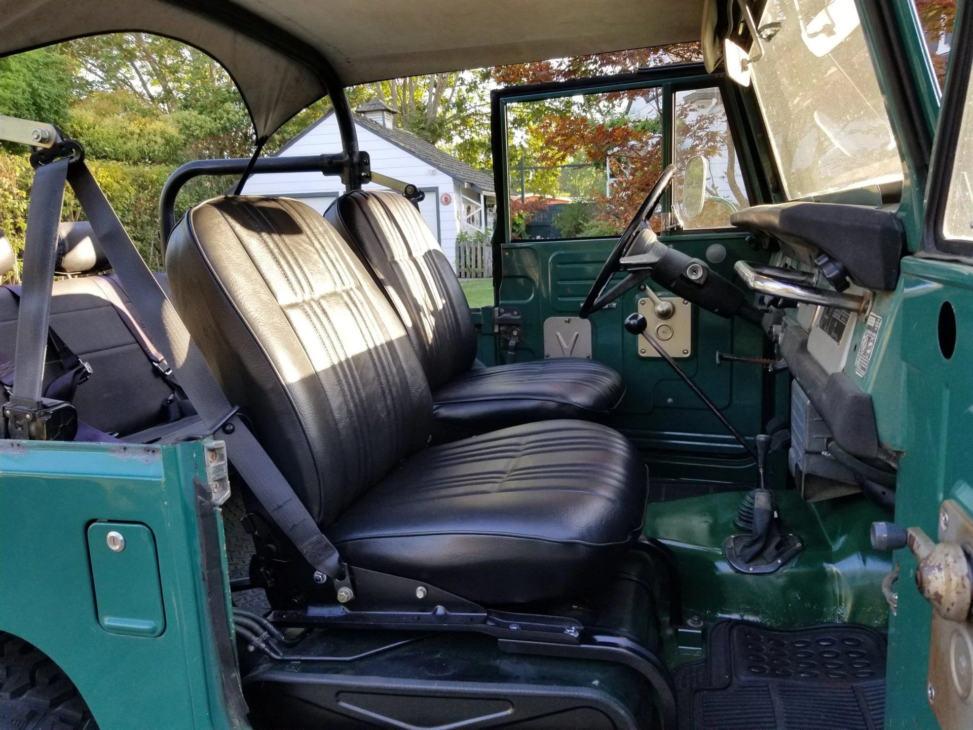

Check local upholstery shops. I had mine redone to stock pattern with new foam and even painted rails and sides for 450.00 for both seats. Very happy with results. That is less than what you paid for the foam shipped to you and they are done by pro.

Yes that is local to me--Tax included!! I told her they were going in an off road vehicle that is extra bouncy so she made the bolsters higher than stock--- So seats look stock but they hold you in better. Could not be happier with results. See my pics on 9/09/2019 page 1089; post 21,770 in the "What have you done to your Land Cruiser this week" thread.

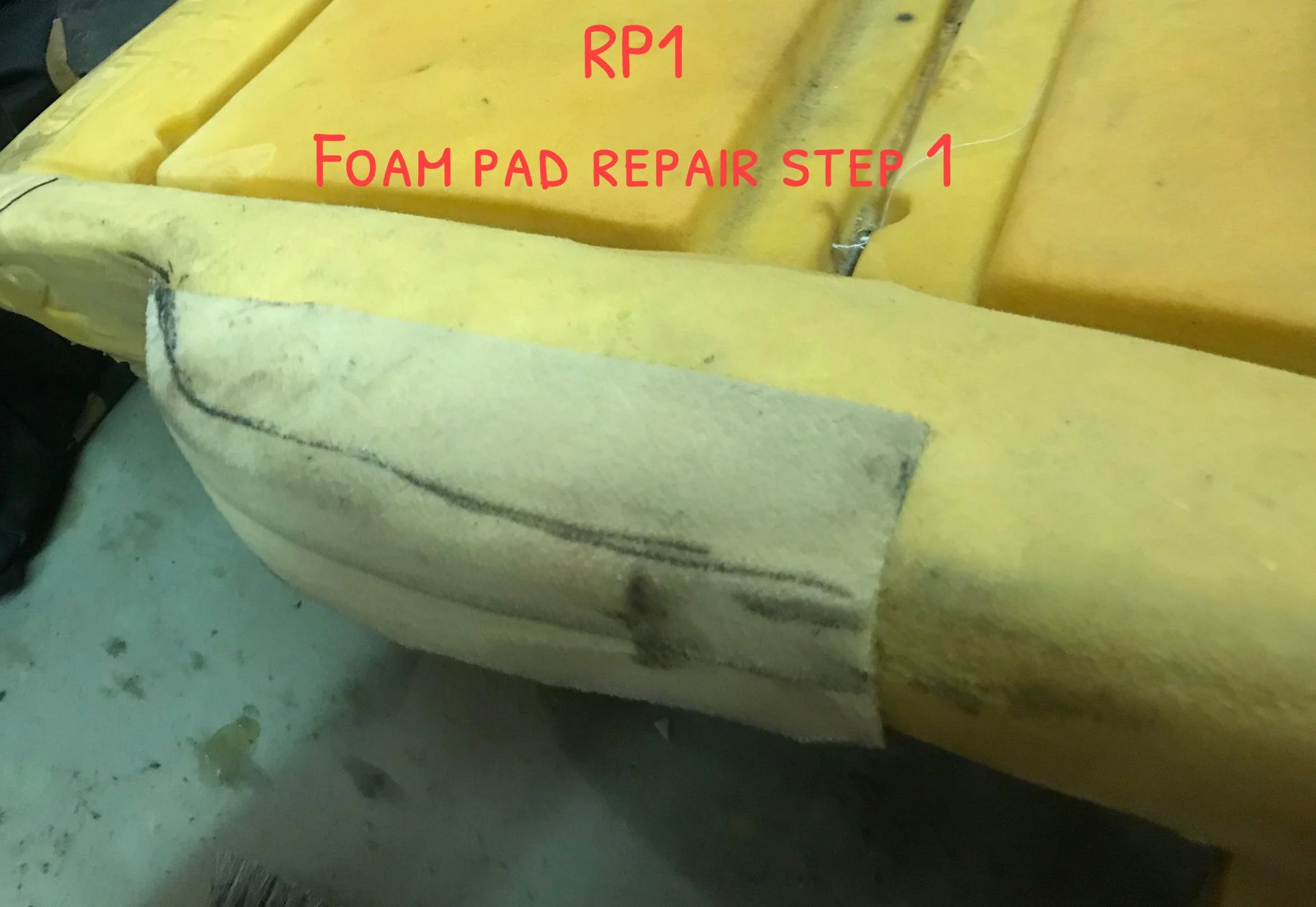

I come across your dilemma on a regular basis. Unfortunately there are only a few suppliers for LC seat foam pads. Some of our customers get lucky and find one on EBay, OfferUp or Craigslist for a discounted price. If not we simply repair the existing seat foam pad which does take a bit of time since it requires hand shaping to match the opposite side. See RP1 photo.

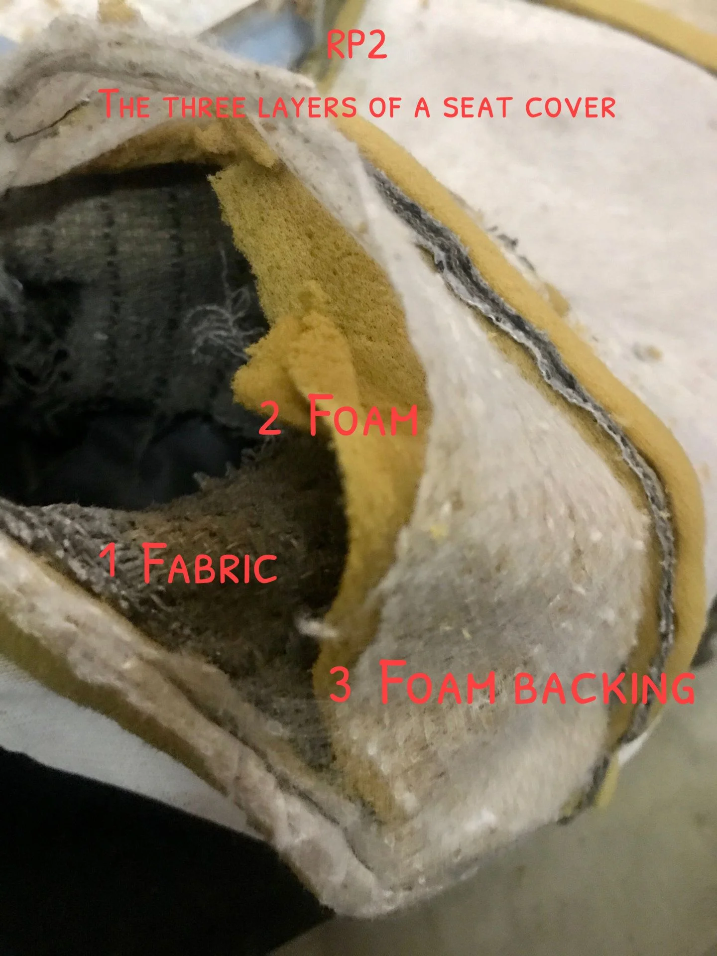

What causes the seat foam pad to break down is once the foam backing wears out on the fabric, vinyl or leather. Every time you side off your seat to exit, it acts like sand paper and over time breaks down the seat foam. See RP2 photo.

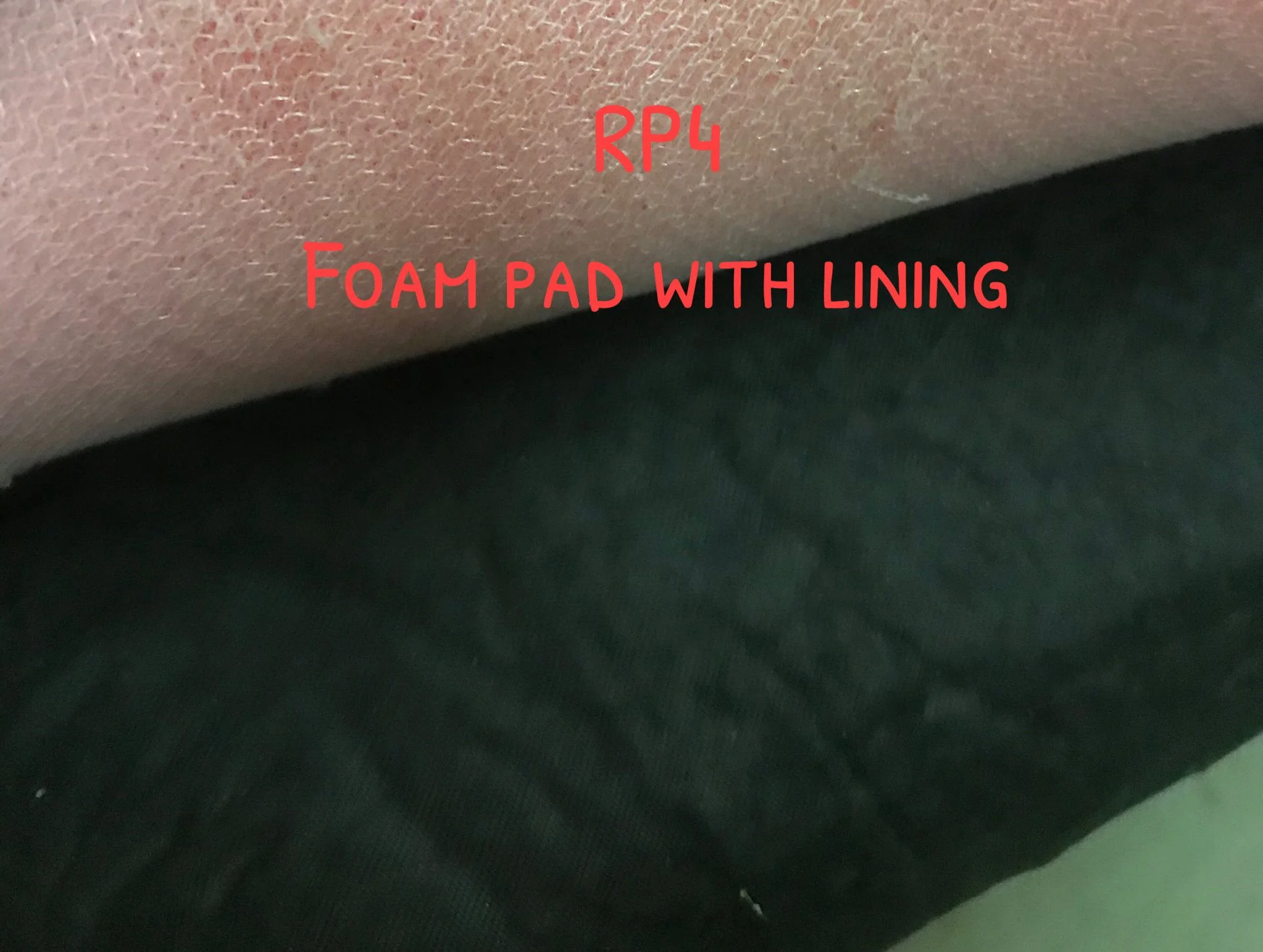

We add lining to all new or repaired seat foam pads so when you exit it glides off the foam pad instead. Basically doubling the life span of the foam pad. See RP3 and 4 photo.

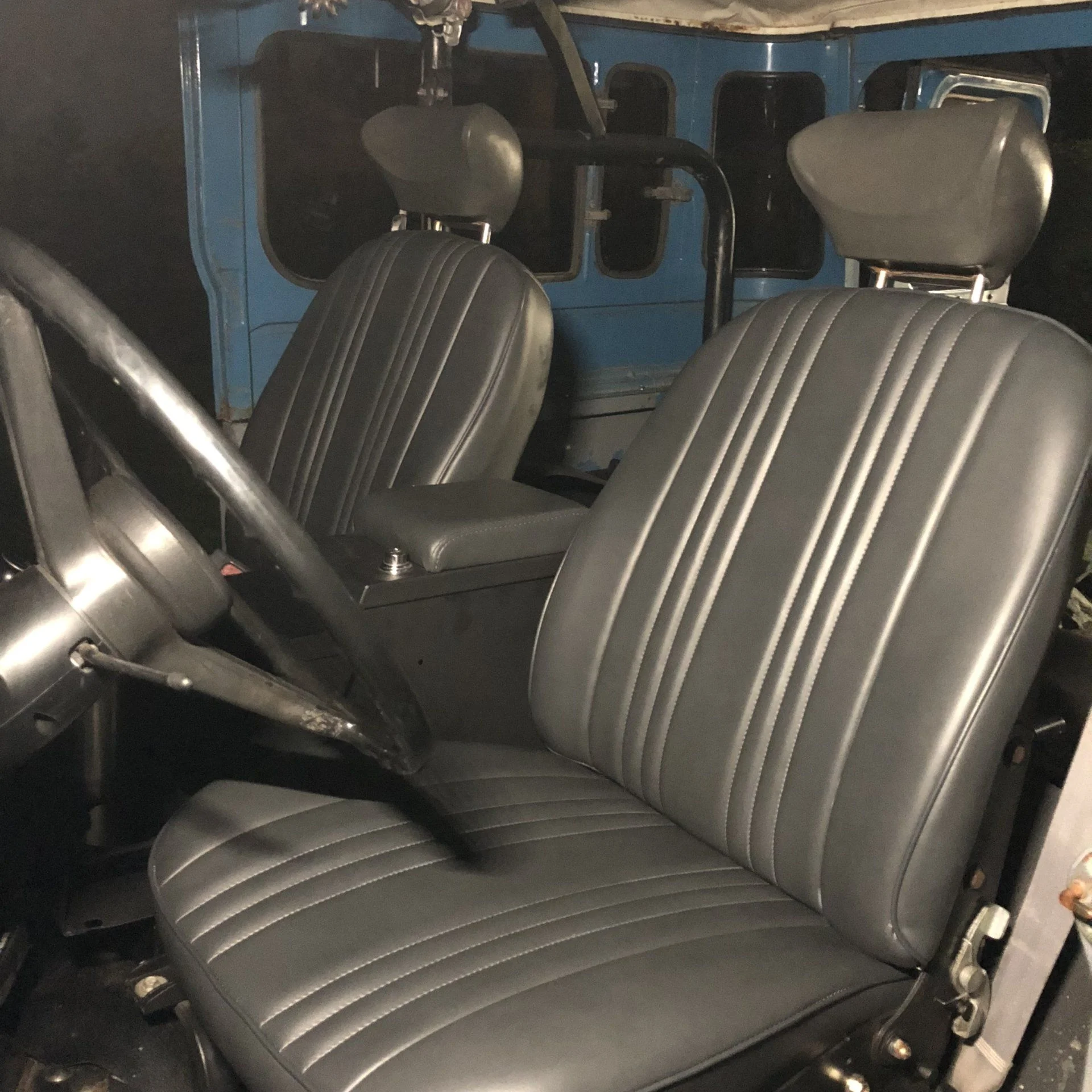

I bit the bullet on the expensive seat foam... buy once, cry once. And since, I’ve spent hundreds of hours piloting my 40 all over the US... and I’m in complete comfort 😉
My upolstery fellow was impressed with the quality of the foam... I have no idea what he was talking about but it made me feel better about investing the money in them!

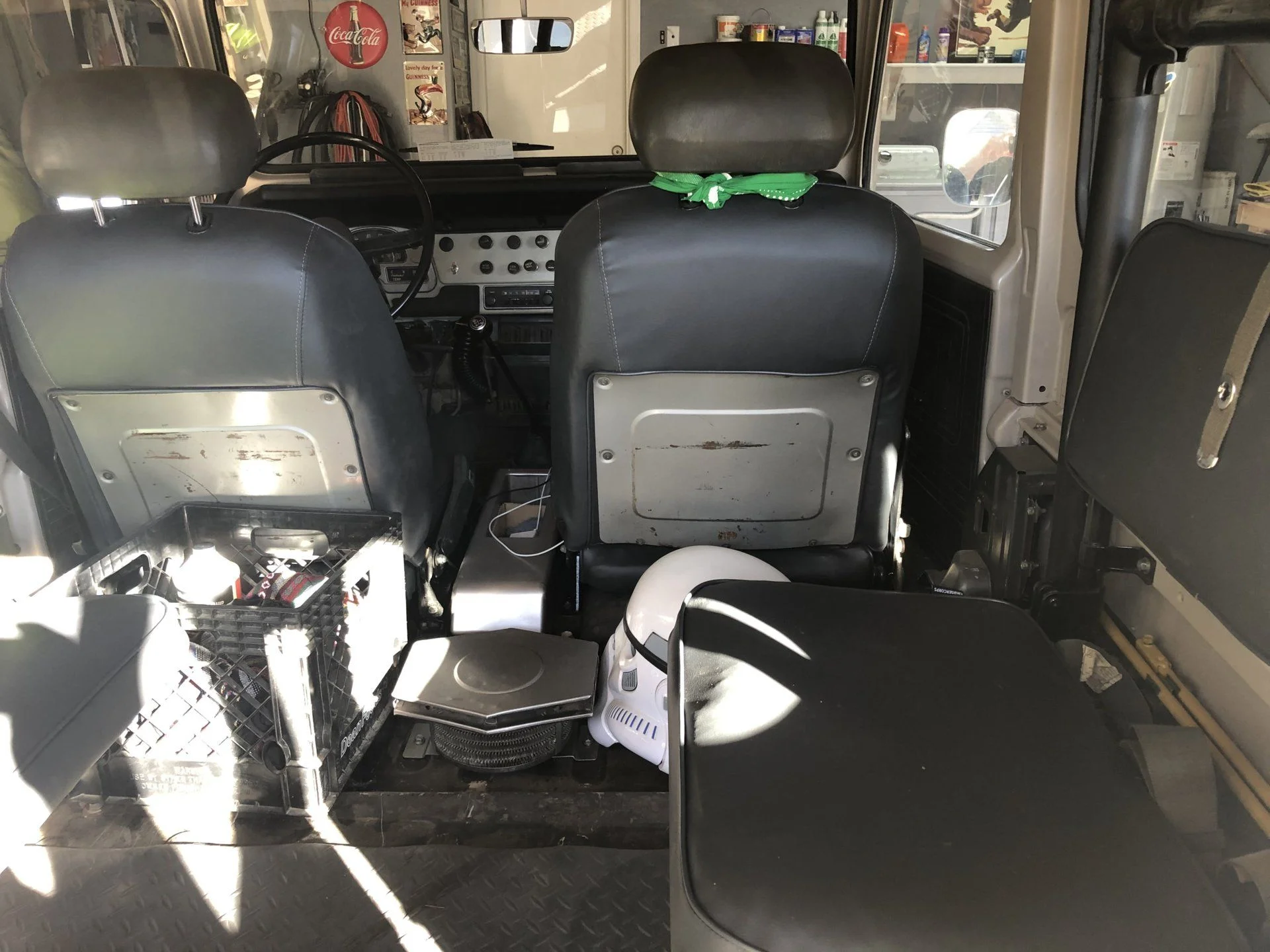

I was lucky enough to be able to save most of my seat foam. I was dreading the money drop to get new foam. I did have some foam from a pelican case that was pretty close in density. That saved me from my driver hole in the seat. Then I enameled the seat brackets and replaced the hog nail wires with plastic coated wire clothes hangers. Turned out superb. The covers where from Cruiser Corp!
