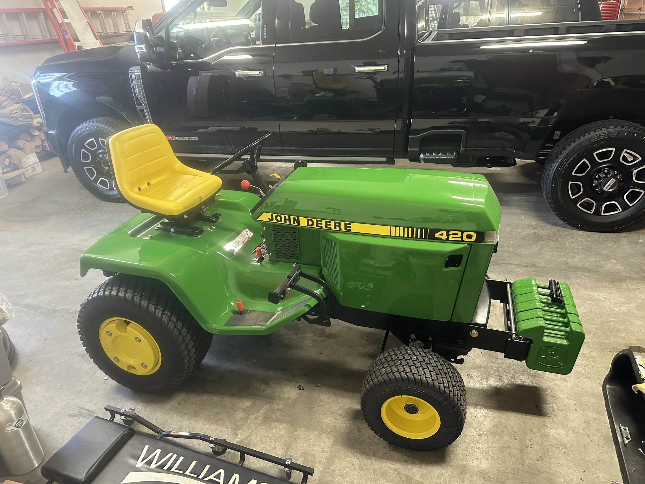

This past fall I completed the restoration of a John Deere 420 lawn tractor. I had purchased the correct John Deere brand paint and activator and despite already having bought it, talking to those same guys I made reference to above convinced me to use a quality automotive base-clear paint system. I think it turned out very well. I’m sure a purist would say it’s “over restored”, and it is a lawn tractor after all, but I’m pleased with how it looks (yes, the right front wheel bearing cover is missing).

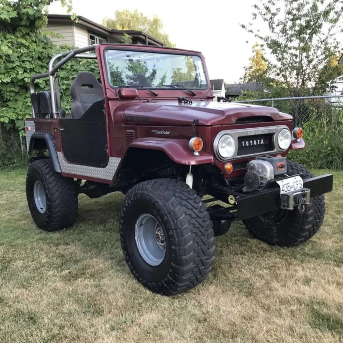

This is single stage one gallon one coat no doors no hardtop no interior except the dash. Sprayed 20 years ago. No wet sanding no polishing , The day I sprayed it and how it looks today. I needed a ton more paint. It it was all I had
Some paint just different lighting. Maybe a touch of rattle paint on the fenders over the past few years.
One gallon doesn’t go far I would have loved a few more coats plus to paint all the rest of the parts.
