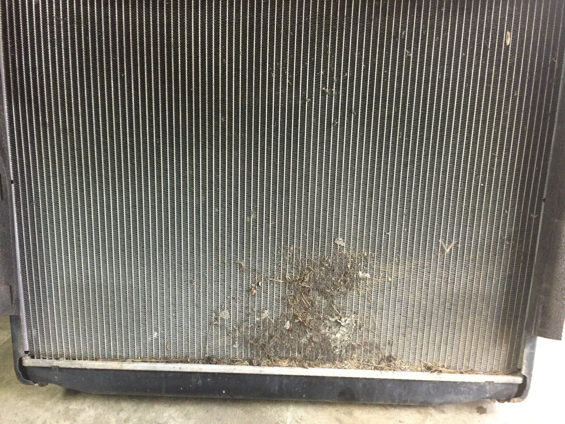

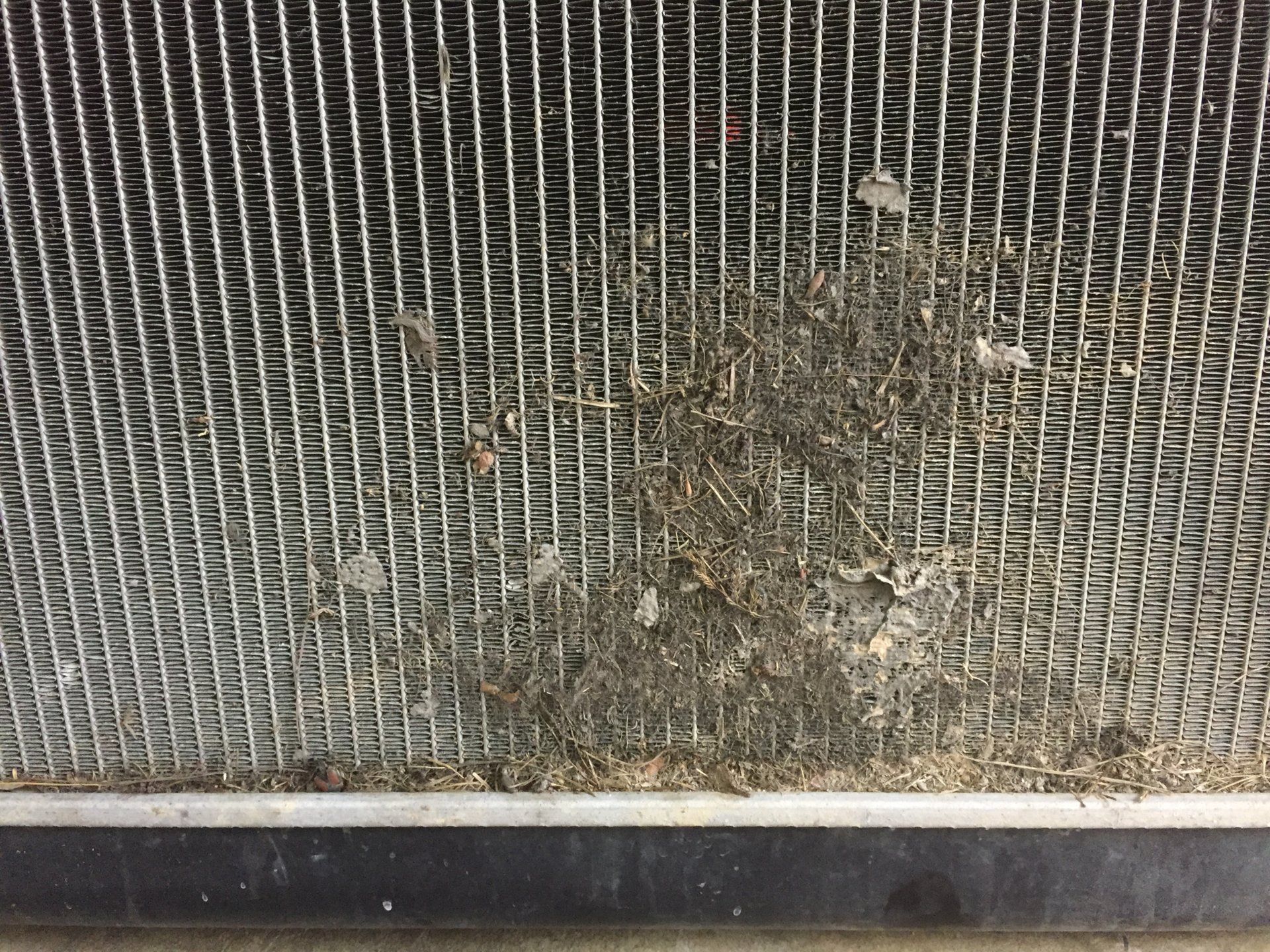

if you have the coin do it, Ive seen several 20+ year old toyota rads with as many as 270k miles. That being said Ill be doing mine soon preventatively, look between the condenser/rad for hair, dirt, dust ect build up in the middle of the exchanger. often have lots of build up ( and can be cleaned I cleaned my 21 year old corolla rad and stuck it right back in ) but is a good sign of needing replacement and reduced cooling ability.
....... look between the condenser/rad for hair, dirt, dust ect build up in the middle of the exchanger. often have lots of build up ( and can be cleaned I cleaned my 21 year old corolla rad and stuck it right back in ) but is a good sign of needing replacement and reduced cooling ability.
Like this....
yes sir, about what mine looks like.
