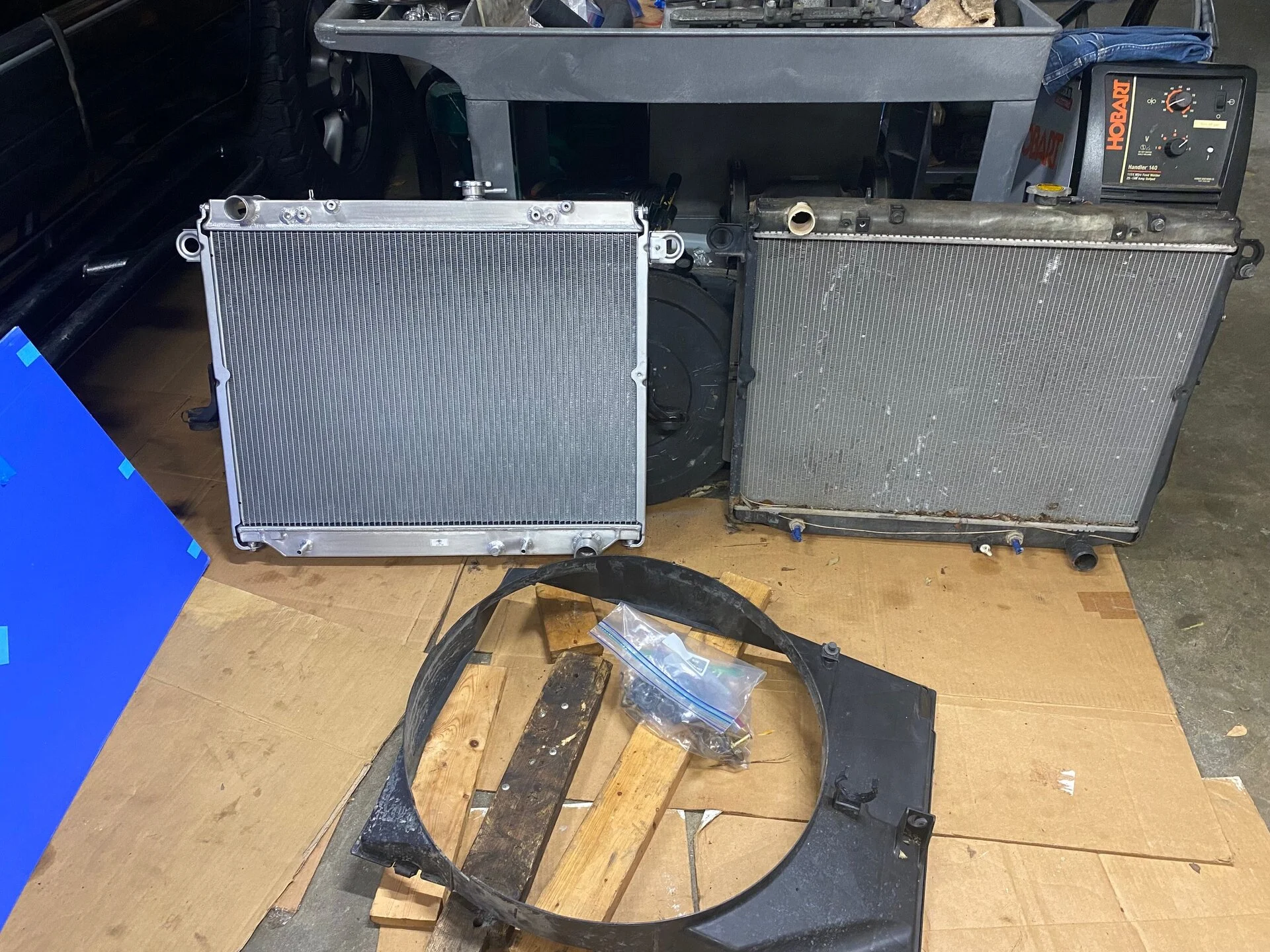

My 2021 Koyo lasted about a year and a half before it failed. It failed at the tank seam below the upper hose neck.
After holding a T.Rad in my hands the Koyo seems incredibly cheap in comparison.

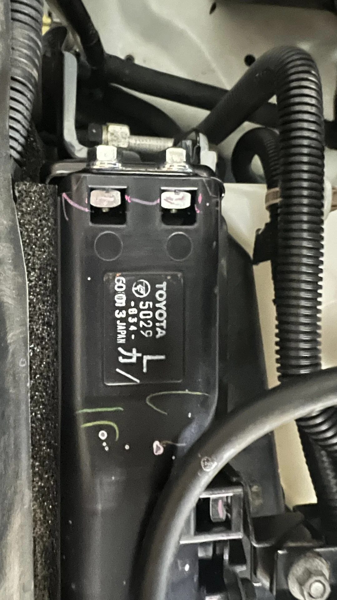

I'd go OEM. The cooling system is so important to the engine you don't want anything to go wrong. I got a replacement OEM to go along with my timing belt change, this week.
since about 2019 or so Toyota also sells a "value priced" radiator for some models at the dealer that is not like the factory radiator. To me it feels exactly like the koyo. I'm not sure if this is what your talking about when you said that the koyo or genuine is the same price. Generally an OEM rad is about twice what a koyo is.

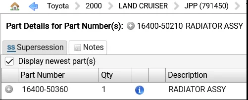

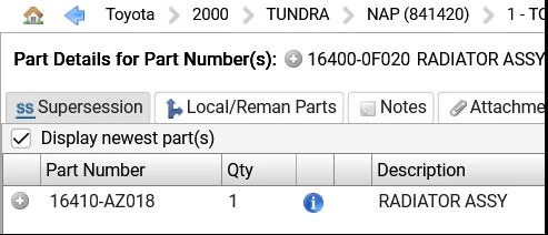

You are correct, Toyota does have a "value priced" radiator- parts number is as follows 16400-AZXXX
However, Landcruisers have a special radiator that is far more robust than the "value line", and Toyota does not offer a AZ option for Landcruiers. As mentioned in past threads, LC's use radiators manufactured under T. Rad
Lets take for Ex;
^This part is a "supersession" part # for a Tundra, which is the "value" part # as you mentioned
Now, the LC radiator part number;
^Notice how there is no "AZ" following the PNC?

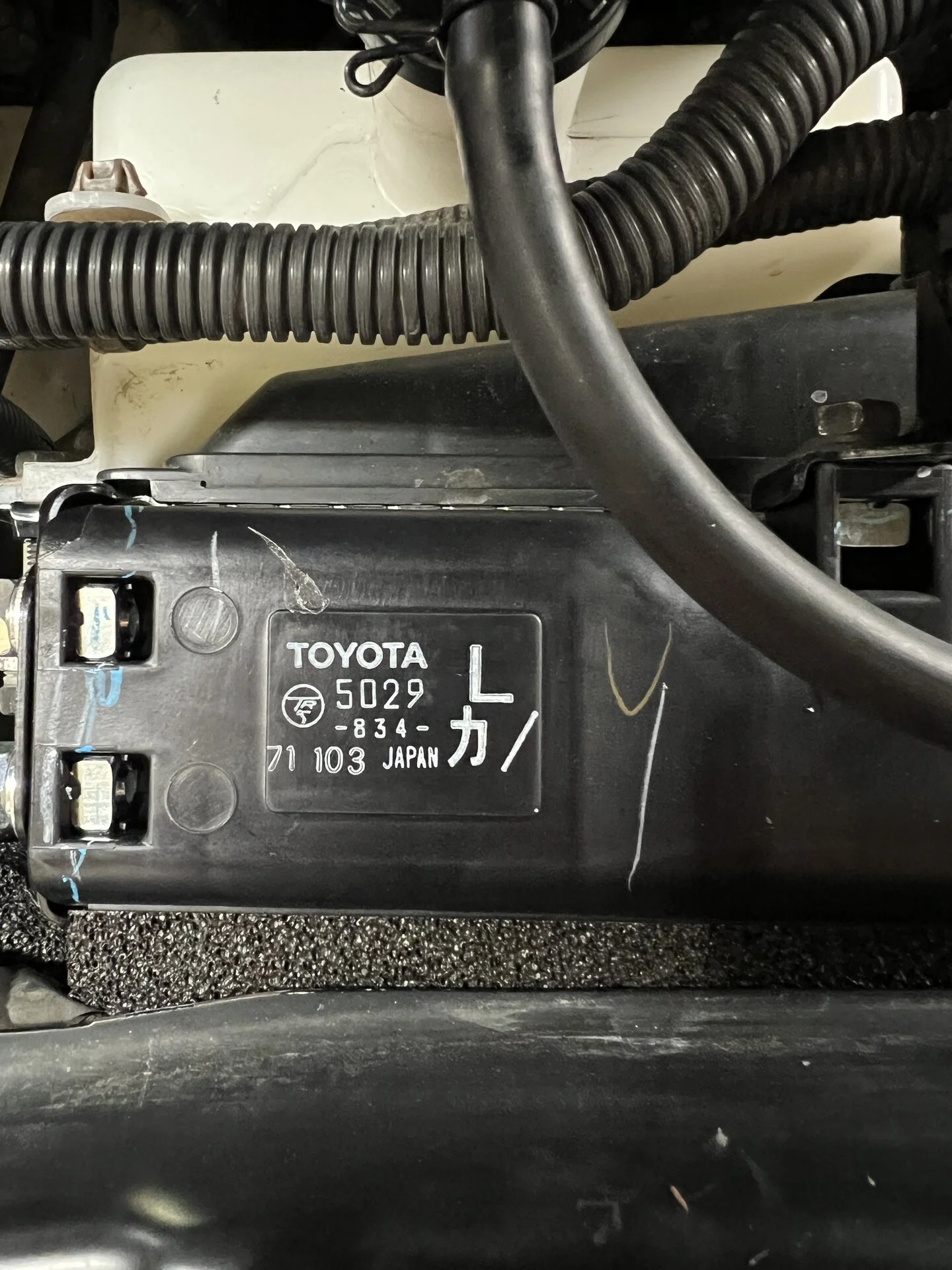

Just curious: Toyota has 2 different part numbers for 2002 and 2004 in my case. CSF has the same 3006 for both. Any insights? Do they fit as well as the original. From my past experience there is always something with the aftermarket, e.g. hose diameter, etc.
