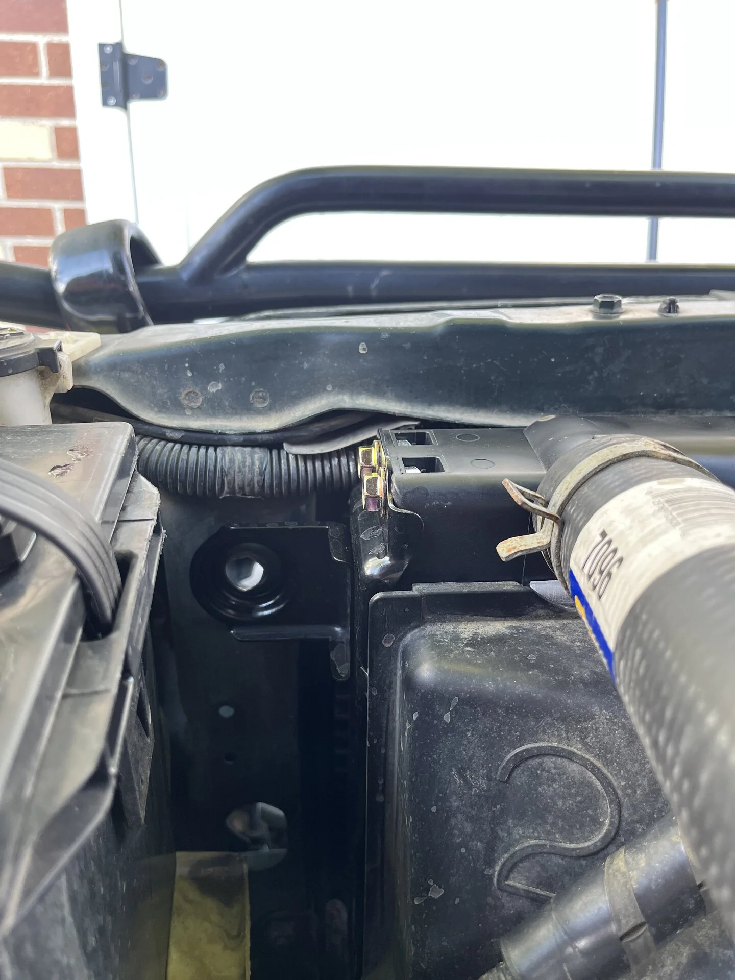

Replaced with Denso 42302. Hoses replaced with Napa parts. The blows keep on coming —when I checked the work at home one of the top bolts holding the radiator in place was never installed! And, the $25.60 radiator cap fee left me with the same cap I went in with!!!!

Each corner of the radiator is mounted on 4 rubber mounts and then a bolt goes through it. Check whether you have those rubber mounts. In the picture I see the mount is missing.

Btw, based on the picture, they reused the hose clamps.. not good.

The ‘kit’ included the two hoses-they even reused my clamps so not even those are fresh.
Correct. I didn’t even get to mention that one to the shop yet…noticed it as well.
Noticed the hose clamps after the fact...but yes, that will be addressed with them too

Make sure to get OEM clamps, they cost a few bucks and last forever, as long as they aren't stretched. Refuse any screw clamp, even if you'll have to provide it yourself. See different sizes for clamps based on position and location, check parsouq using your vin to be sure.
Case closed. Shop manager was glad to hear I didn't blast them on ih8mud, new clamps and radiator cap provided, last bolt installed, bushings inspected, and a decent sized check returned.
