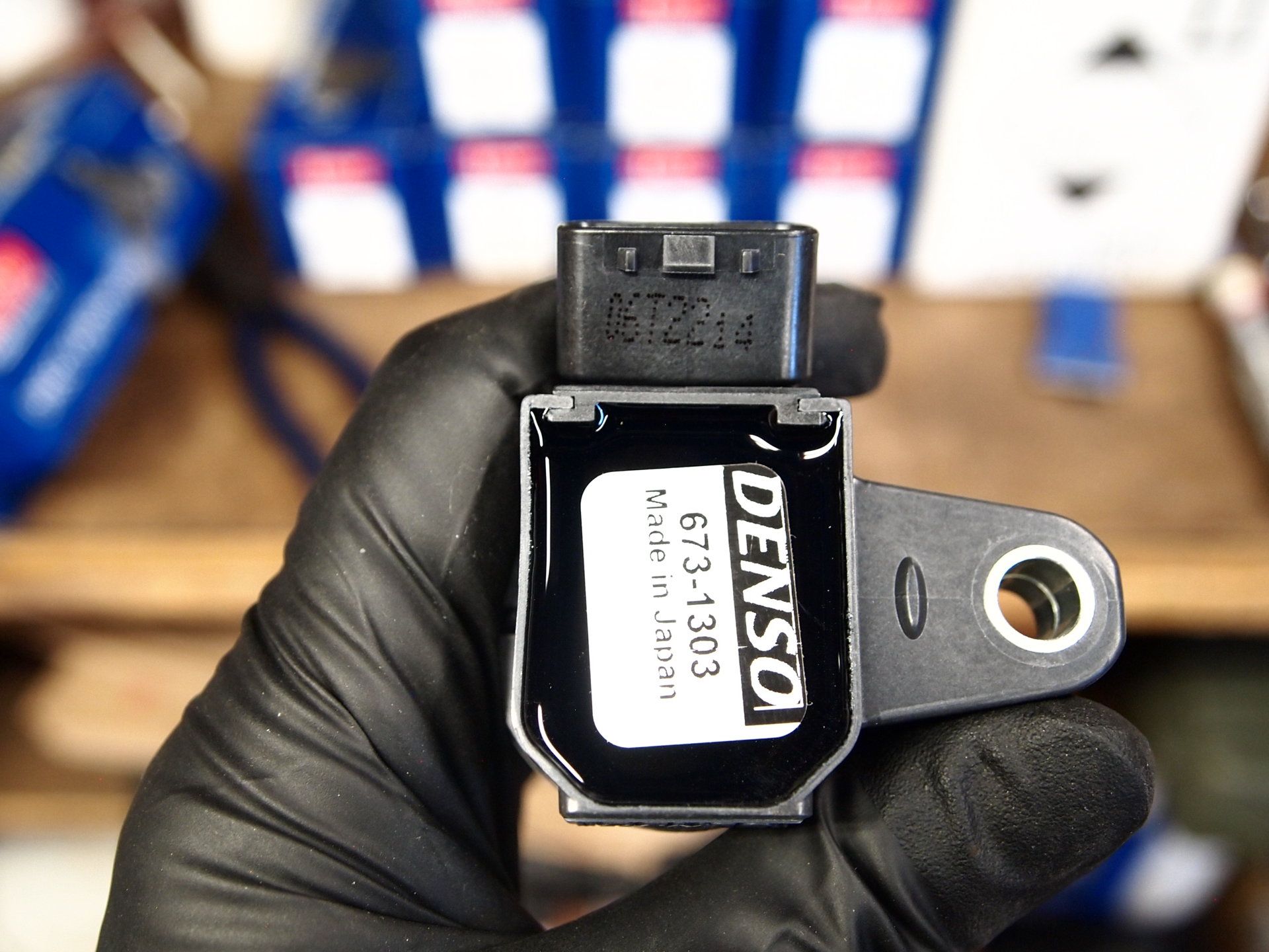

PSA: Denso 673-1303 on sale at JEGS for $50.03. Ordered 8.
673-1303 | JEGS
Ed
Denso uses the same PN # for all the 4.7L 2UZfe to my knowledge. This engine is in 100 series (LC/LX), 4runners, GX470, Tundra and Sequoia. Why Toyota/Lexus has so many PN #'s on OEM IDK. But I've used these Denso 673-1303 with good results, at least short term (not had very long). They appear legit.

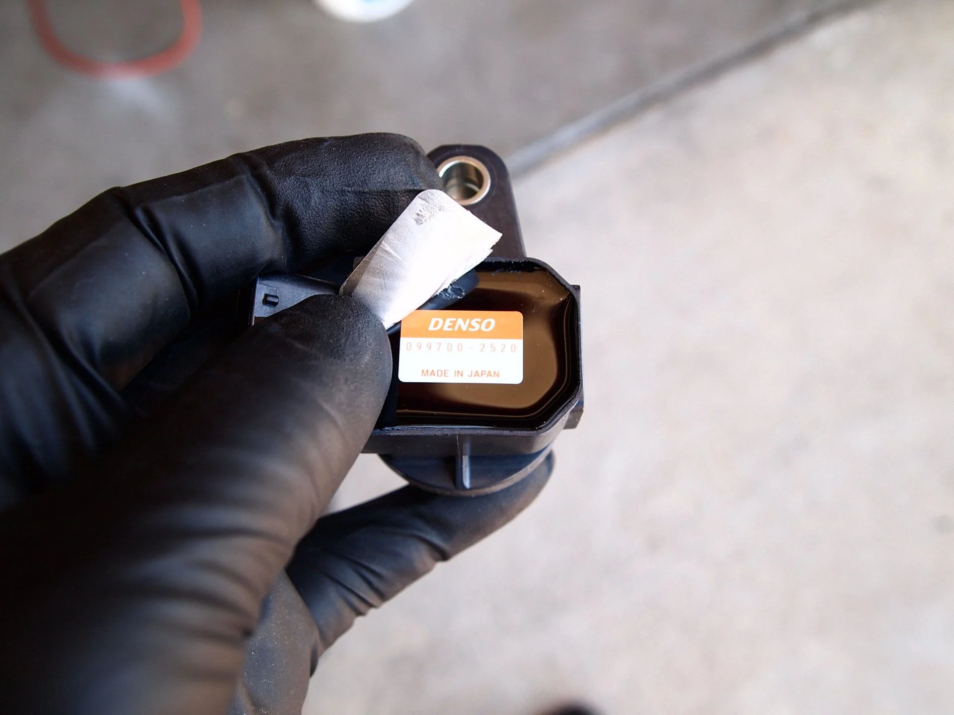

They appear to have Toyota wording ground off.
Also the 673-1303 sticker peals off the top, revealing another PN #. Or at least in set I got June 2018.
The hidden sticker seems to be fixed more permanently than the cover sticker. I've ask Jegs about this, and they said "it comes that way"

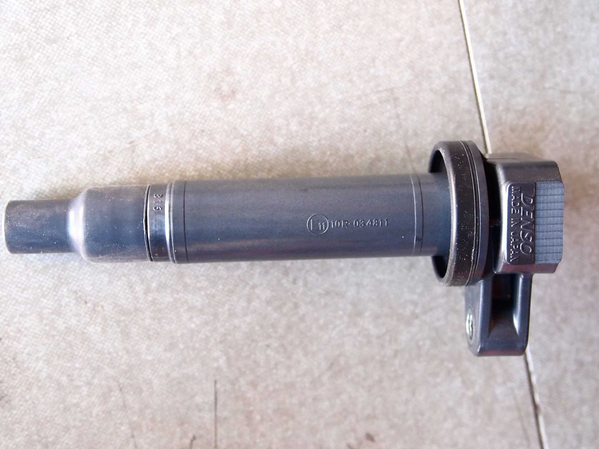

Done installing all OEM coils. Checked the tighteness of spark plugs and all are tight! 2 are kept as spare and rest are still good, only 1 had a crack on the stalk! I am running denso platinum twintip plugs.
