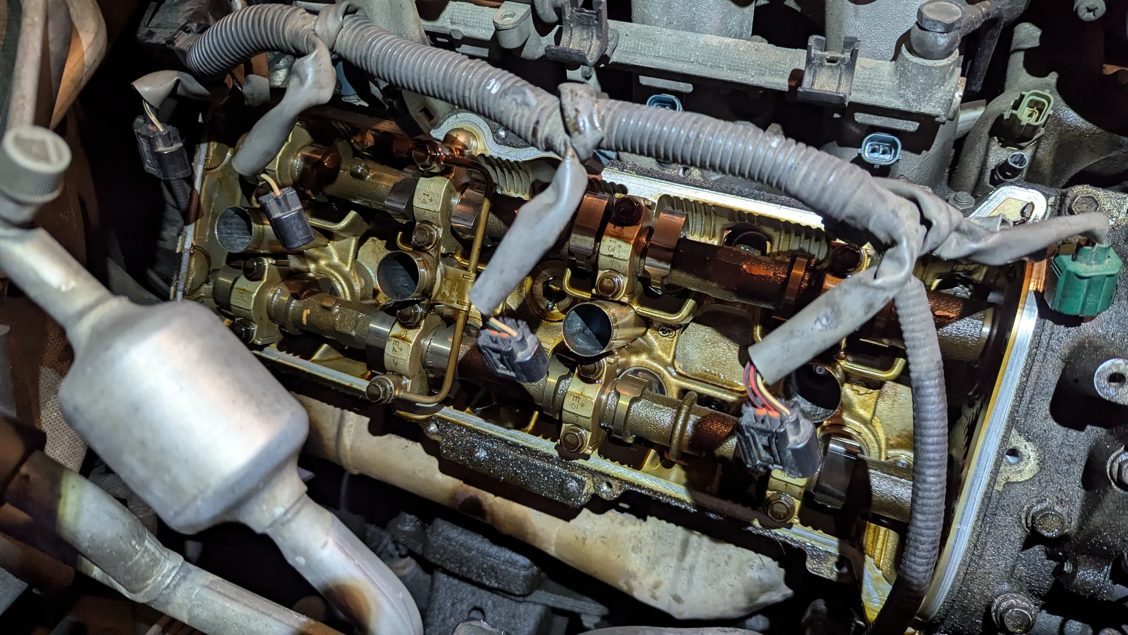

Doing the valve cover gaskets, etc this weekend and have a couple questions. I ALWAYS use OEM, but when I bought my 100-series two years ago, the PO passed along a fel-pro gasket set which includes spark plug tube seals. Worked on the passenger side today and the new spark plug tube seals went in with no issues - too easy in fact. Everything i've seen\read, and my experience with these kind of seals on 2-stroke engines is that they need to be hammered to seat properly. The fel-pro went in by just pressing very firmly with my fingers. Has anyone else used these seals and can comment on their longevity or ability to seal properly?
Second question is spark plugs. When then were last changed, someone used anti-seize. I know the consensus is to install them dry, but i'm wondering if I need to try and get any of the old anti-seize out of the threads. I've already installed and torqued down new plugs (Denso IK20TT).

The tube seals have tabs that get pried up to remove the old. The new fit in and you hammer the tabs back down.
Cleaning the spark plug threads is probably wise. But since you are that far along… what did you torque the plugs to?

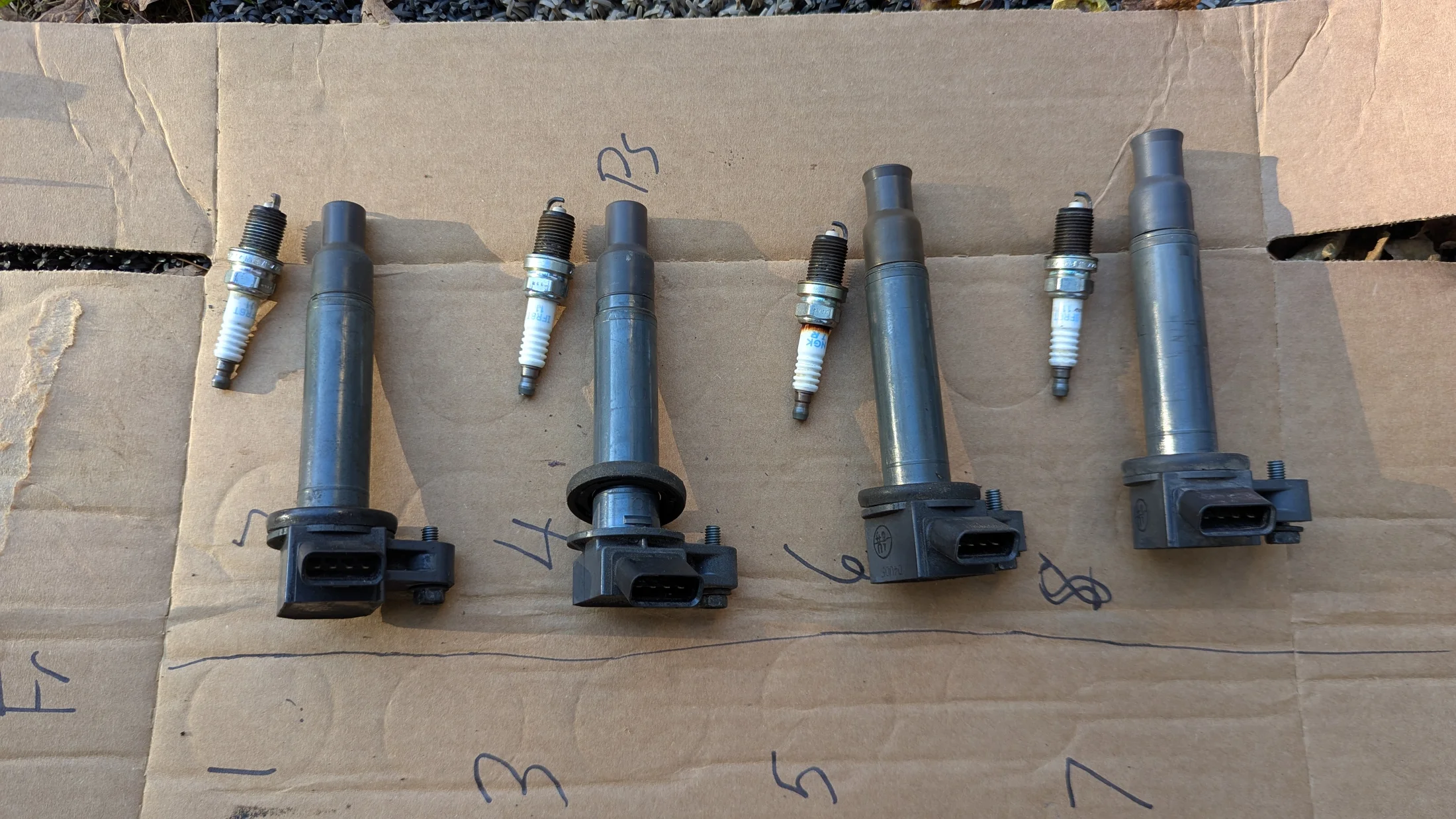

Spark plug seal (metal crush washers), are on new spark plugs. If we remove sparks plug to inspect and clean. We can reuse plug, but its "crush washer" has already been crushed. So they not seal as well second time. But will be good enough.
Spark plug tube seal. Can be seen when, coil removed. We see it between head cover and spark plug tube. These are only replaceable, when head cover removed. Which I rarely, remove head cover to replaces its gasket/seal. I re-torque head cover bolt to 54INCH-lbf, instead. One day re-torque, will not work. But until that day, I just re-torque. So far only head cover gaskets and tube seals, I've removed & replaced (R&R). Are those someone R&R before I touch vehicle, doing a poor job so they leak. Most of those were non OEM seals.
Coil seal(s) are on top of coil. Which I replace often. They seal gap between top of coil and head cover, with boot on bottom of coil that fits over spark plug as coil installed. The top seal, keeps dust/sand & water out of spark plug tubes. We replace this seal and boot, when we replace spark plugs, if needed. Which if more than 10 years old, they usually do need R&R
