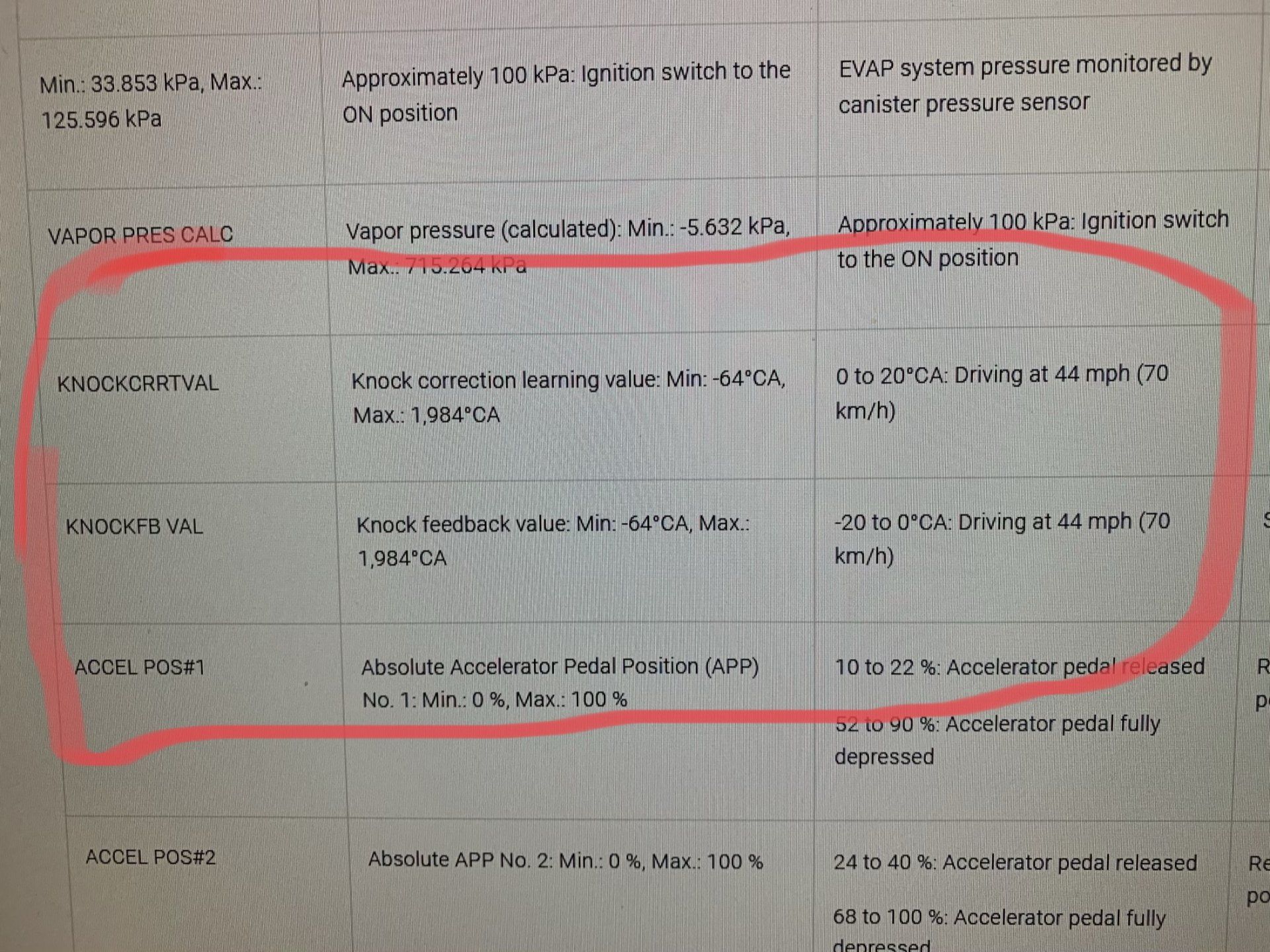

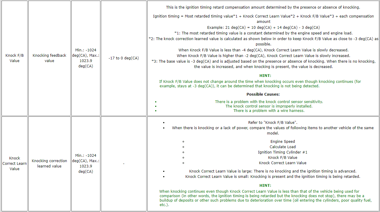

Can you possibly explain to us how knock sensors PID values Knock Correction Learning Value and Knock Feedback Value work together in relation to timing advance?
What exactly is IAM (ignition advance mapping) in relation to above and base timing table?
Also does engine type truly matter as same standard PIDs are used across all engine sizes, types and manufactures, only algorithms may vary?
On the knock feedback value, as I read someplace -1.41 to -2.82 truly a golden spot and at what RPM? I recall seeing Toyota table with note to measure KFV at 44mph, does it make sense?

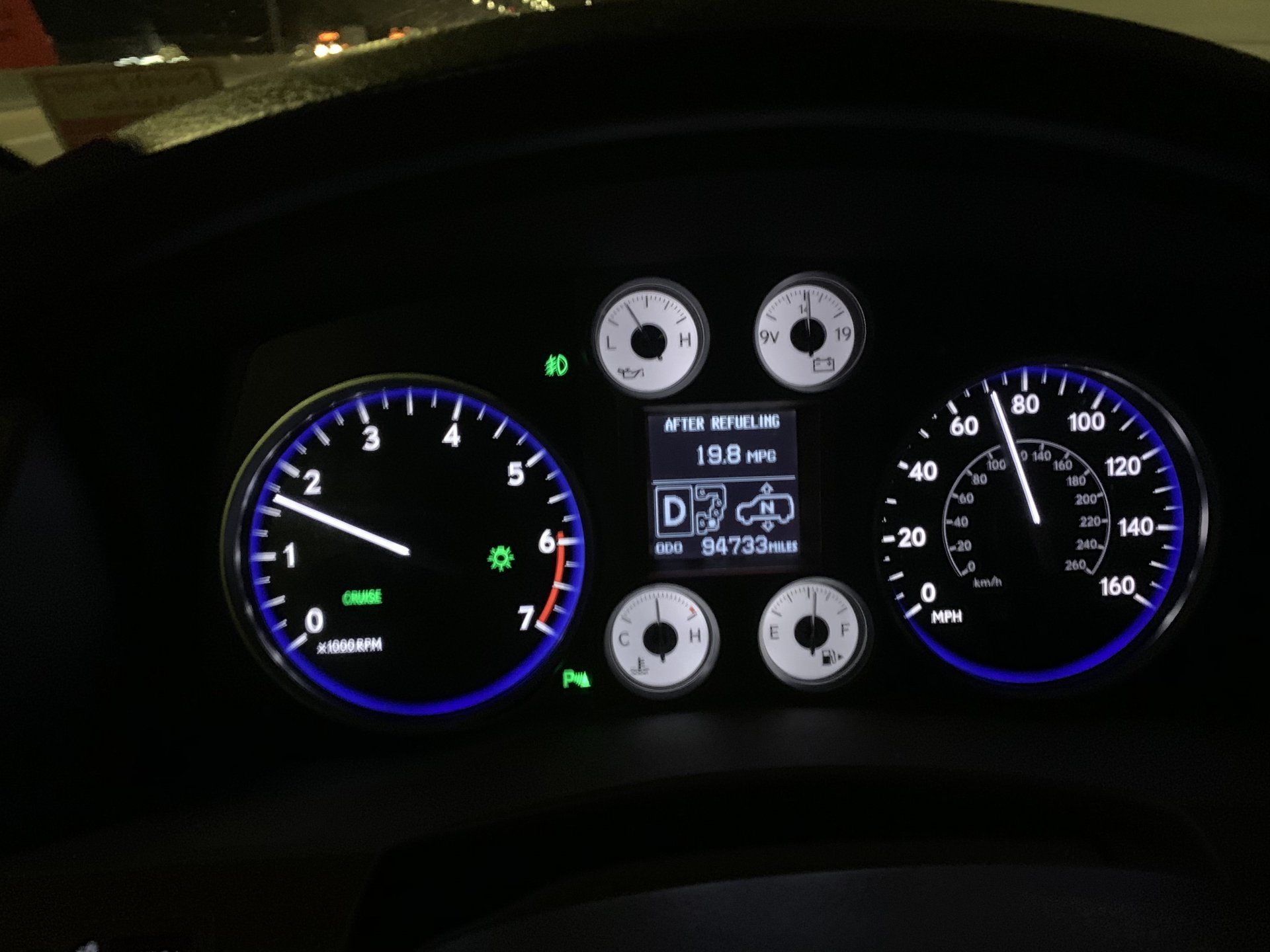

Mine KFV, as you could see in the original post was stuck at -3 using Regular 87 octane from BP. I filled my tank up with 10 gal of Premium 93 at Sams and saw KFV change to -2.8 at least temporarily?
The reason Im asking as long term 87 octane user is that my car 2010 LX570 truly likes 93 Premium in relation to fuel economy but it is not the same for everybody, it can not be just my light foot trained on my wife’s Avalon Hybrid?
See photos, the 19.8mpg was during 100 mile long higway run. I saw mpg numbers climb all the way up and stabilize at 19.7 -19.8 mpg for the last 40 miles or so, 20 mpg was after exiting the highway, I slowed down to 40mph.
Many tuners advice that it may take couple of tanks full for the ECU to learn and tune to proper table while switching from regular to premium. I did not observe that that is why I started with real time (in motion) monitoring.
I know logging data could be helpful but I did not figure out that part of my monitor as of yet.
I do honestly apologize if my questions sound dumb or do not make sense, feel free to correct me. Im a computer systems engineer by trade but my experience is mostly networking. I’m also an USCG Master Capitan with experience in the field of marine electronics so I understand the fly by wire, NMEA2000 networking (CAN bus), PID based digital switching and most of that OBDII maze of sensors and outputs but tuning is just a pure math to me.
This is from the Lexus IS which I've spent much more time with in tuning back in the day. It should largely carry over in concepts. Some of the magic numbers and thresholds may be similar or different however as it's a different motor.
There's large and many tables, equations, and parameters including sensor feedback used by ECUs for which specific timing advance may be computed. It would be hard to say for the specific Toyota implementation, and it's not going to be a singular value, rather it's interpolated across a table that the ECU may build. It should be highly correlated with the KCLV.
There are some standards for PIDs and they generally stay the same within manufacturers. Across manufacturers, there are similar PIDs, but there are also brand specific PIDS. Algorithms and strategies, and tuning philosophies can hugely differ across manufacturers. Within brand and generational models, they generally share similar architectural constructs.
I can't vouch for specific numbers without contextual information and established margins. Only to say less is generally better. Specific numbers may help characterize the overall bias or trend.
The ECU is seeing a beneficial change with less detected knock and therefore is able to run without as much retarded timing. It is worth repeating that it is indeed detecting knock with 87 and having to retard more. Whether that exceeds a safe threshold is unknown but the manual does caution us.

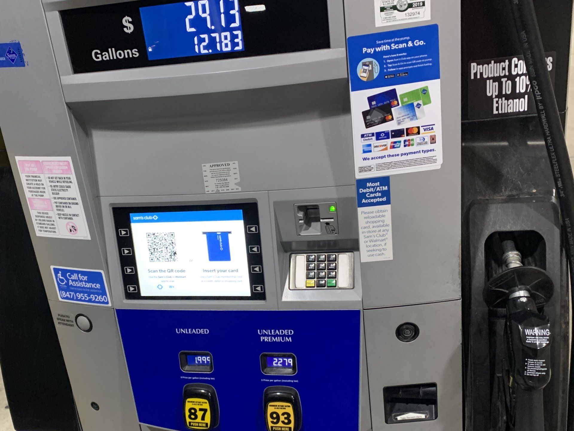

Great appreciation for giving us the answers. On the Christmas Day, Thank You!
I’m truly a long term user of 87 octane Regular gas with no major issues, also while towing. I never truly considered Premium as in IL you pay huge premium for it. Recently I discovered freshly built gas station which offers 93 at reasonable price. I thought maybe I should reconsider, see photo
Yes, I could justify 28 cents but wanted to be certain I do actually get something for it. Looks like I do and big test would come when I put my boat back in tow. It is on the rack for the winter but I’m already gearing up for the test. My 2010 LX generally does worse mpg wise with boat in tow than my 2001 LX 470 did.
Unfortunately Ethanol Free gas is almost impossible to get around here and Im not driving to WI just to fill up.
I do understand manufacturer specific PIDs (custom PID) and Im using such with my OBDLink device to get transmission temp etc but my point was that they are the same across all the motors in Toyota lineup so small 1.1 or large 5.7 does not truly matter as someone suggested - engine alone is not very smart but in combination with ECU it learns and stores data as advanced as our personal driving characteristics and uses above data as it is designed to do so. ECU engine control unit is a computer capable of doing so and Toyota is never at the helm of latest technology (could be a good thing) but I would imagine Tesla ECU can be taken over from the sky thru satellite by factory techs because why not. On Star, Lexus Enform - you name it.
Yes, I could justify 28 cents but wanted to be certain I do actually get something for it. Looks like I do and big test would come when I put my boat back in tow. It is on the rack for the winter but I’m already gearing up for the test. My 2010 LX generally did worse mpg wise with boat in tow than my 2001 LX 470 did.
Costco near you? $.50 - $1.00/gallon cheaper
Wait till you try Ethanol free gas-i'm seeing easily 19MPG going 85-90MPH and almost 17MPG in the city.
Ethanol free is the real game changer.
