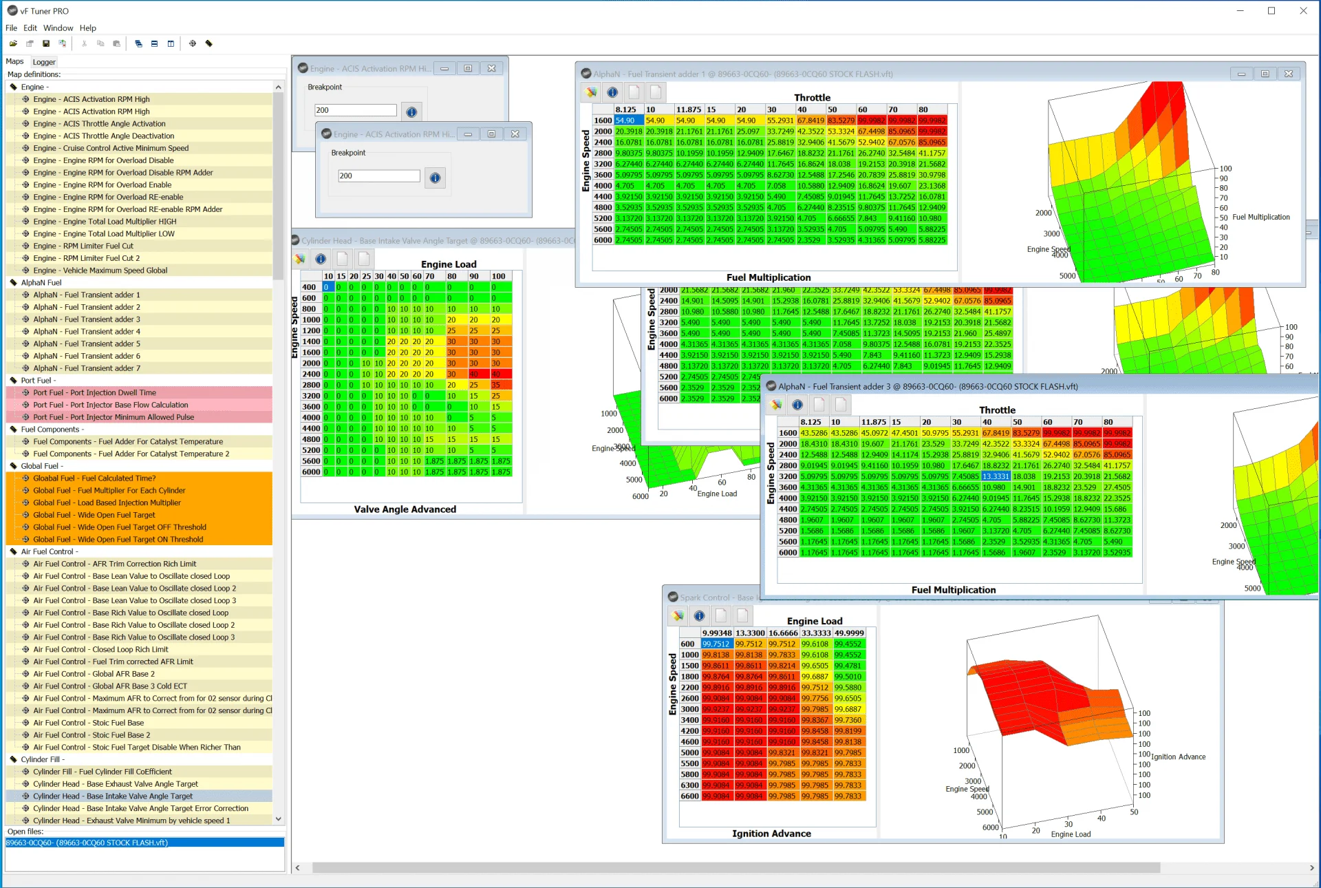

Definitely lots of flexibility within ECU self tuning function, we already talked about Low Octane Table and High Octane Table, someone else confirmed existance of factory Regular Gas and Premium Gas tune with OrangeVirus Tuning. From my own reading - there is even table for Knock sensors sensitivity which filters knock response relative to background noise.
Attached screenshot from VFTuner should give us general idea of what is out there, and note it only shows partial scroll on the left.

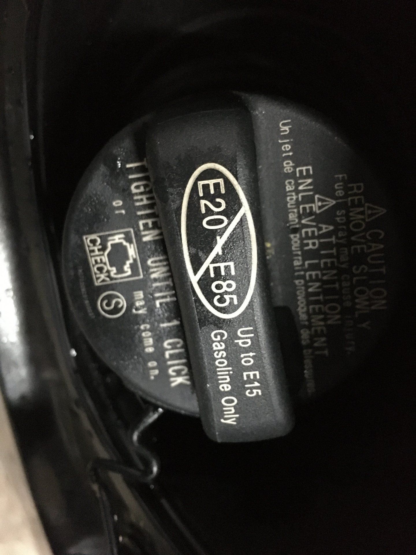

New land cruisers fuel cap says E15 is fine but no E20/E85 ethanol is 114 Octane rated . I know guys that love blending fuels with Alcohols thats what the big oil love ethanol , most fuel suppliers start with same Blend Stock of gas around 84/85 percent real gas and just adjust mixture from there , N-Butane , Alkylate ,Benzene , Toluene , Xylene , MTBE , Ethanol .
All can be uses to adjust fuel octane ratings ... More Ethanol higher octane .
Fuel is crap these days , you can’t trust any of them , your best buying non ethanol fuel , near me its 30 cents more than high test .
My vehicles that don’t get used on a regular basis I put E-0 thats ATVs ,bikes , mowers , blowers , trucks .
My beater daily drivers I use the name brand cheapest with a additive .
Here is a pick of a 2019 fuel cap , I don’t think Toyota changed any internals to for the high ethanol blend .
