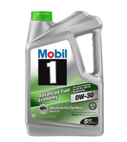

It's oil change time again.
With summer coming and planning for some long towing road trips through hot summer months, I'm stepping up the oil viscosity for my vehicle.
For those that tow heavy or are built especially heavy, this would apply. Nothing is like motoring up a long 7% grade with over 14,000 lbs GCWR. Where the average engine output is easily over 60-80% for extended periods. Hotter peak running temps is no surprise.
Optimal engine oil is a balance. OEMs have to walk the balance between efficiency and protection. A primary variable for viscosity is prevailing operating temperature. Summer and heavy use sways me to use thicker grade oil for more protection.
1970907
From the manual:
"An oil with a higher viscosity (one with a higher value) may be better suited if the vehicle is operated at high speeds, or under extreme load conditions"
Efficiency pressures has been driving the average viscosity down in modern cars. For severe duty use, I'm prioritizing protection and will run 0W-30.

Obviously lots of opinions here. Often times, oils and fluids are like religion. I'm not attempting to indoctrinate anyone into mine. Just sharing what I personally am doing based on my interpretation and analysis. I have plenty of 5W-50 in my garage for my turbo, yet what's good for that car, isn't good for others.
There's many many parameters in oils. It's not by chance that the most important numbers are up front and center - viscosity. Viscosity is highly correlated to temperature. Everything else "flows" from that.
0W-20 is OEM spec'd oil. Which is the right viscosity for the nominal weather and operating conditions expected.
Most know this but the 0W is cold starting viscosity. I'm not appreciably changing this so cold protection and ease of starting will generally be the same.
I'm looking for increased hot temperature viscosity in going from -20 to -30. Said another way, I'm looking to maintain equivalent protecting viscosity at higher than normal operating temperatures.
It's not hard to understand that with hot climates and continuous higher than average power outputs, that oil will be subjected to higher operating temperatures. Oil thins at higher temperatures. That directly impacts its shear resistance and protection abilities for proper lubricant film strength when I need it most.
I'll be the first to say this isn't suggested for the typical user that drives an unladen vehicle.
So... “fluids are like religion.” Yep, and you’re showing us you are only looking at the viscosity at 100°C cSt.
AFE 0-30 isn’t even ACEA A5/B5, it’s just a A1/B1, which is more prone to shear down to a thick 20 weight. Being a 0-30, and not having a naturally higher V.I., more viscosity improvers has to be added to achieve the viscosity swing, which makes it more prone to sheering at high temps. So while a 30 weight will, on paper, do what you want, the fuel economy focused 0w-30 isn’t the best choice at Walmart. But...
None of this matters!
Anyone can run a conventional 5w-20 SN, tow to max capacity and that motor will last just as long someone running some super expensive group IV/V based oil.
If you really want to protect your motor, have the oil analyzed, and change it before it is depleted of TBN. Simple as that people. Don’t think you need to do this.
But whatever helps you sleep at night, because AFE 0-30 is a pretty good oil. Just like TGMO, or Amsoil, or Pennzoil, or RedLine, or Castrol in 20, 30, 40 weights. As long as the oil meets specs, then it’s NEVER going to be the reason why a motor wears. Not changing oils when they need to be, that is what gets people.
@TeCKis300 your still my boy, I just think you should of gone with EP 5w-30 if you wanted “better” sheer resistance. AFE 0w-30, man... should of looked at a ACEA A5/B5 20 weight. Ugh... what am I saying? This still doesn’t matter. This is why oil threads suck.
I totally get what the OP is going for and I think the same way but I think this point by Taco is key. It is my understanding that the wider the viscosity range, the more susceptible it is to shear. So if you were running an 0w-20 before, the 0w-30 may offer even LESS protection from shear under extended, extreme loads.

Firstly, I'm not seeking M1 0W-30 for its marketed "advanced fuel economy" benefits. This is relative to typical 5w-30 oil that its marketed towards. Replacing 0W-20 oil with this more than certainly will have the opposite effect.
Oil protects in many ways. Including dynamic viscosity, shear resistance, barrier additives, etc. They rely on different properties of oil for various protective qualities. In the never ending chase for efficiency, OEMs have needed to get creative to reduce viscosity, yet keep equal levels of protection.
I maintain that viscosity, is still the critical fluid property and primary method of protection. Because higher heat loads always results in thinner viscosity and reduced protection.
Some of the interpretations above in regards to higher grade base oils, higher VIs, IMO is flawed. One has to remember 0w-20 is fundamentally thinner oil. It has to continue to offer protection - DESPITE being thinner oil. Therefore needs a higher VI rating to maintain HTHS performance for example. It also has to have generally higher threshold qualities to meet more stringent certifications, again to make-up for the fact that it's ultimately a thinner viscosity oil. Some of the points also pertain more to longer service intervals. That's not my goal.
Fact is 0W-30 (versus 0W-20) is going to generally have a higher viscosity @100*C. More importantly, it's also going to have a higher rated HTHS viscosity. That's what I'm looking for.
I could just as easily choose a very high grade of 0W-20 oil for the expanded protection. As I live in a hot climate area (likely to see 110*F+ towing in the summer) for the duration of my next service interval, 0W-30 is my personal choice.
