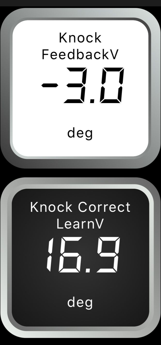

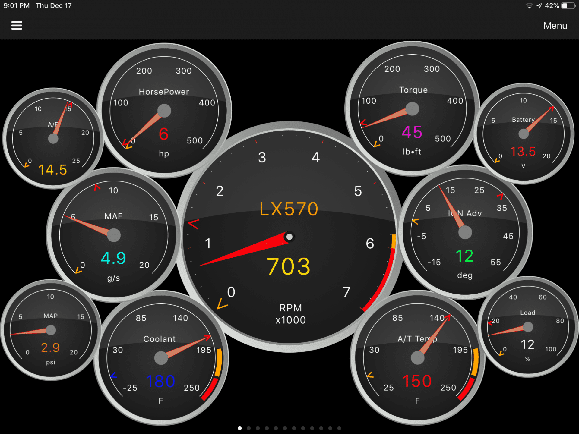

I read many informative posts on this site, some scientific and some speculative but truly nothing very conclusive. Even emails to Toyota drew little assurance. I historically ran Regular gas in my LX with great results even while towing. I recently found a very good source of 93 Premium as local Sams Club opened up gas station. They only offer 2 grades of gas Regular 87 for $1.995 and Premium 93 for $2.279, well that made me think, why not. With very little tuning experience I geared up with real time OBD2 device and programmed some custom gauges and gave it a go.
Hopefully we could get some experienced tuners involved in this conversation.
Couple of conclusions from prior posts were that all 200 Series cars run well on regular gas. Slight improvement in mpg is so minimal that it does not justify higher cost of Premium. Another one is that both Toyota and Lexus use the same engine configuration and the same engine ECU - it is the same part number and likely same programing for LC (requires Regular 87) and LX (requires Premium 91) Lexus tech specs list slightly higher HP (close to nothing) and Torque.
So rather than beat on the dead horse, Toyota truly no help, I did some real time monitoring and on line research and found some valuable information.
My conclusion to date and I could be wrong - it s all in the software. Did not I just say both LC and LX use the same software? Well that is correct. My current conclusion is that our stock 5.7 is fully capable of running both Regular and Premium. What is of importance is to be consistent with what you put in your tank and not to switch back and forth between grades often as by doing so you would give your ECU a rather hard time figuring out which tune to use.
Well I just gave out the answer. My research and testing leads me to believe, that a ECU stores multiple tuning tables. Looks like there is a High Octane Table (better performance with more advanced timing) and Low Octane Table. Depending on how sophisticated programming is, there could also be an additional in between hunting table for those who switch between grades often or for situations where you fill up with some bad gas.
So how does it work? Well you decide what grade of gas you put in your tank and that is about all you can do unless you are into custom chips and advanced tuning. ECU software does the rest. It monitors the knock sensor microphone output at various above idle RPM ranges. If it dectects knock it updates real time tables and looks for consistency and reoccurrence in predetermined RPM ranges. Based on the data it collects over time (May take a full tank or 2) it adjusts your knock PID parameters like Knock Correction Learning Value and Knock Feedback Value. It takes time as it looks for consistency and that is where you can help. If you buy SheLL Premium - stick to Shell premium, if you buy BP Regular - stick to BP Regular. I believe it is consistent Knock Feedback Value ECU uses to determine if it should use High Octane or Low Octane Tunning Profile table. 89 Octane could be your worst choice as your ECU could go into constant hunting mode (kind of undecided). If you run 89 mid grade it is likely you are not doing your ECU a favor at all.
I believe the true reason why Lexus manual calls for a Premium 91 Octane is simply the luxury aspect of the brand and they want us to have better overall experience with best possible performance, hence they want us to use High Octane Tuning table.
I believe If you own a LandCruiser you would accomplish same results and performance gains benefits with Premium, most important more timing advance = unquestionably more power. Keep in mind that process takes time - up to 3 tanks full according to some tuners for you to notice (or not) the benefits.

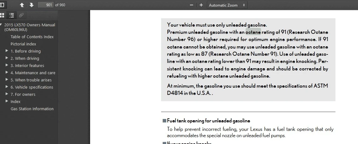

It's great to see that you put a hypothesis to this and logged some data. I'm not going to change your mind here and it's an age old debate because we don't have direct access to Toyota's IP. It's to the individuals prerogative what they believe and do to their own vehicle. But for every person that wants to parrot some internet opinion out there as some end all truth, it's worth hearing maybe the other, more informed side.
As you asked for a professional opinion and you can decide whether mine is worth any pennies. I live in the engineering world and own projects that have tuned piston aircraft motors. In my spare time, I've tuned cars over a couple decades now. Standalone, piggyback, N/A, turbo, diesel.
You're making some huge leaps of assumptions. With data from a single personal vehicle. In nominal conditions. Enough to jump to said conclusion? Let's just say I have my doubts. Even if the LC and LX shared a driveline with the same octane requirements, I would bet there are detail differences in the calibration based on the intended end user alone.
As I said, I tune cars. I have ACN91 (AZ, CA, NV) 91 octane piss grade tune in my Porsche right now. I could flash it in a minute with a 93 octane tune that the rest of the lucky US has access to. Who cares right, and I could just run whichever and let the ECU handle it. It's just 2 octane points. Nevermind the 4 octane points you're talking about. Sure cruising the freeway, I see the timing pulled a bit, it's no big deal right? Let's push the car and run the wrong octane with the wrong tune, the stakes are different and real stuff can and does happen.
Given Lexus manual requirements, I am running 91 only. Particularly as I tow and operate the motor in the higher load tables where pre-ignition is more likely to happen. It couldn't be stated more clearly as a requirement, without any wishy washy words.
Food for thought
- Manuals are not run by the advertising department. Not even close to the same functional group. They surely could advertise without requirements in a manual
- Yes, modern engines have feedback loops. In order for the ECU to pull back timing, it would mean it has experienced knock. Rinse repeat for the lifetime of the motor, how many knock events is that? Hope that knock event wasn't during a high stress point.
- Each event contributes to a high pressure uncontrolled flame front event, potentially adding microscopic stressors and deposits to the combustion chamber. Rinse repeat, what does your motor look like over the life of the engine. Will the engine continue to run well with hot spots from deposits potentially causing reduced knock thresholds, because it ran great on 87 yesterday when I tested it?
- Calibration (i.e. software) is not the same as a hardware part number
- Calibrations are engineering decisions made against margins. Consider what may happen if you have a motor made on Friday, get a batch of bad 87 octane, on the hottest day of the summer, with the whole family in tow, history of hard use, and perhaps engine wear from the previous owner that also ran 87 because of your post.

Displayed knock feedback and learn values is the most actual evidence we’ve seen yet of different “calibrations” that the ecu has to respond to the environment provided by the fuel.
OP’s hypothesis is pretty solid and by far the most thorough explanation I’ve seen yet of the what and why of octane in our vehicles. Thanks for posting.

While this is a useful perspective for an LC owner, the analogy for an LX owner may not be the same.
For an LX owner, it may not be only a question of more or less power. By going to an octane below the base table, which would be the safe assumption from what the manual tells us, you'll not only loose power and performance - you may loose some margin of safety. That's what the data you've collected could be telling you as the ECU is obviously seeing more knock and and pulling timing with lower grade fuel.
IIRC from other Lexus and Toyota, most KLTV values after a reset should be 15. Healthy engine numbers fed specified or better fuel should see KLTV numbers after some learning cycles in the 18+. I've seen healthy examples from performance models in the 20++. A KLTV of 16.9 tells me that it's not exactly a healthy motor or perhaps bad or lower octane than necessary fuel. That's speculation however based on other models as we'd need to profile them for the 200-series.
It would be interesting if an LC owner could do the same experiment. With enough examples, we could understand what's expected and may actually be able to draw some safe conclusions. Until then, the manual is what we've got.

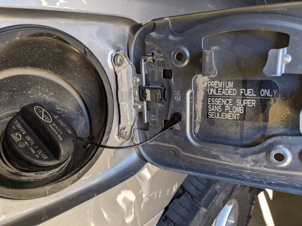

How are you losing a margin of safety if the fuel mapping is identical between the vehicles?
How are you making such a conjecture when the manual and available media tells us otherwise? I'll be happy to concede if we learn otherwise. Until then, there is only one safe position which is not to make any assumptions.
As I said, many other models have variations in calibration for fuel. It's pervasively done in the industry.
Since Subaru and Toyota were brought up - we know the BRZ/FRS/GT86 are sister cars that share exactly the same driveline. They even require the same 91 octane. Yet we know the calibrations are completely different as it's been widely published that each parent company takes ownership to tune based on their philosophies (perhaps reliability) and vehicle character. Same with the sister Supra and Z4.
It's very likely the LC and LX are calibrated differently for not only octane, but for feel. We know the Tundra surely is calibrated differently for it's truck character and it shared 99% of the the driveline.
So based on what are you so sure that you presume them to be identical?
The LC and LX are not identical. We can't see software, but this detail is an affirmative difference - this LX labeling sure is not mincing or using verbiage that allows any debate here. They probably even anticipated hence adding the word "only".
