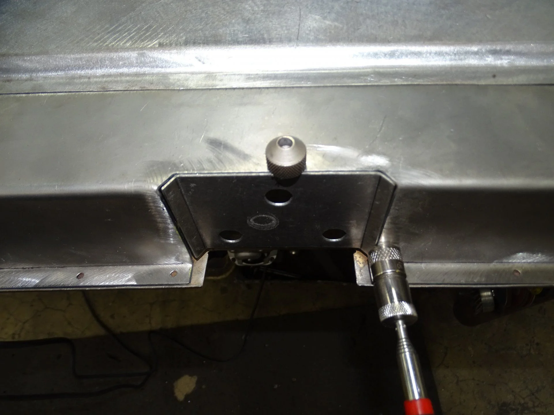

I would be interested in the tailgate hinge bracket assembly (2) that you have pictured above. It would save me a ton of time when I get to that section on my LV. I'm sure @KT40 would say "yes" to that as well. The tailgate sill is a universal problem on these LVs.
PM me know if you are interested in making a few more sets of those brackets.

To all that are interested, I am willing to make some of that tail gate hinge pockets. $$ comes into play here so let me figure out how much they would end up being for you!
Justin

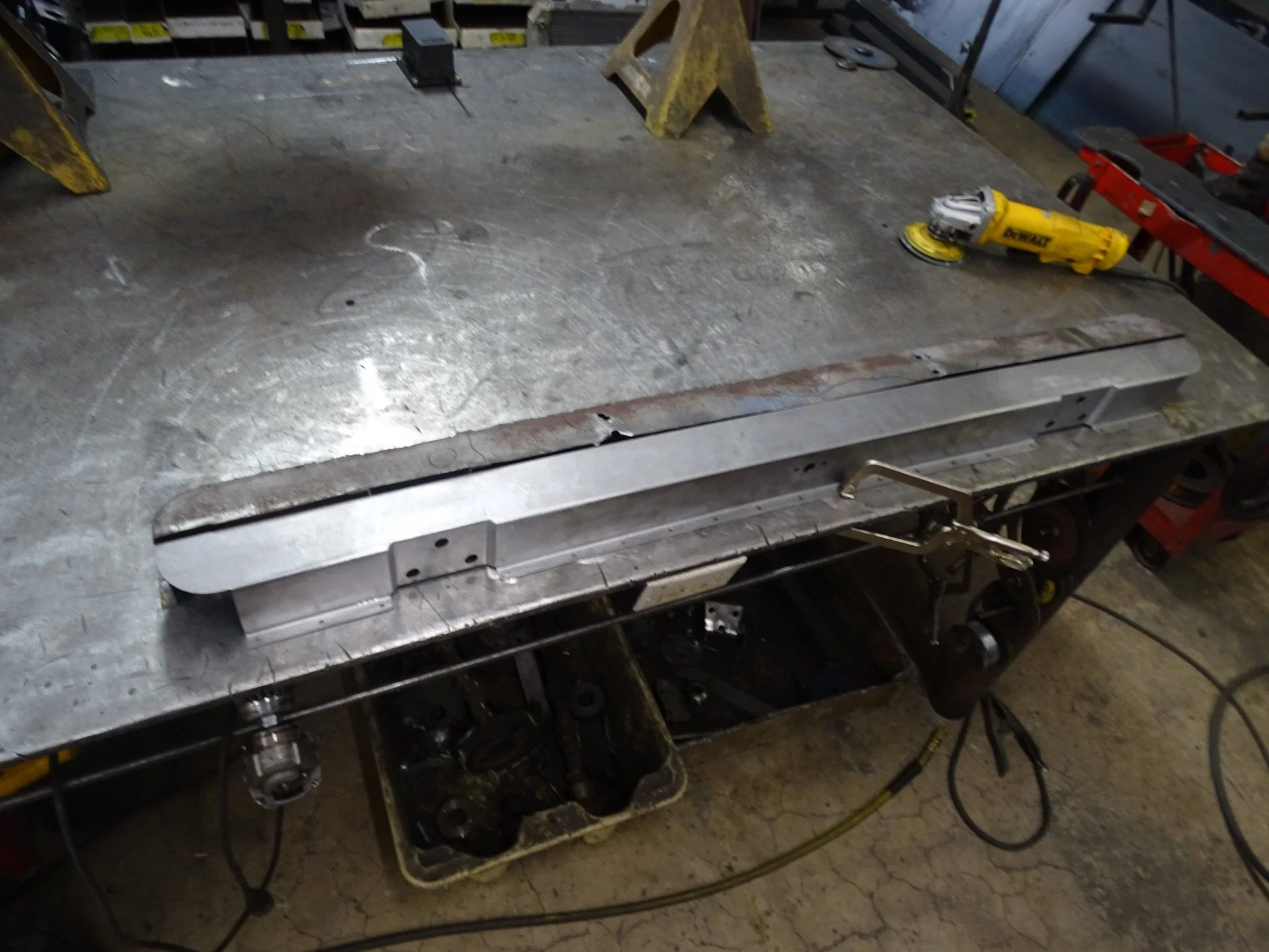

LV Tailgate rust repair
Lower pieces are starting to get fitted!

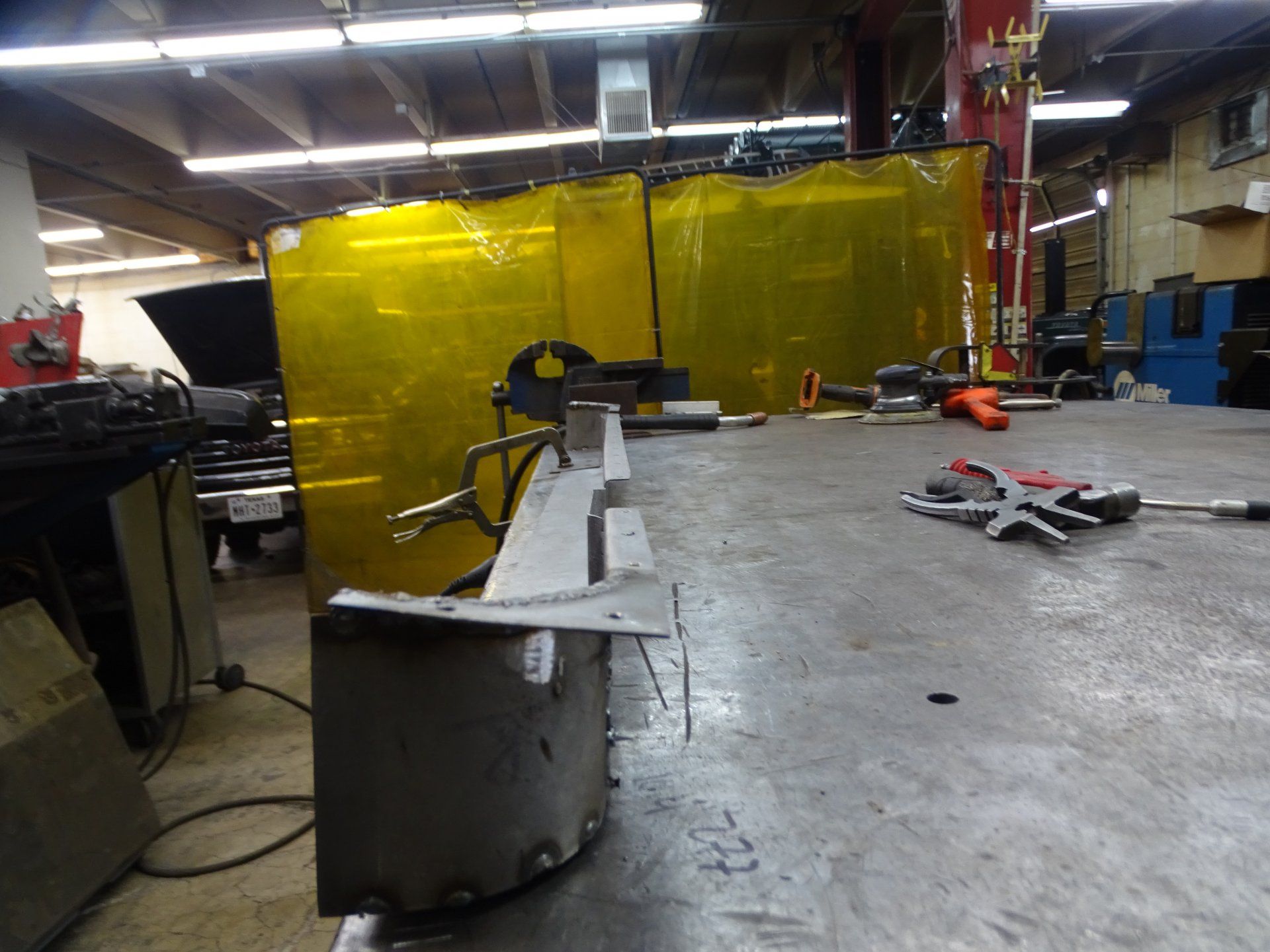

There goes a half of a day. Tack welded with low heat and finished with 80-120 grit. Top 2 pics are the left side and the bottom are the right side.

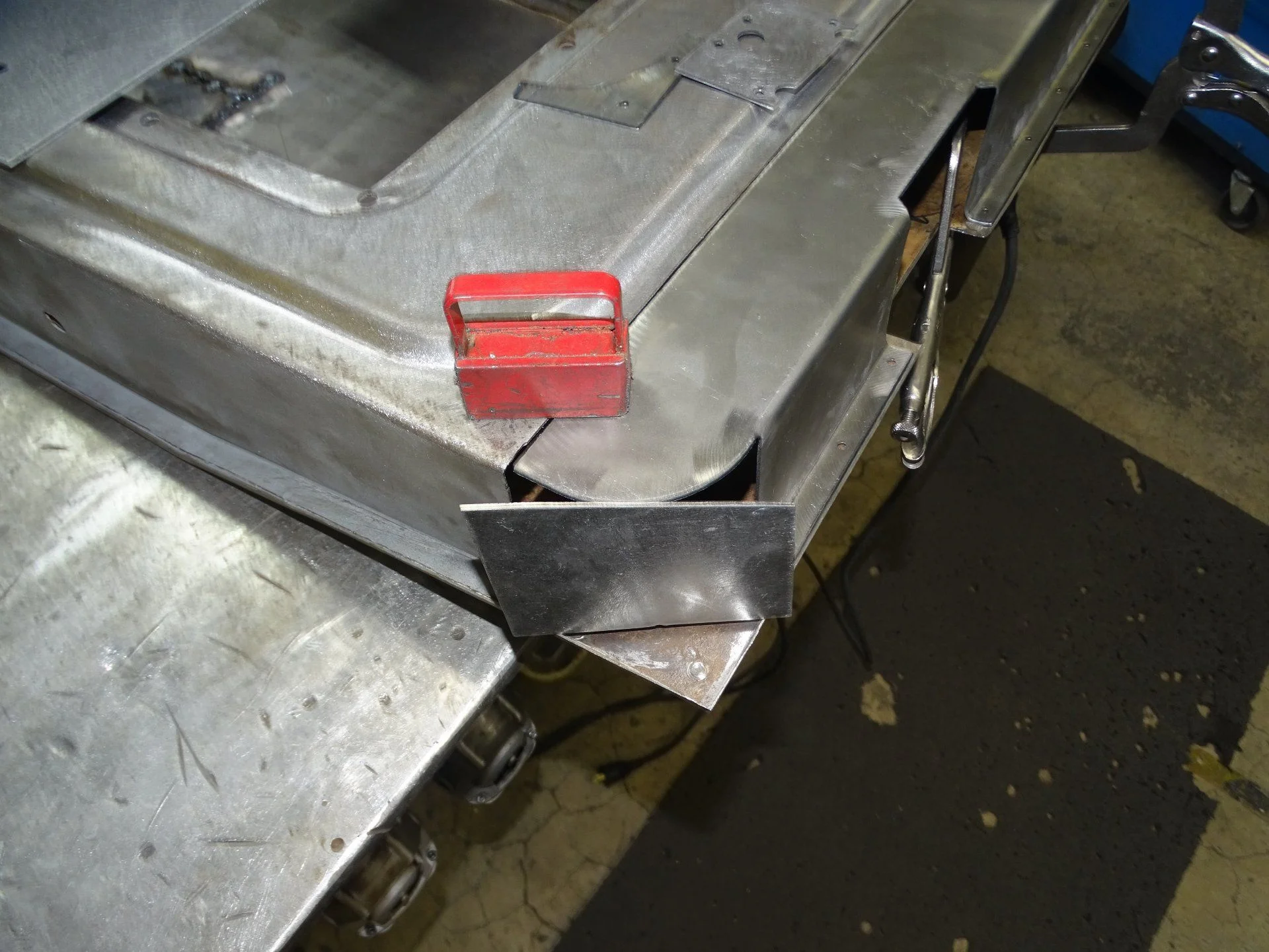

Rebuilding the corners now. A very tedious section

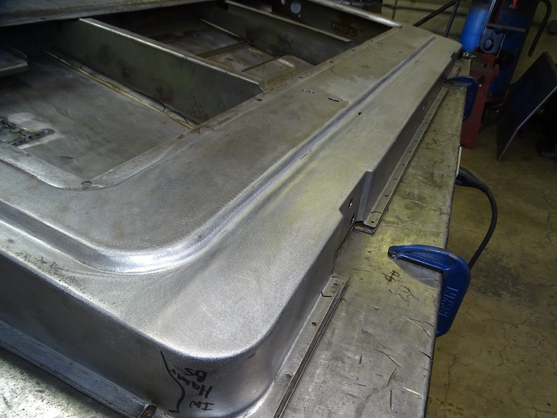

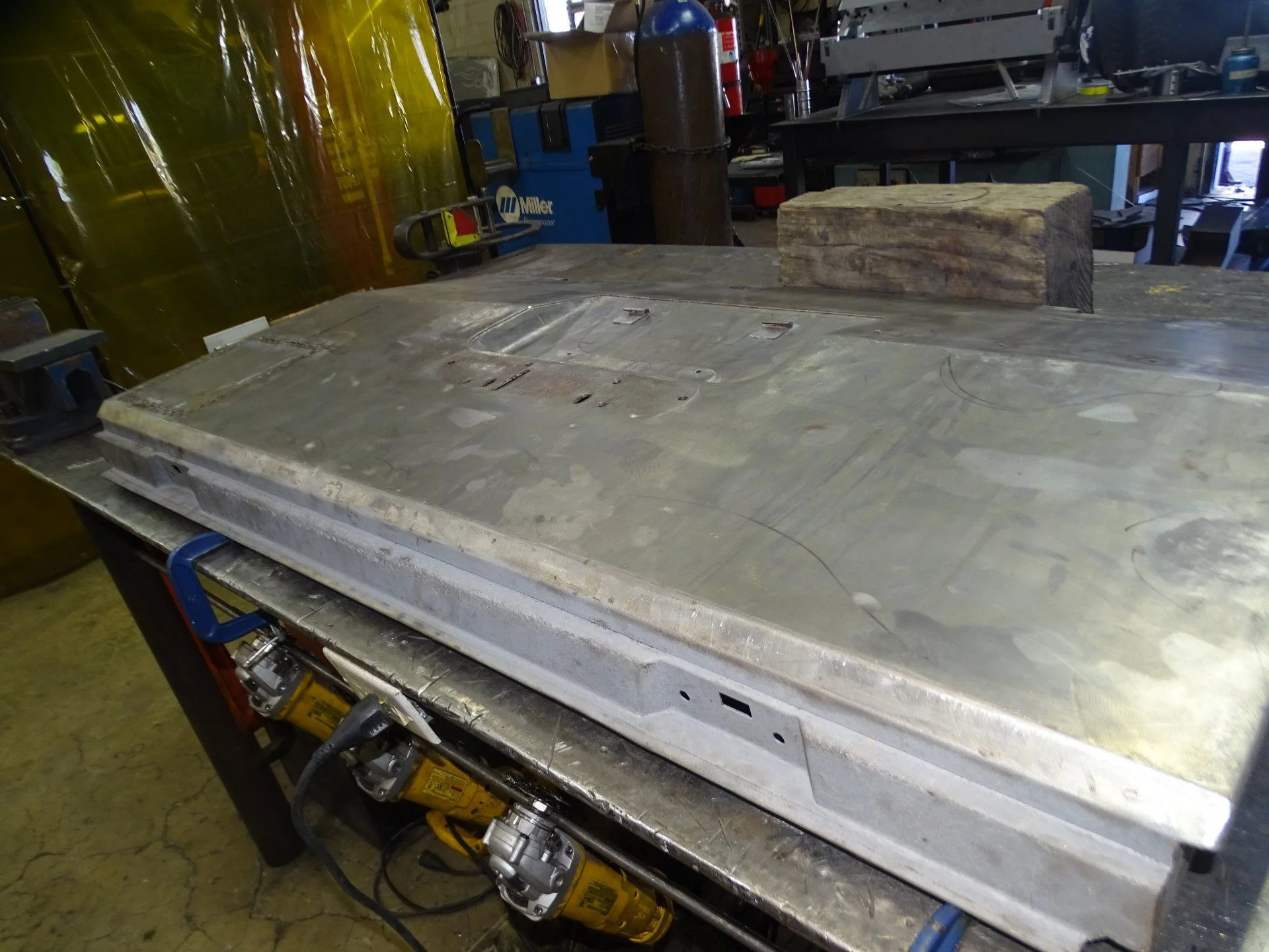

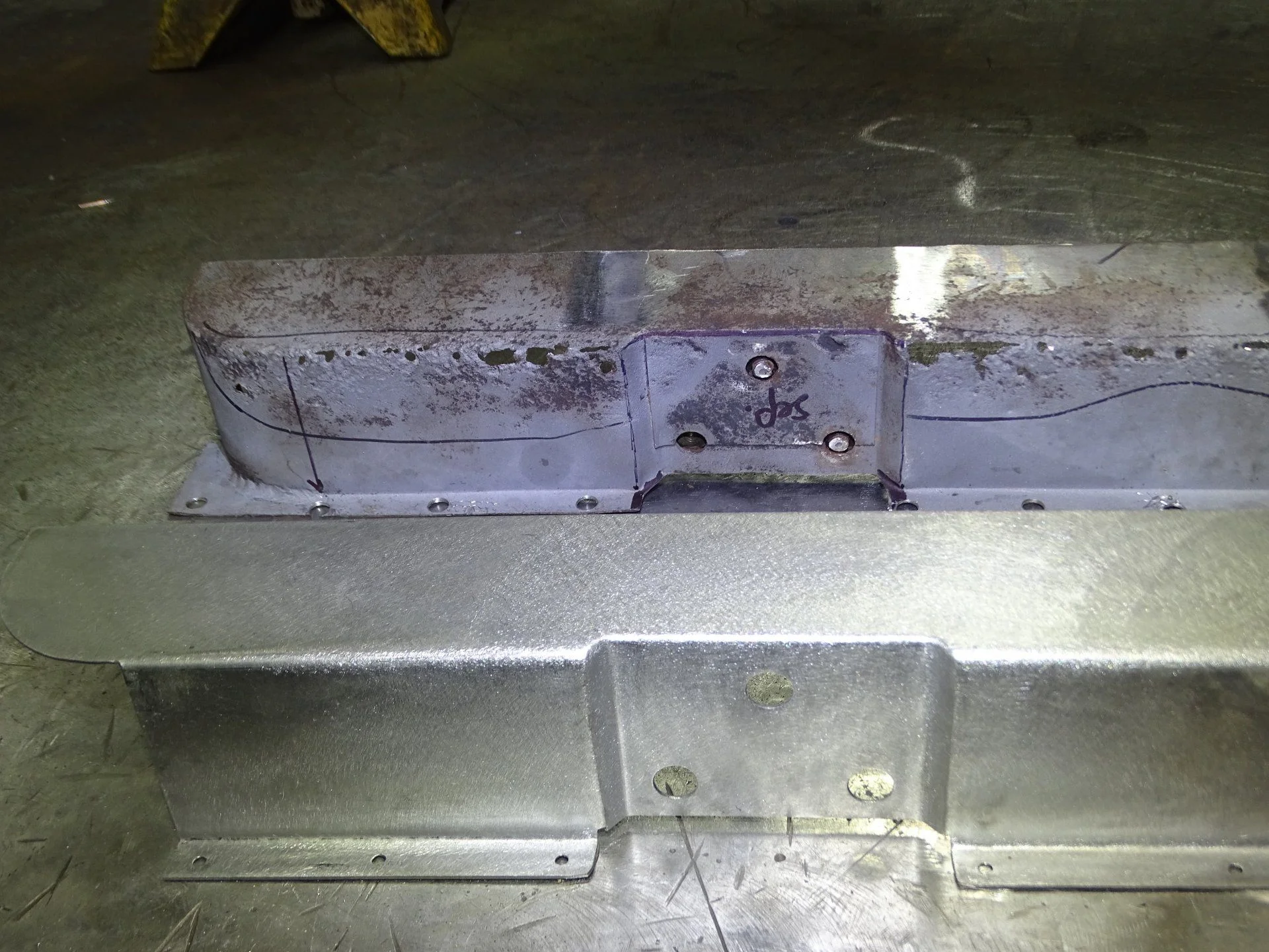

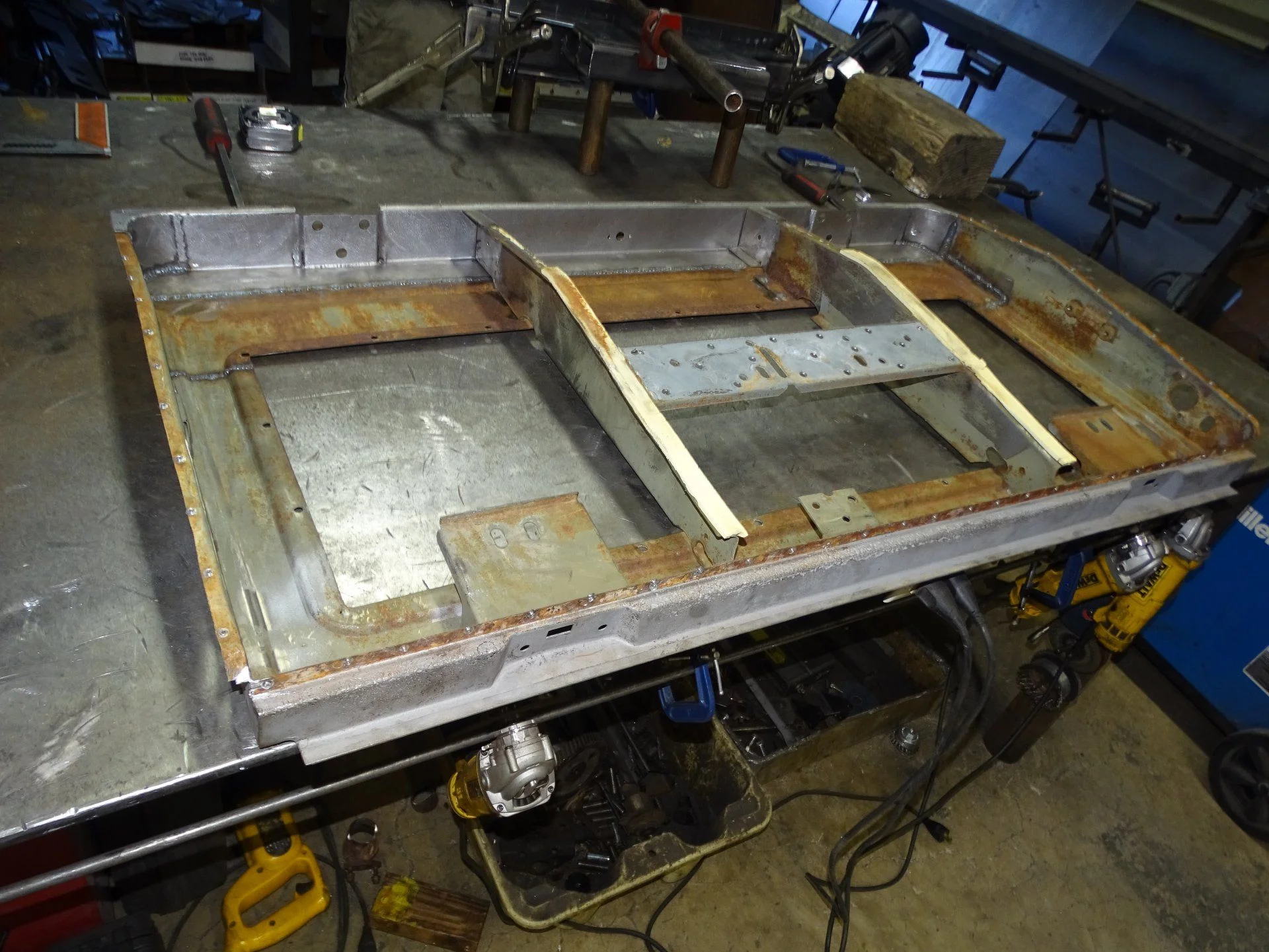

Speeding things up a bit, the tail gate hinge section is done! Now its time for a front face lift! I had an old outer shell from mike in GJ years ago, took that, measured it against what we think our outer shell measurements are and out came a fresh one!
Outer shell off and exposed inner structure.

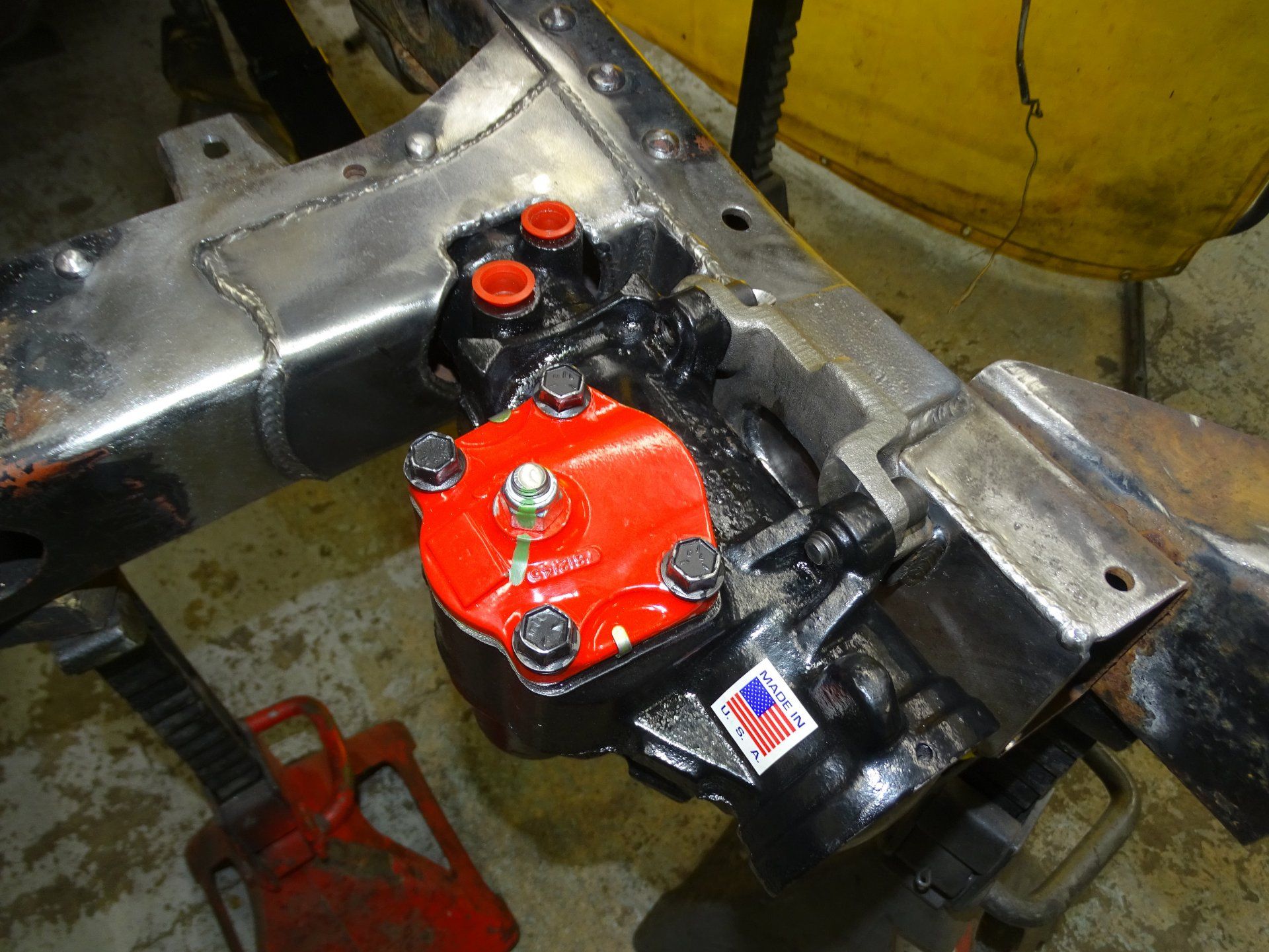

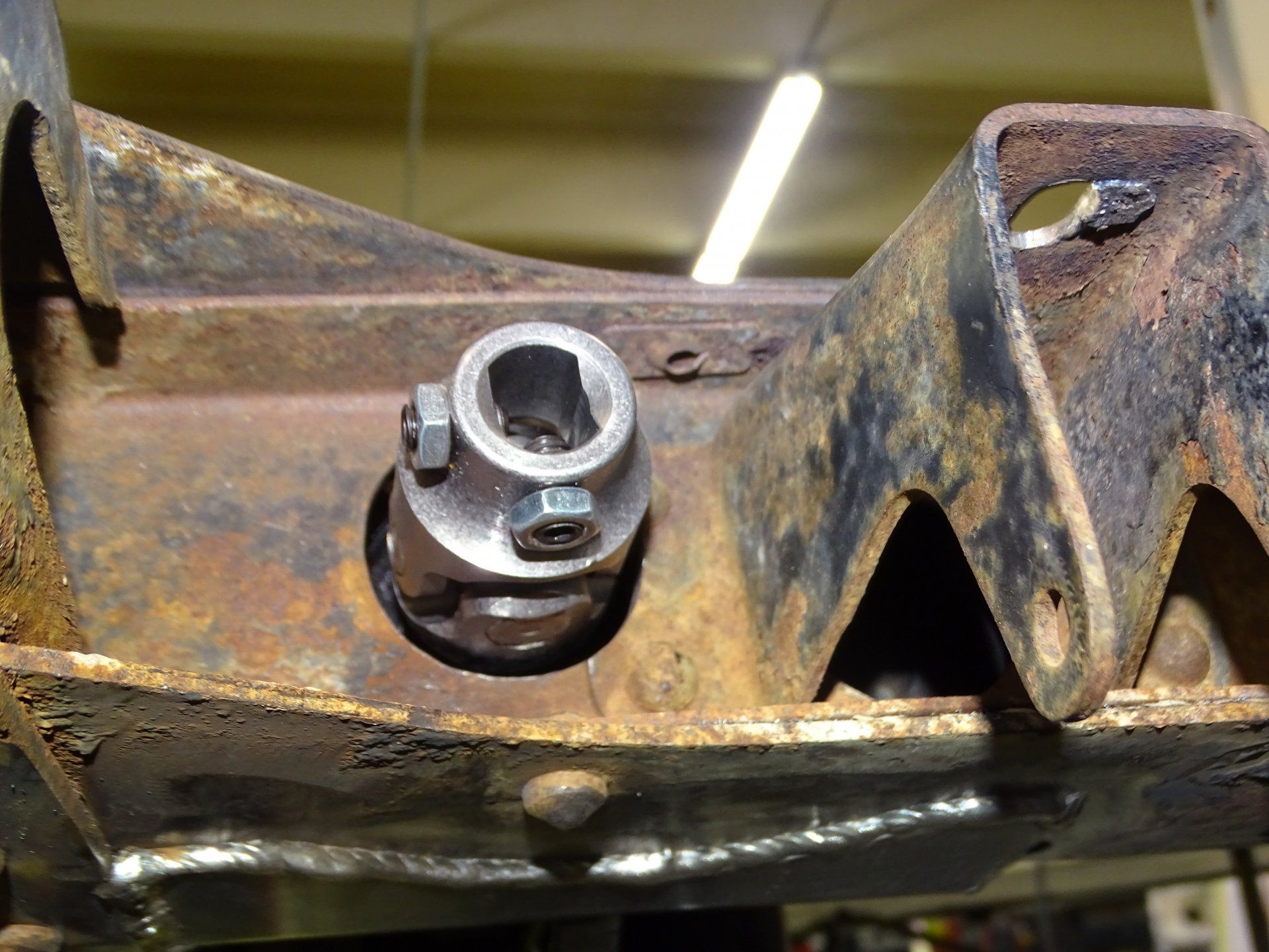

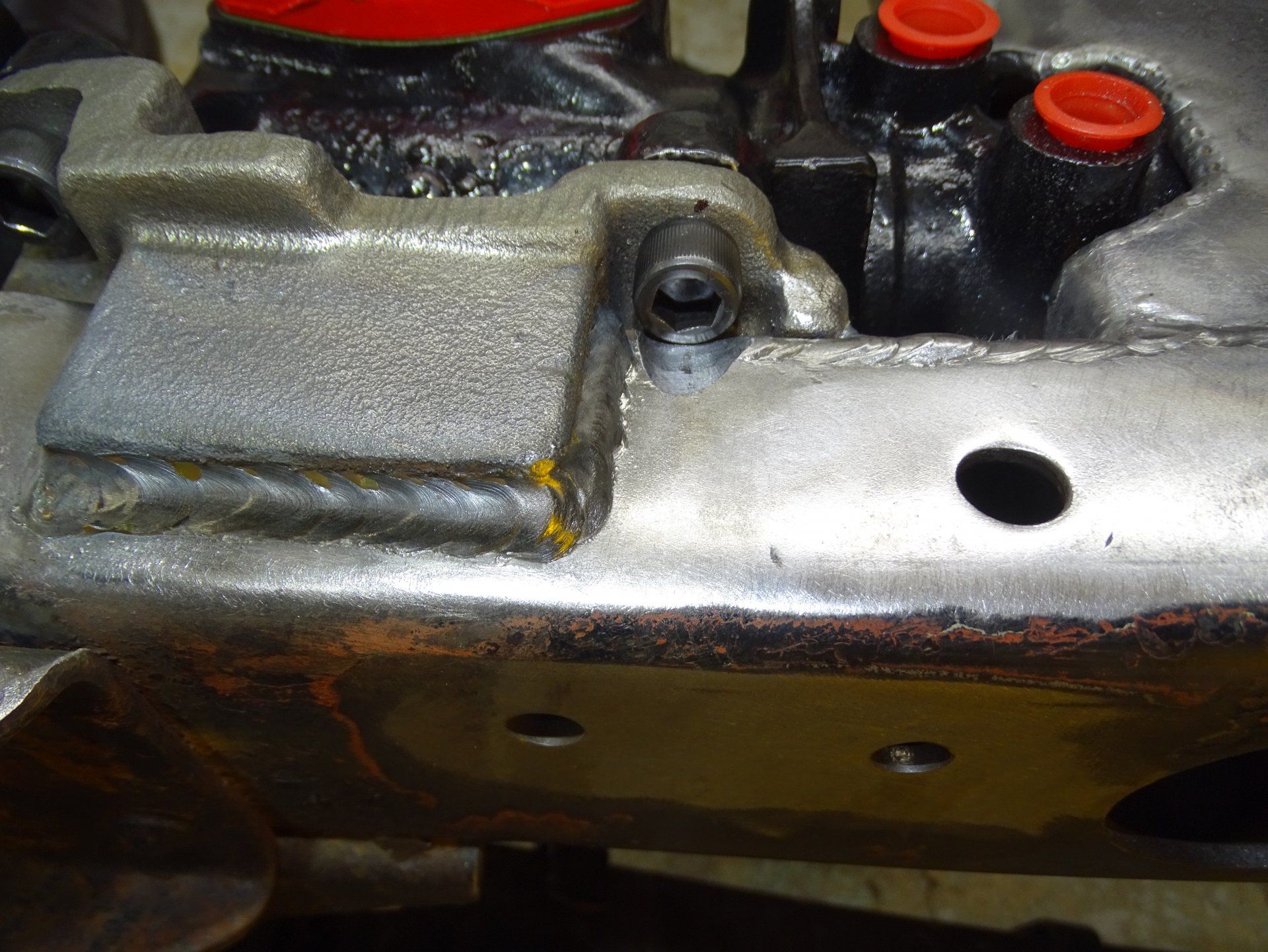

Our Power steering conversion, frame side (kit) is done! Fully welded and verified for fitment. We use 4 bolt, 4 turn large input spline, Inverted flare fitting, Red Head steering boxes from monte carlos for small tire power steering conversions.

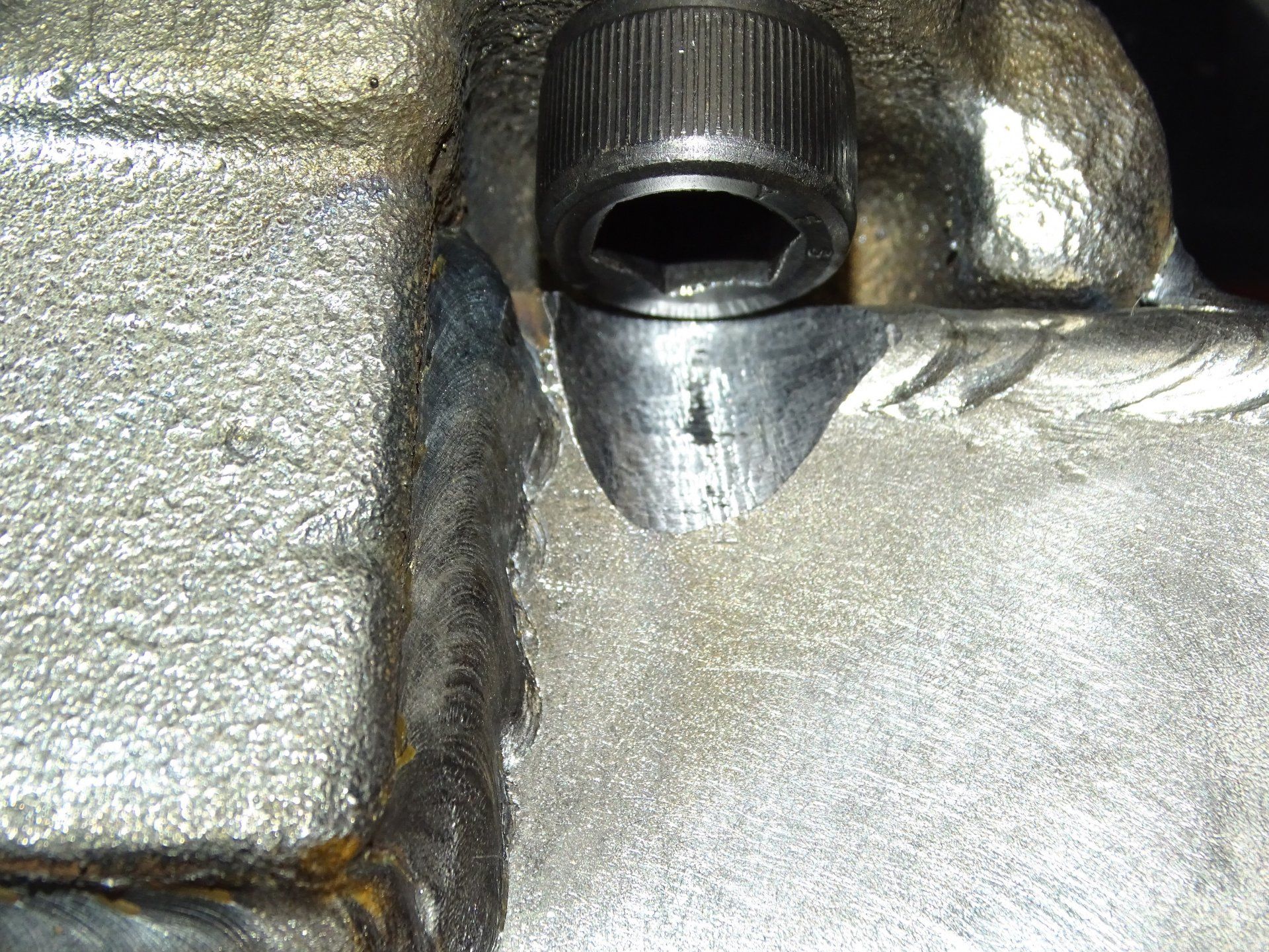

Justin, I’m curious, did you have to do anything special to weld that cast mounting plate to the frame? Looks amazing.
We pre heat with a torch some, then weld with the correct settings for a 1/4 wide plate, then I like to put a welding blanket over it to slow the cool down process. I have never heard of any of my previous PS conversion jobs, have any plate issues. Now granted you all must know I use the same plate kit for cruisers with SOA's 37"S mostly (1 42" job ) locked and wheeled hard. A good weld job goes a long way!
