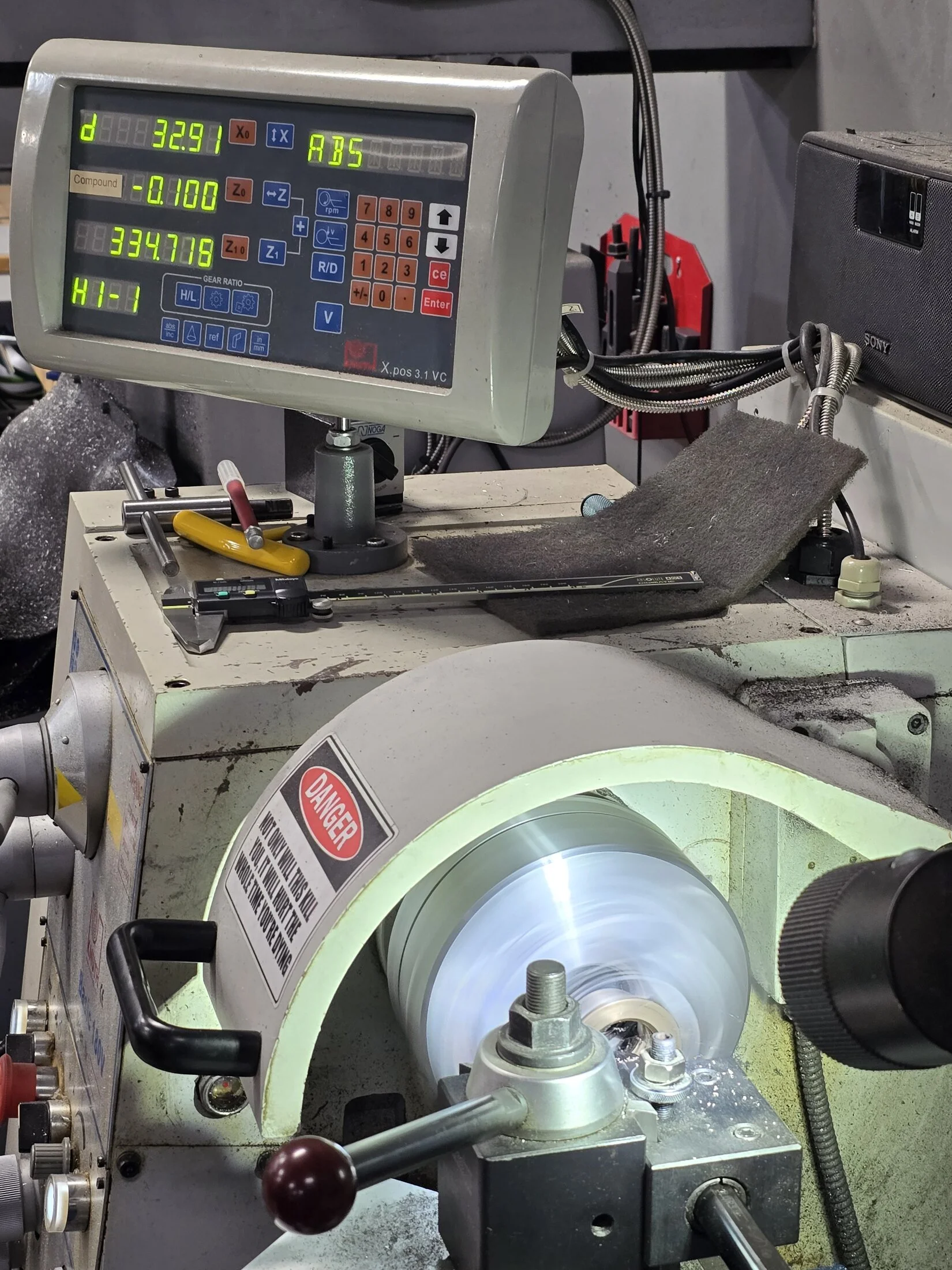

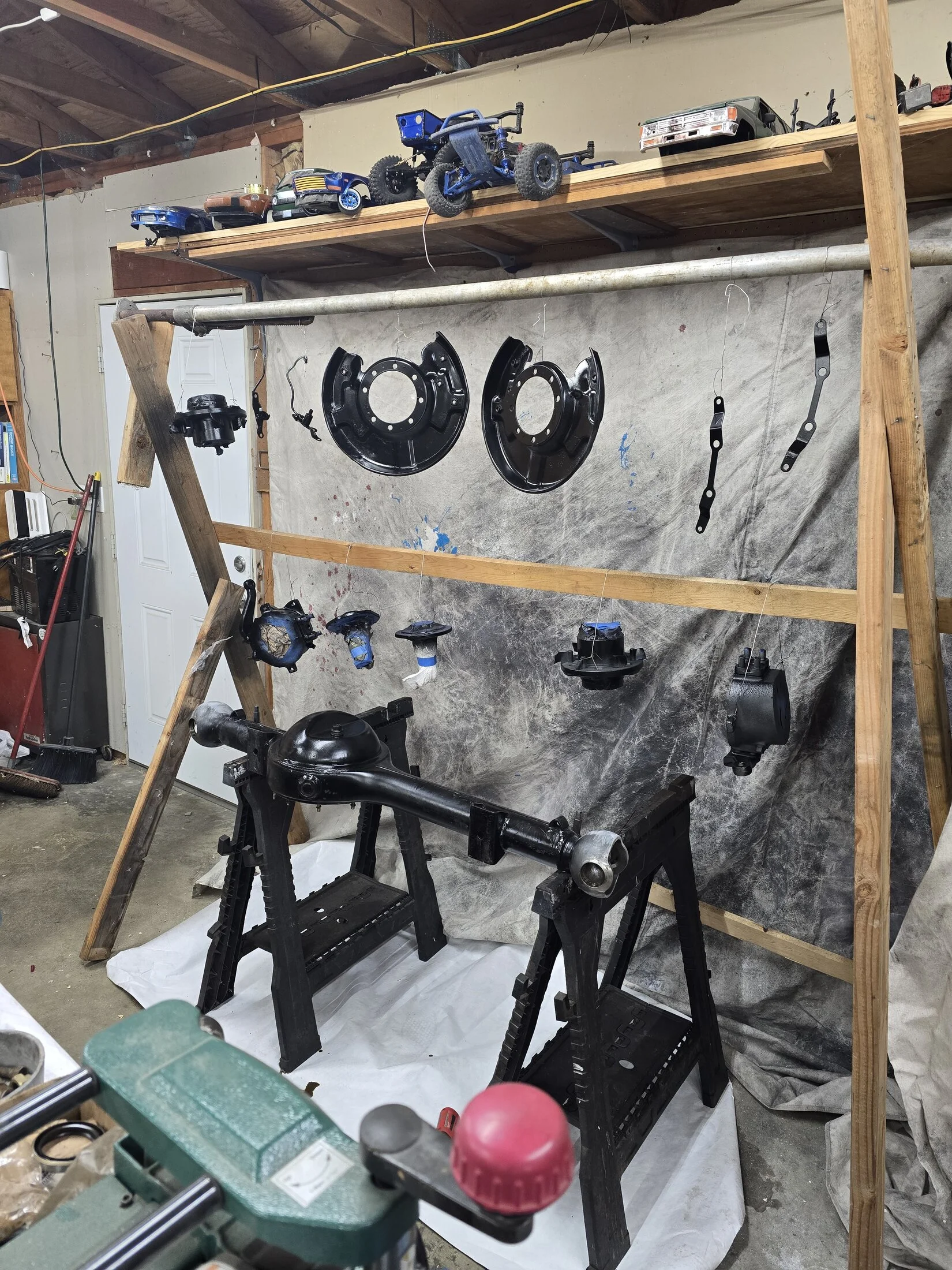

First order of business is breaks and steering. I've collected spindles, knuckles, steering arms, hubs, tie rods, spider gears, and birfs. I am keeping the stock 65 axle housings. I knocked the inner brass bushings out and bored them out to 33.05mm today to work with the birfs, since the original axle housings aren't set up for moden seals.
All the parts I've gathered are getting a fresh coat of paint and I hope to rebuild the front diff this weekend. I am gonna drop the leafs and paint them and the front of the frame while everything is off.

Just a word of caution though. I’d be uncomfortable wrenching on and under a rig with the front end held up by jack stands on leaf springs. I’d encourage you to purchase a 4”x4” long enough to span between the frame and put your jack stands under that stick. Also, stacking a few mounted tires under the front crossmember to function as an emergency catch is definitely worthwhile. I did similar work on my 45 and there was a lot of hammering, pushing, … while underneath the rig. Don’t want the thing coming down on you!

I appreciate the concern, but I did not get under it like that! The jack stands on the leafs was only temporary and they are on the frame with the leaves off now.
