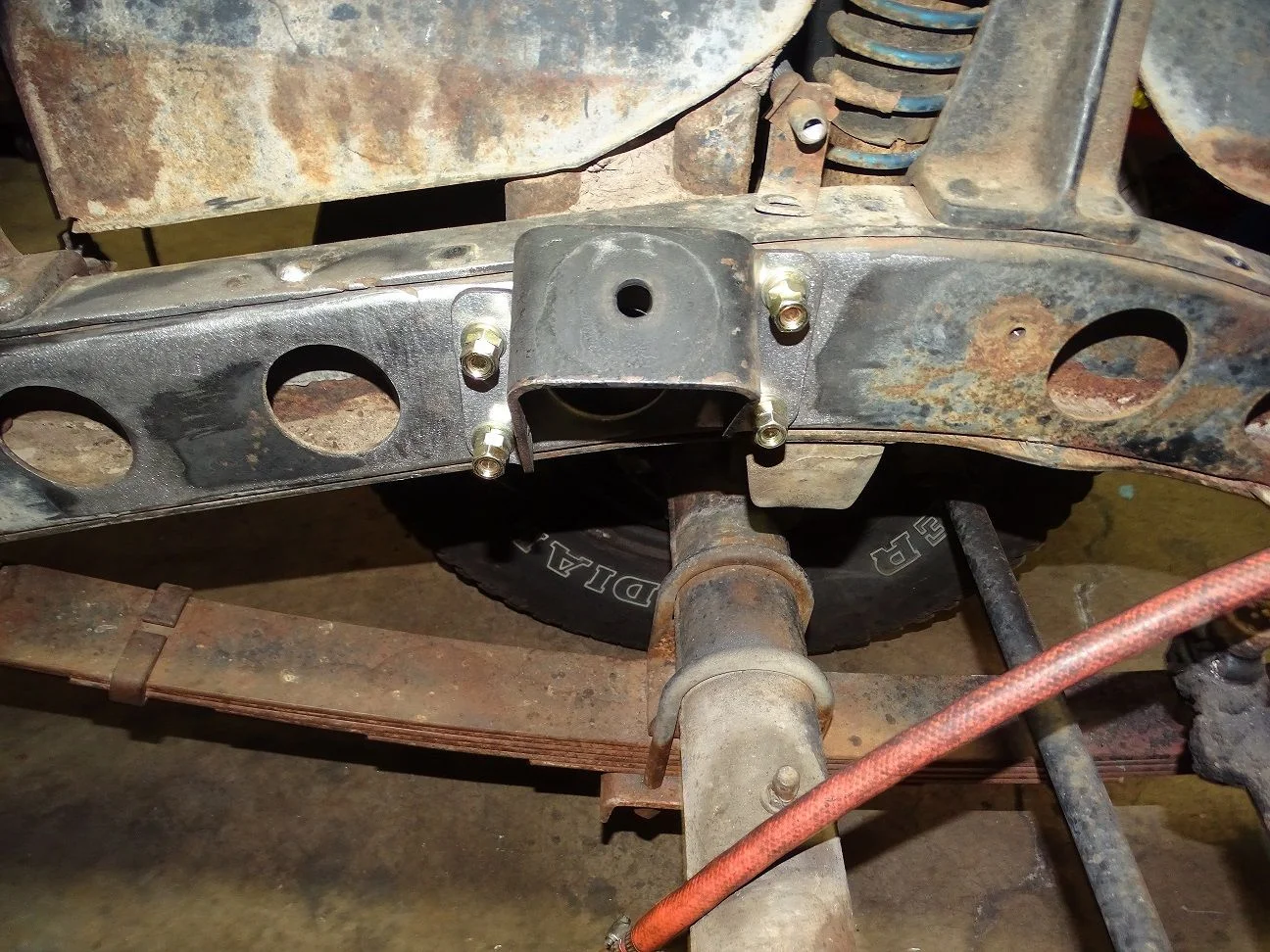

1. Power steering...Blah blah blah.... Yes everyone wants PS. I DIDN'T want to do this, customer needs to be able to due to comfort.
So I crafted up a sweet plan. Use a GM Box... I know all you haters, I get it but, hang in there. GM box allows me to keep the factory column and retain the "3 on the tree" Yes we are mixing this girl up. Retaining the OEM steering is, well not that bad after all! We have a kit in the works just for this, so.....SAG box to factory column and shifting... I'm happy it came out the way it did.

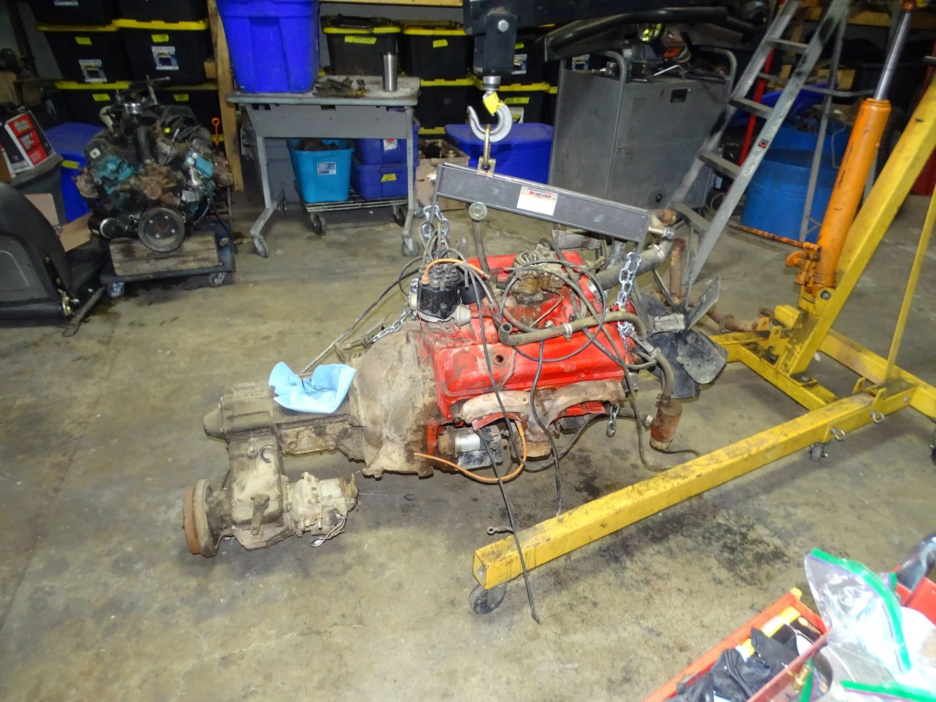

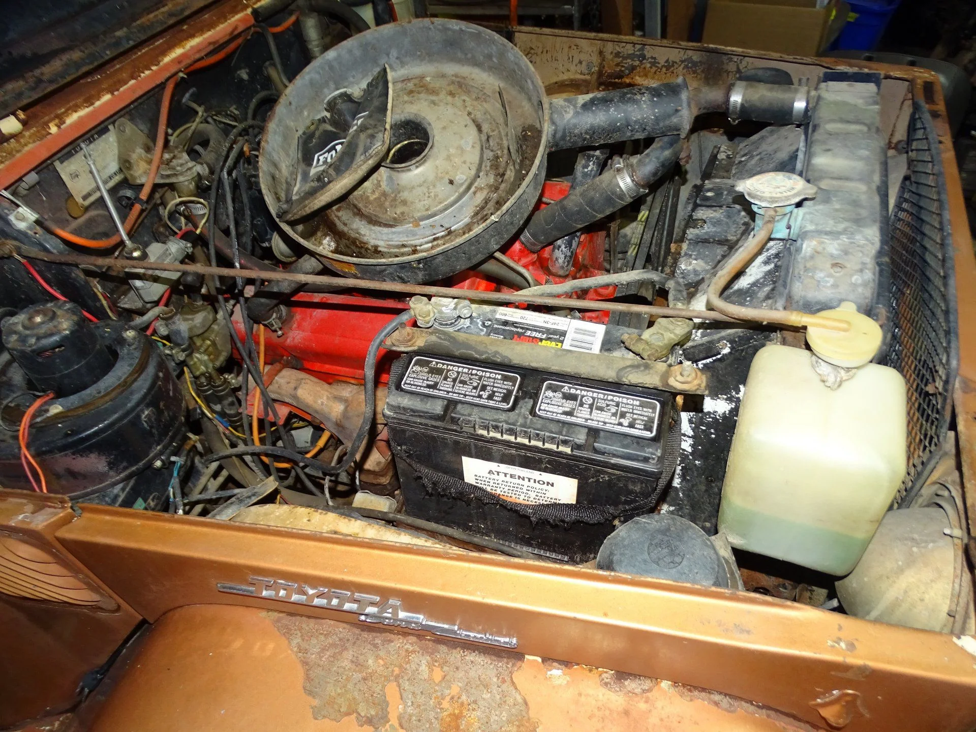

3. Engine. It had a 68 302 Camaro v8 in it when we recieved it so I wanted OE. F135? Found one and was thrilled! Then I thought holy smokes I remembered he wants to drive this...LOL so we opted to swap in a 2F...But with a mix.
Must retain the 65 era looks as much as possible, So we will be throwing in some tricks for that.

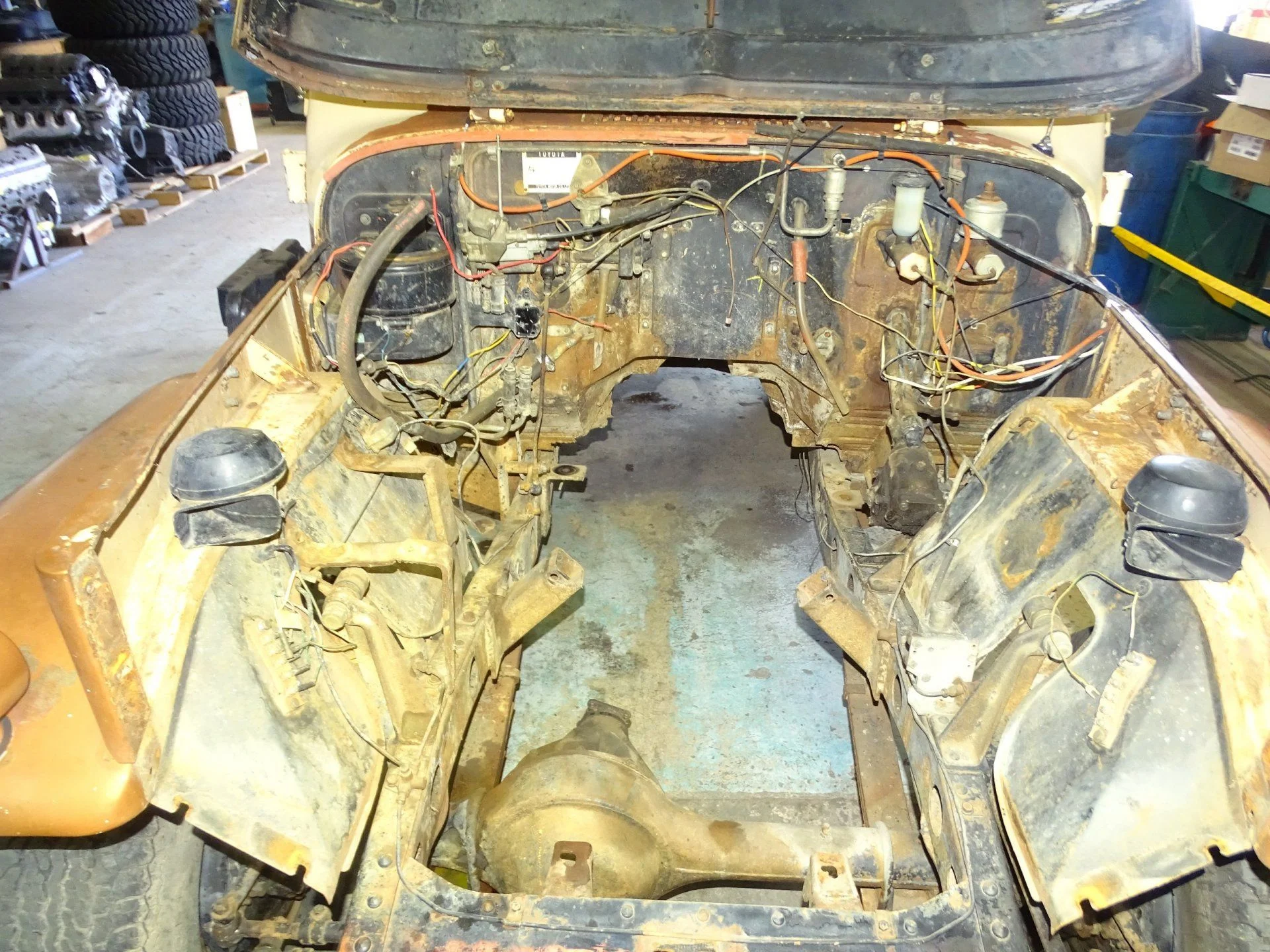

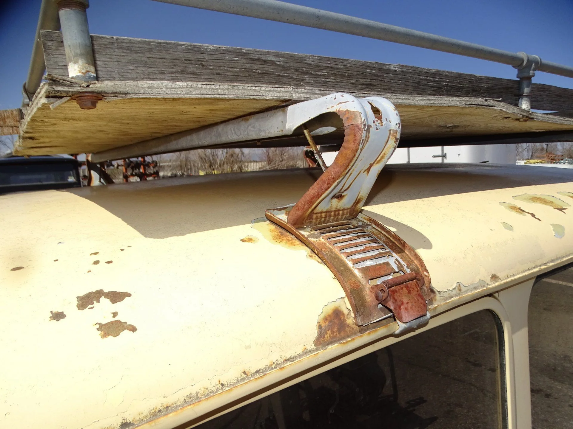

5. Restore the body..... Yes a massive amount of work. This body is in good shape comparatively...

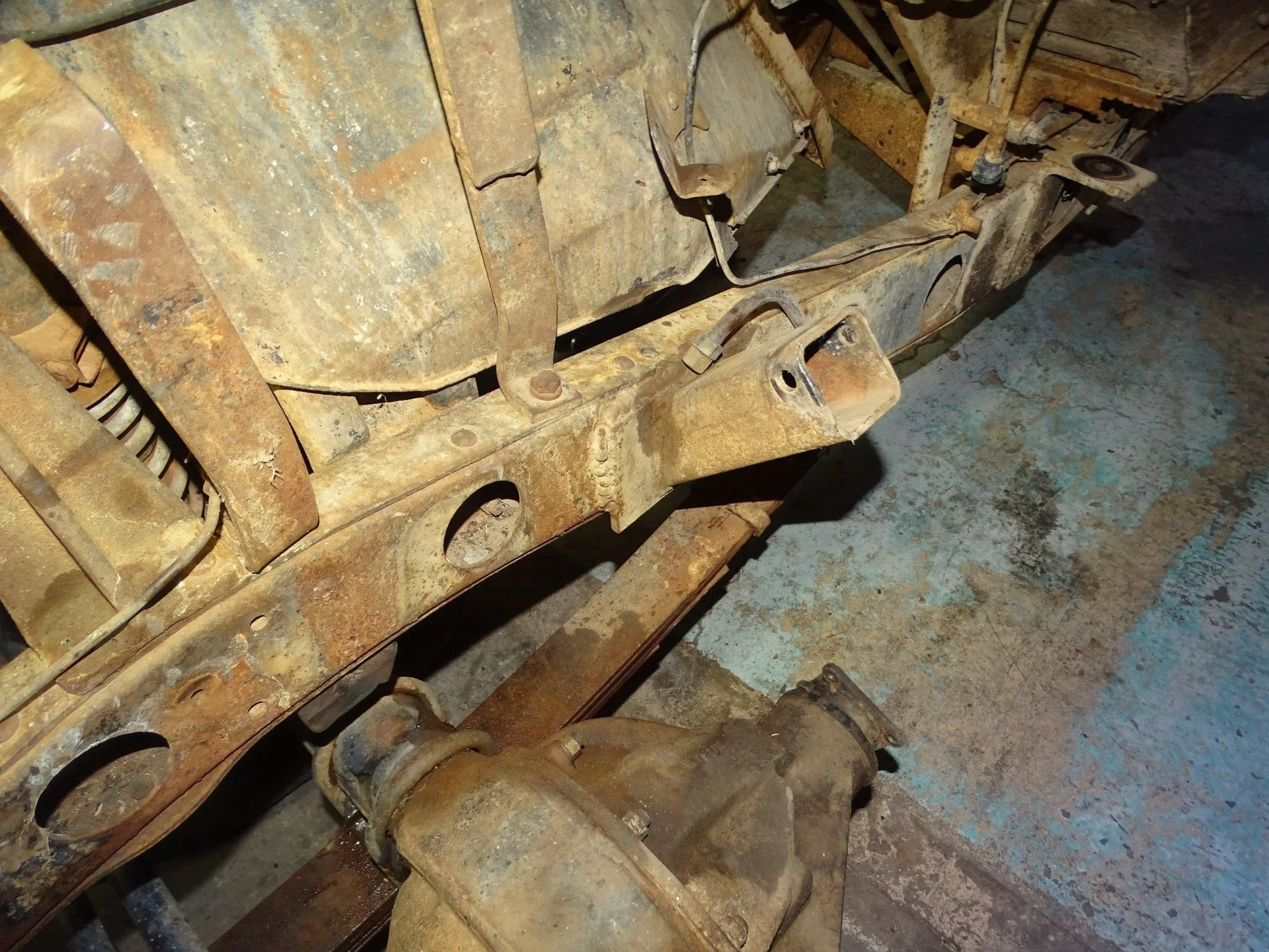

7. Suspension... The normal 2.5" lift stuff... No issue

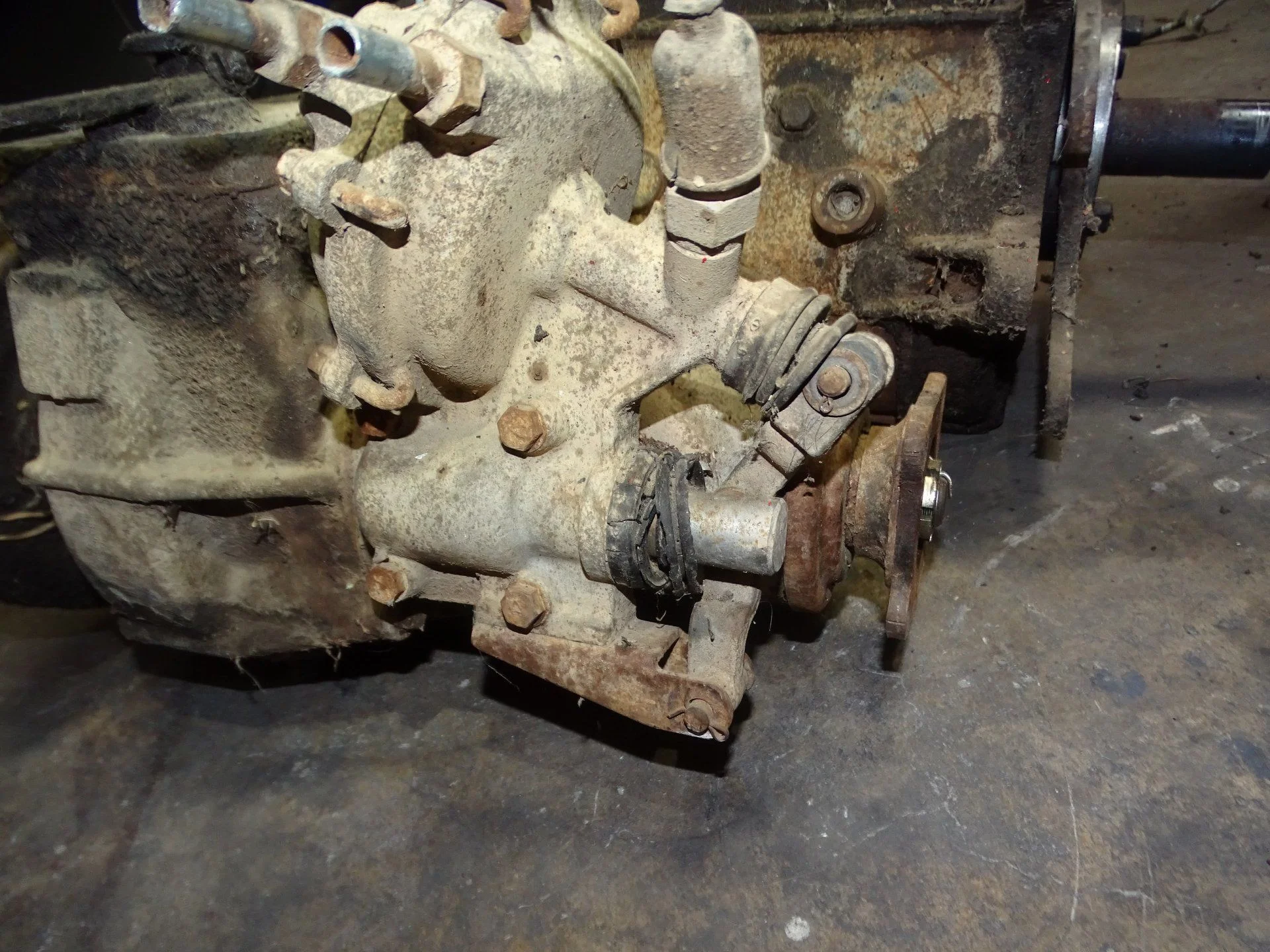

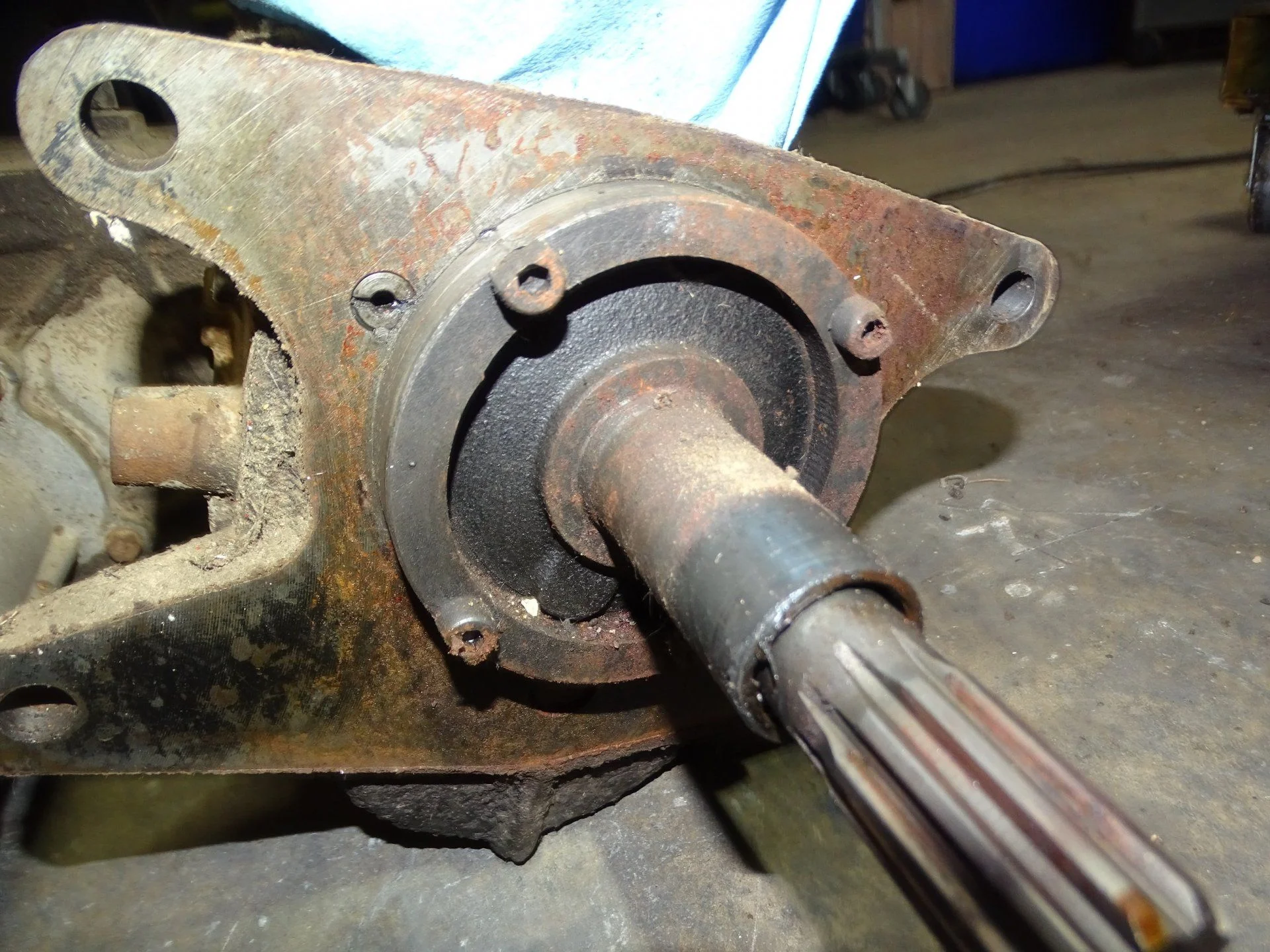

9. Misc, drivetrain restoration, wiring resto, etc... No big deal.

Original paint was Colorado Beige and the off white. Cool color combo that I never see, so we are going to get her back to her OE colors.
