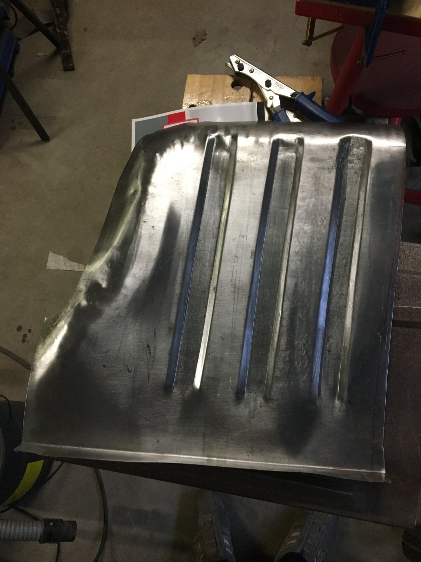

Did some testing with the bead roller and got a decent result on a test piece.
Here is the result with one side of the ribs done.
After this side the bead roller must be changed as it is not possible to enter the work from the other side.
The ribs done except for the ends.
It came out nice.
Not bad for a first try.

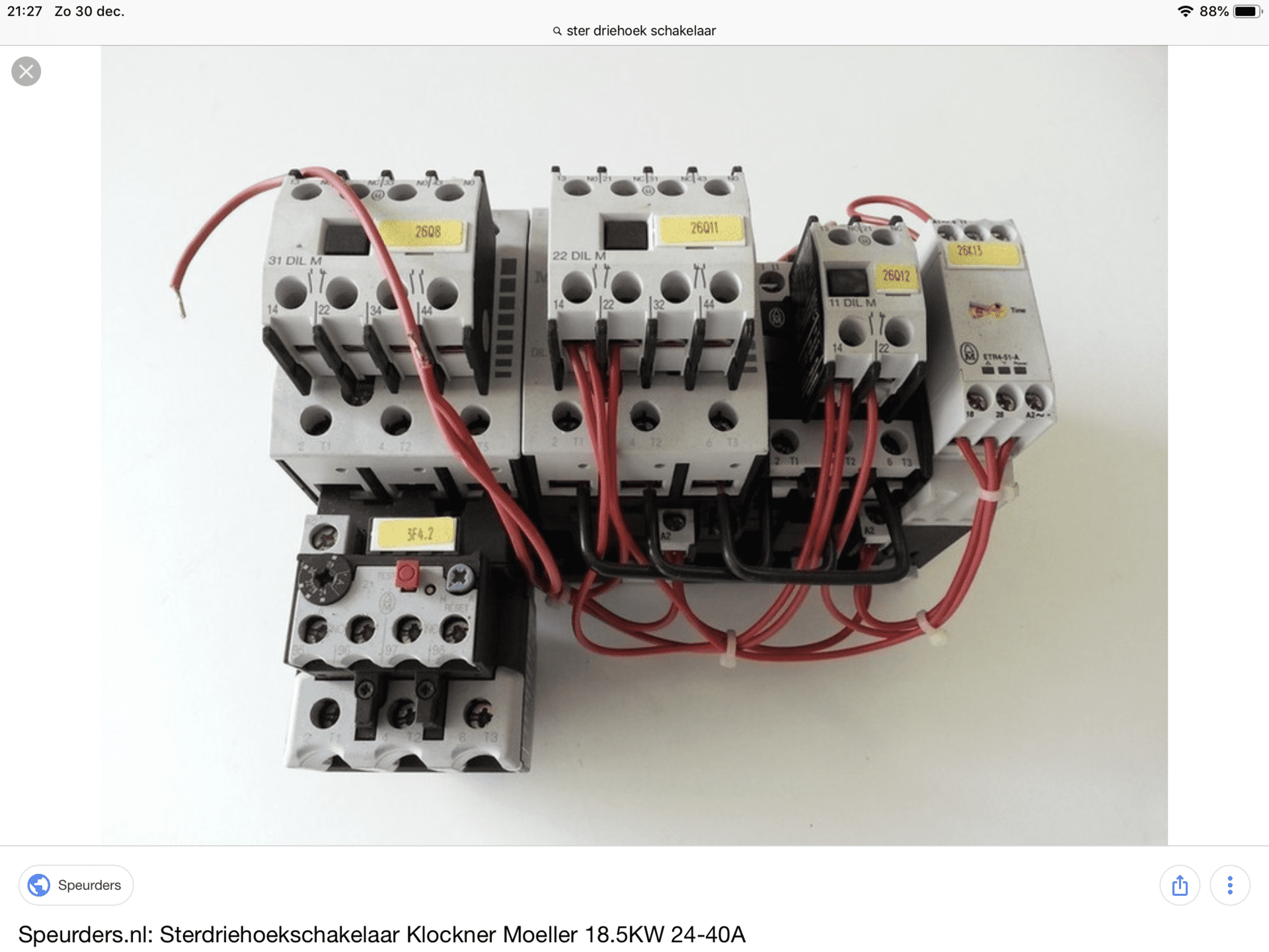

View attachment 1866077 This is an example of a star delta switch.
Do you need a new one?
Most of that is modular and can be replaced piece by piece, depending on how bad the contactors are you may even be able to rebuild them. Depending on size also.
Shoot me some pics of your mess, maybe I can help.

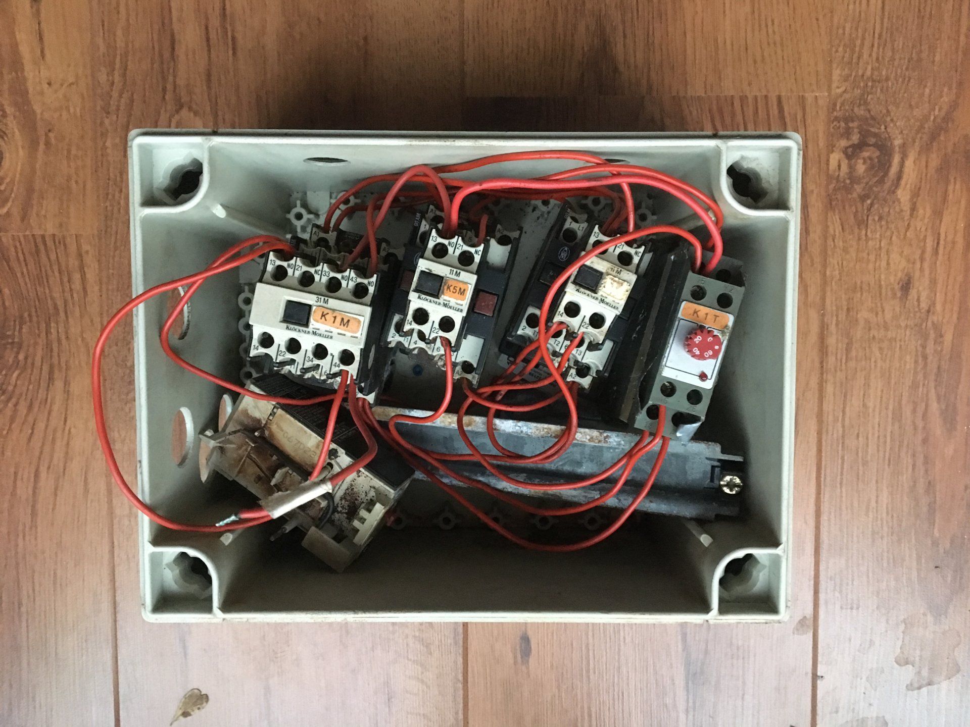

This is the old switch, the relais may be restorable but for now I just wanted everything new. The breaker box is in another part of the building which is closed most of the time i’m Working so if the breakers trips I can’t use air untill it is switched on again.
The old thermo block is gone.
