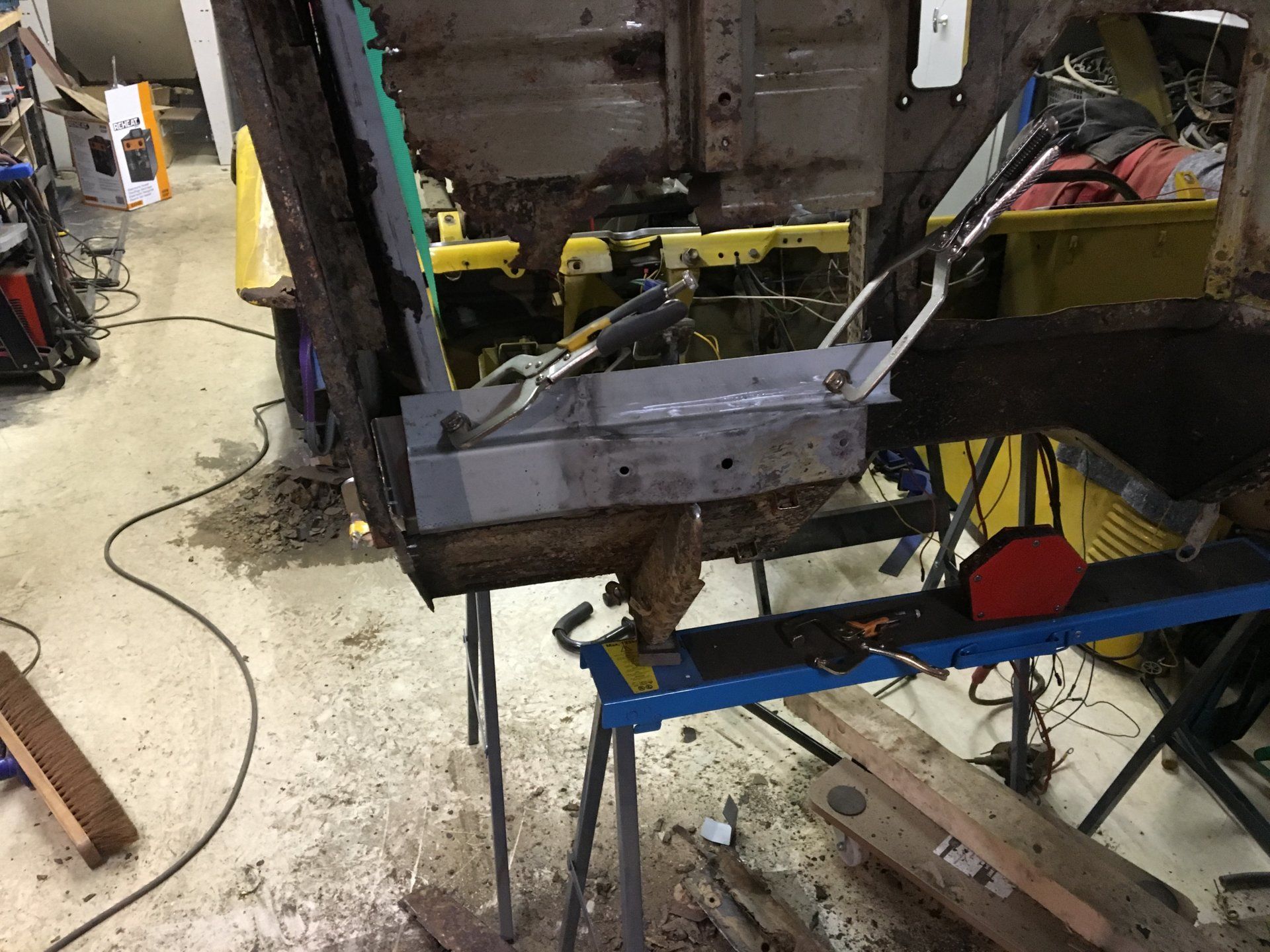

Considering remaking the DS floor from scratch.

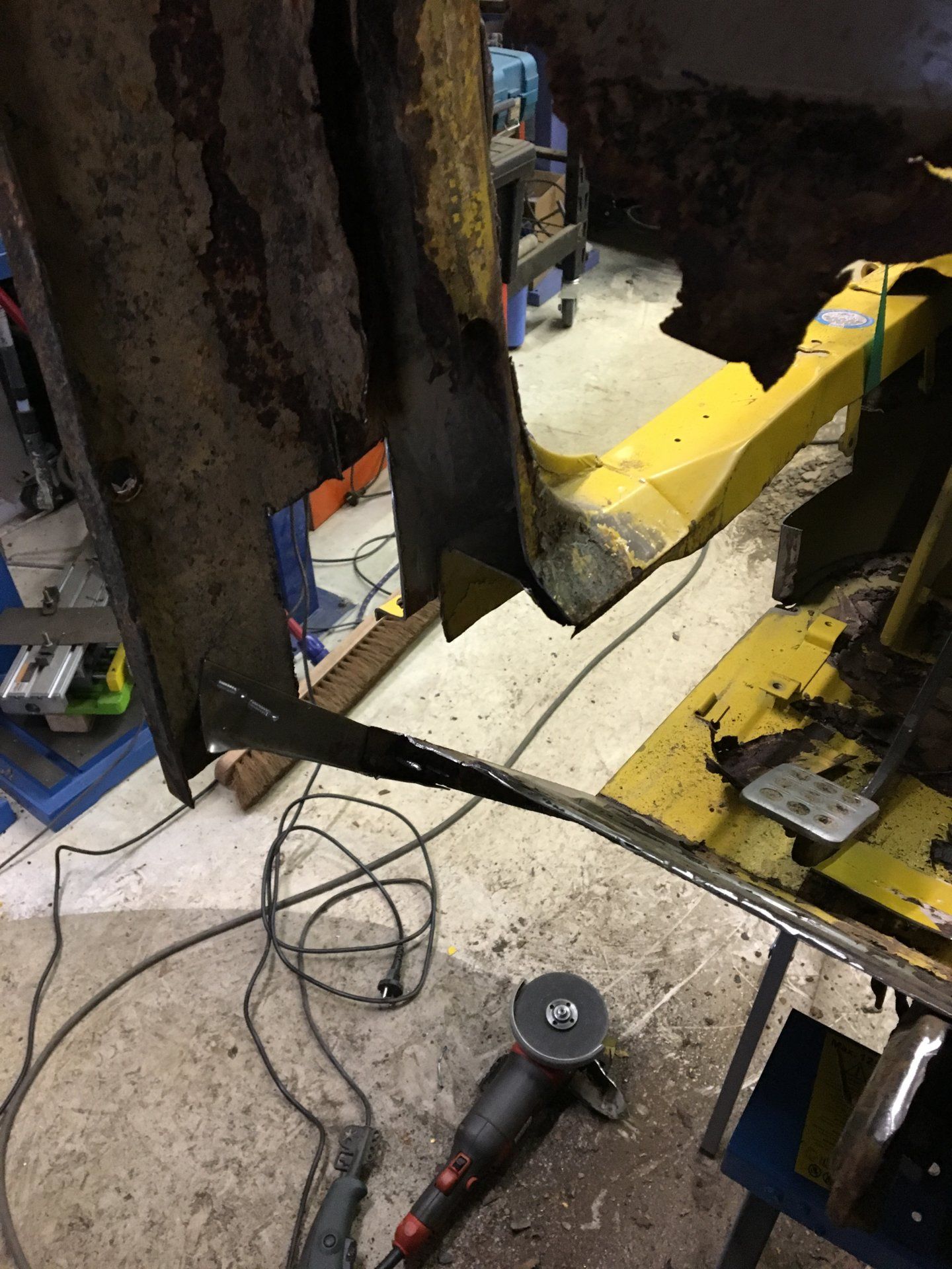

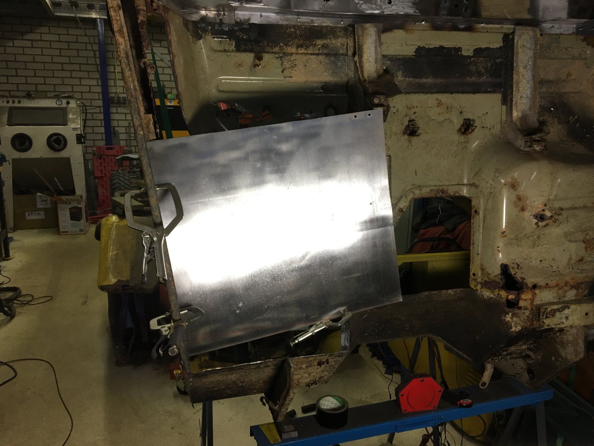

Front floor patch and the lower part of the A pillar
Unfortunately I forgot that the edge of the floor is at an angle, so a new patch must be made.
The side of the front DS support is rusted up bad so it needs to be replaced.
Patch made.
Welded the patch in and the new middle section, I wanted to use the original end piece but decided to make a new piece.
New front floor section with the angled floor.

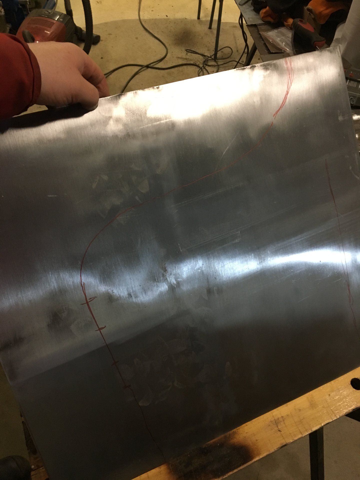

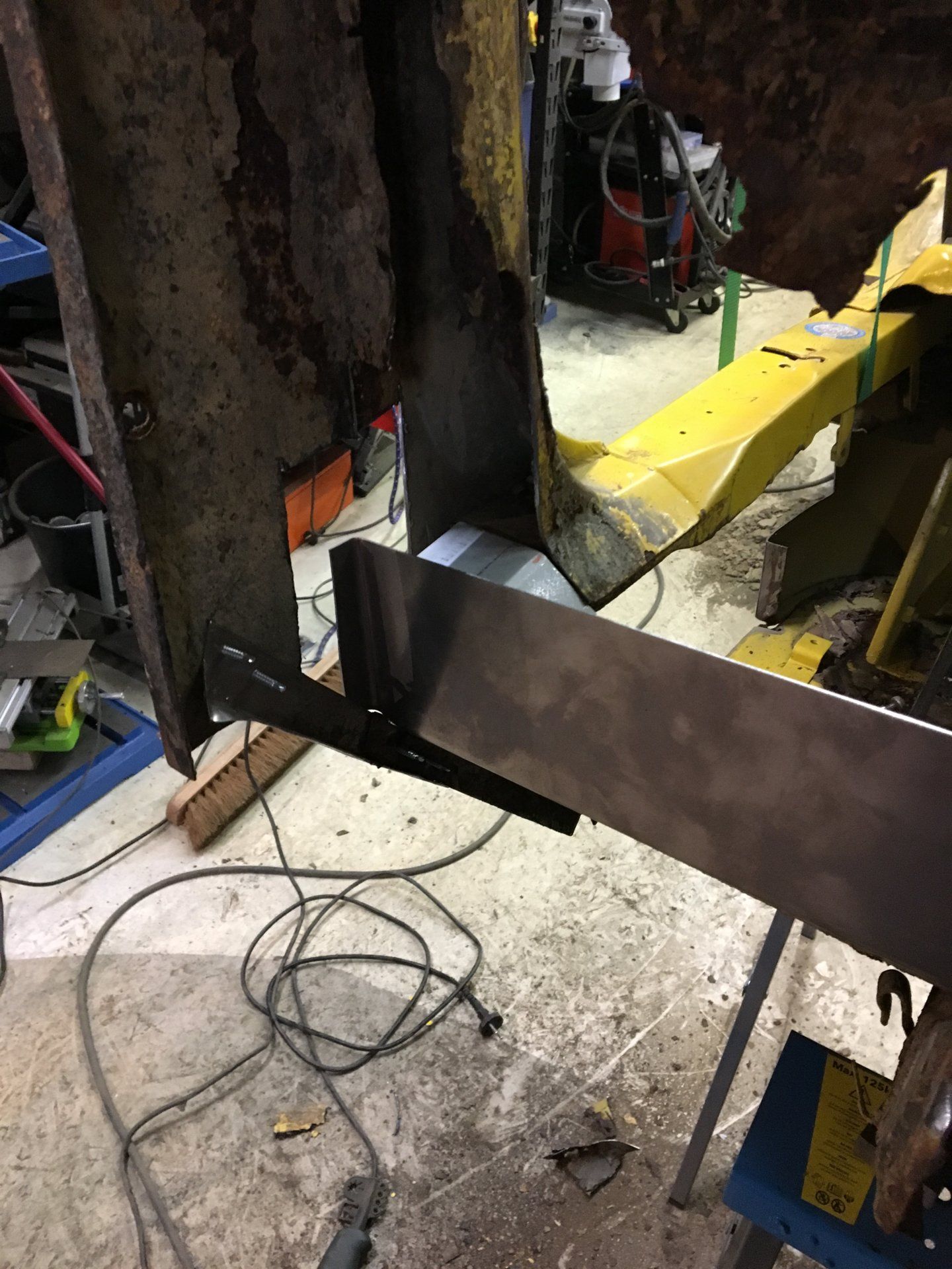

Started with making a new DS front floor.
Never did something like this before so it is trail and error.
Started with an old piece of sheet that I roughly cut to size.

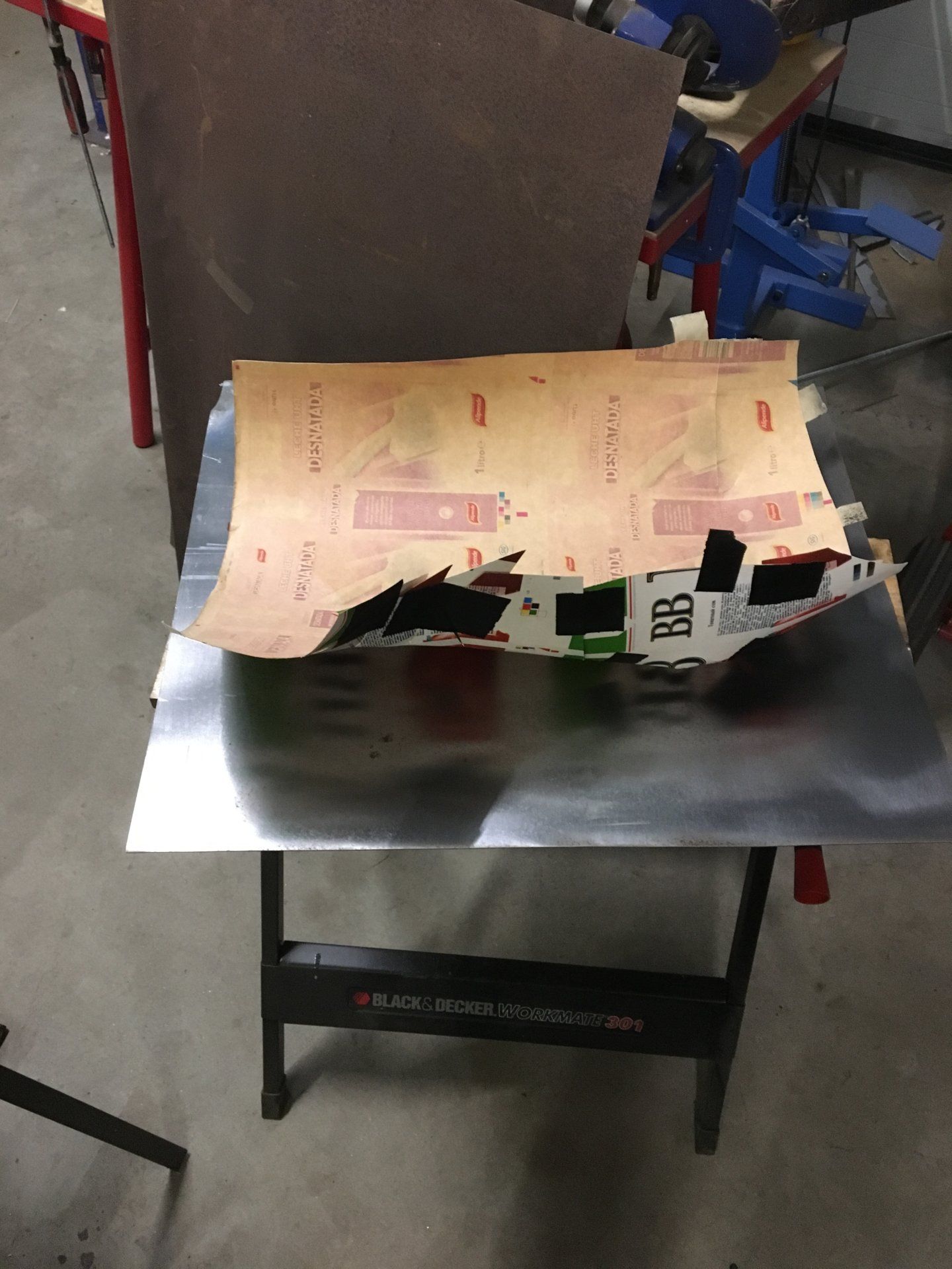

Next I cut a piece of cardboard and started to shape it over the remaining part of the floor.

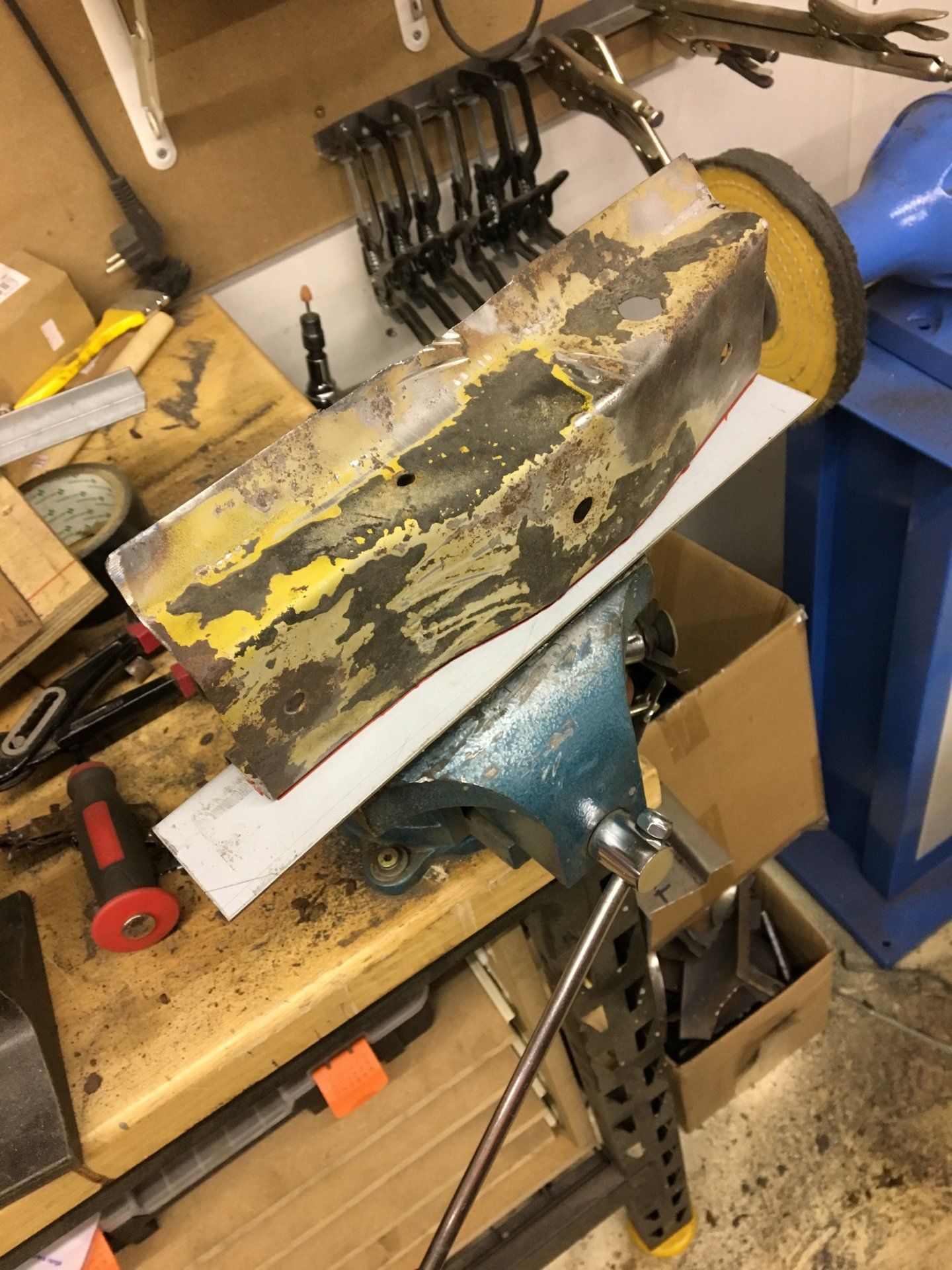

Bend the side of the floor where itconnects to the rocker panel and clamped it to the foot.
Marked the different points on the sheet.
Inside line where the ribs end.
After some hammering and E Wheeling the shape is showing.
This is where I got today, wil see tomorrow if this one will be right or scrap.
Next step will be wheeling out the ribs and when there is enough material flow form the correct shape in the ribs.
