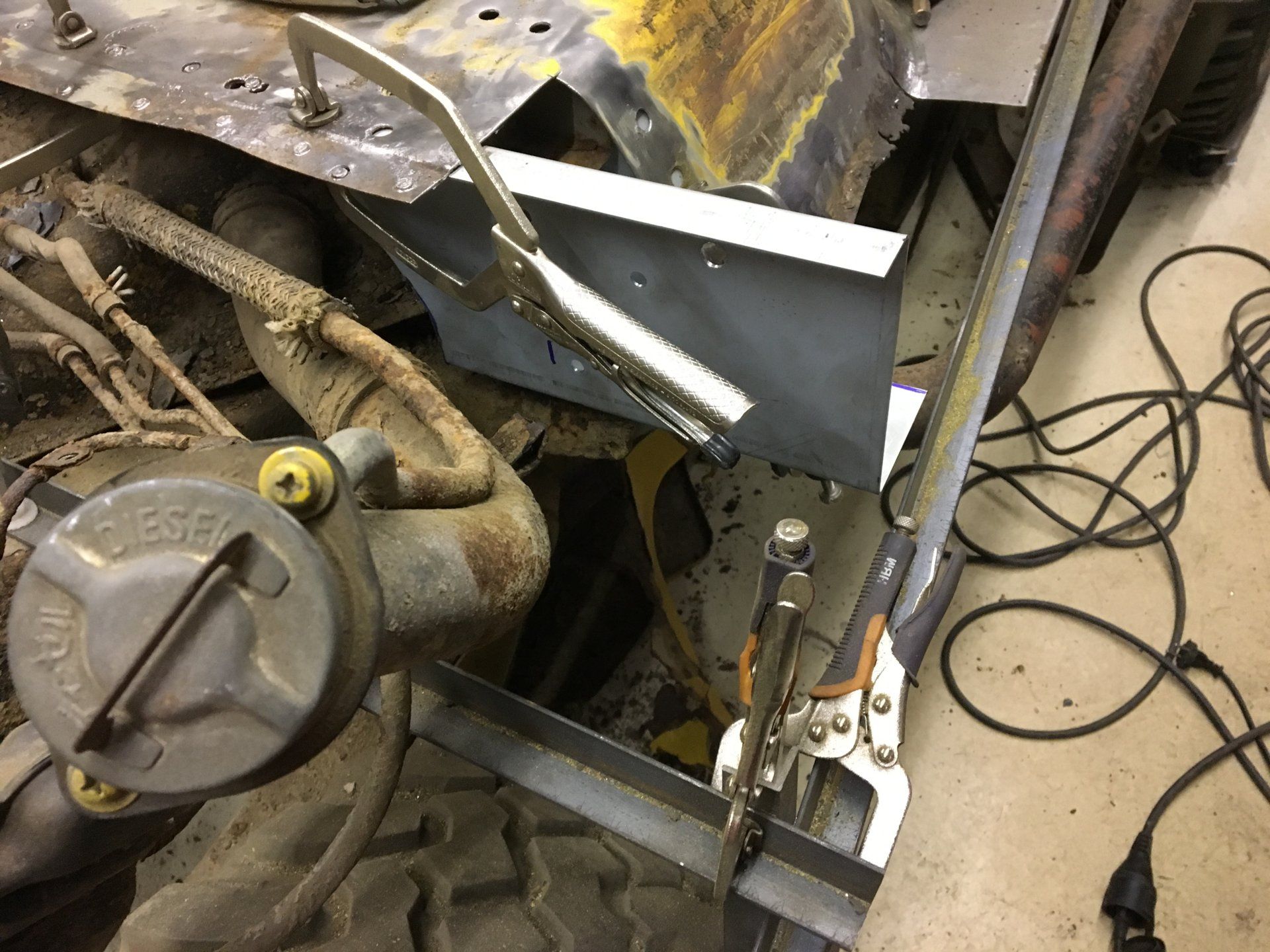

Old VS new
And a test fit
Not done yet but the basic shape is there.

Positioned the beam
