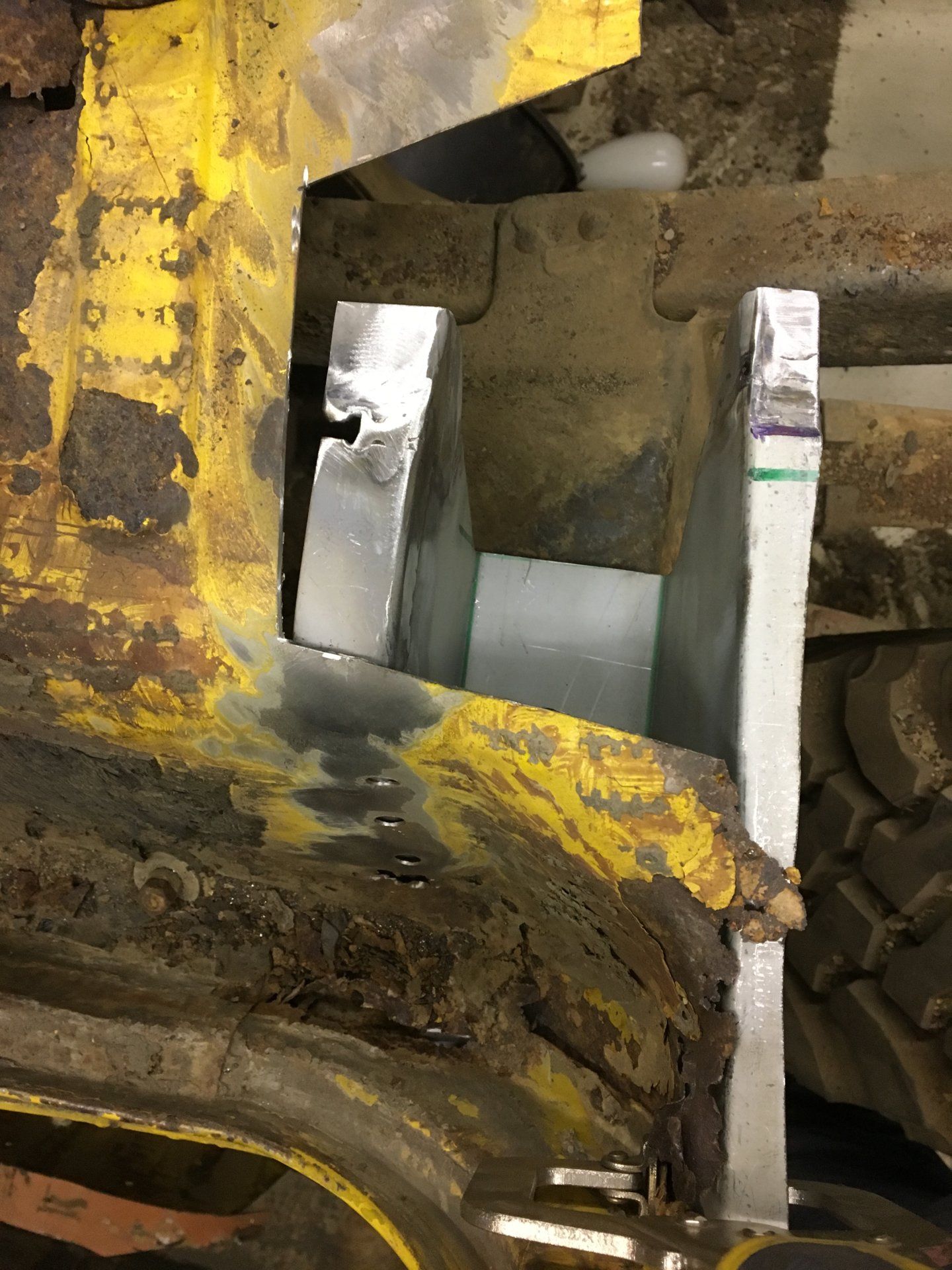

This surface showed too much curve. I had to make a releave cut to get it straight.
The marking shows the position of the cut.
Putting the pieces together.
The releave cut helped to shape the part to its correct shape.
You can see the cut here. The outside of the curve needs to fit the floor.

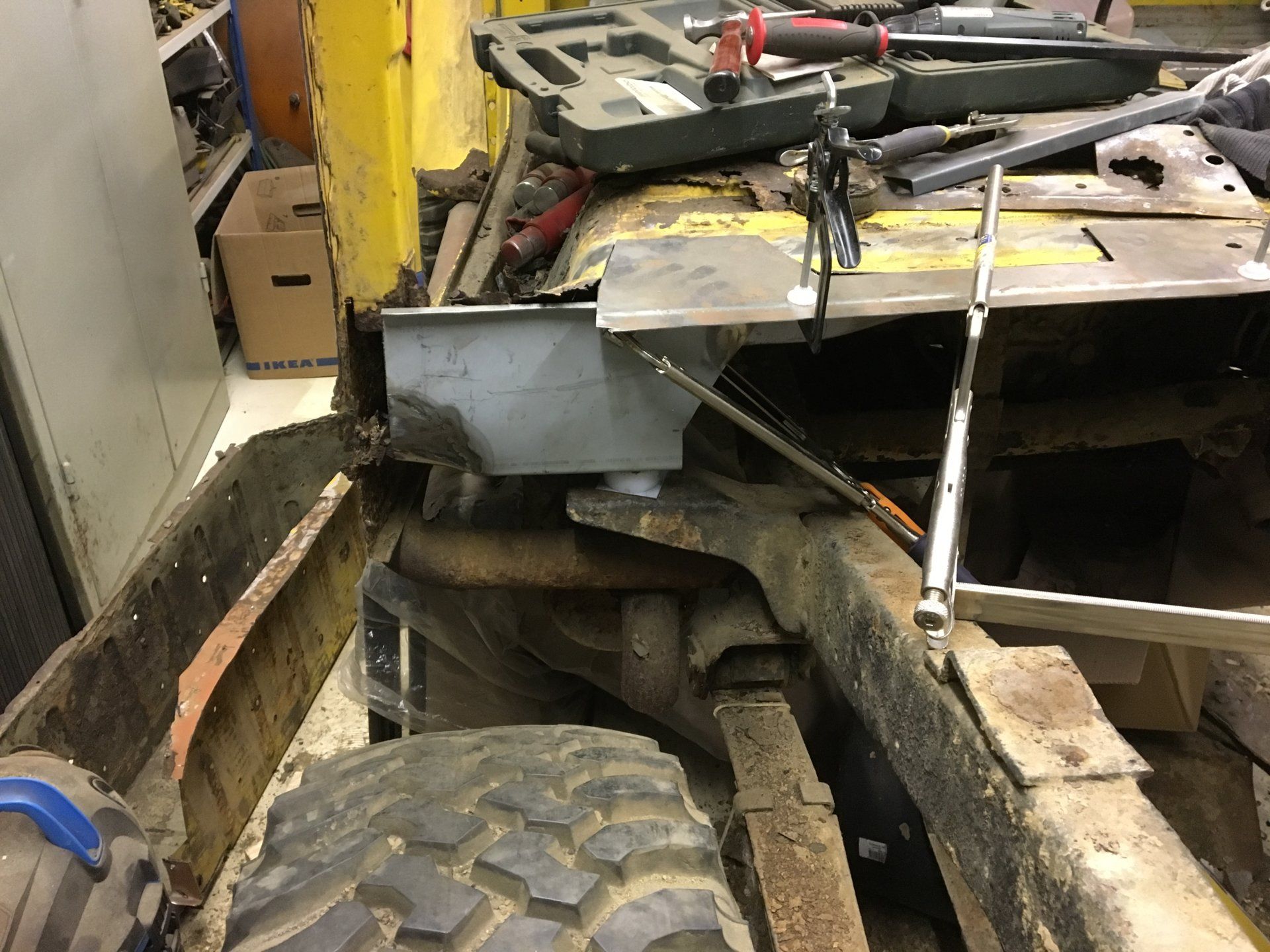

With the rocker and B pillar in place.
Now for the connecting piece.
Shape needs a little tweeking.
This is a better fit.
Cut lines drawn.
Almost there.

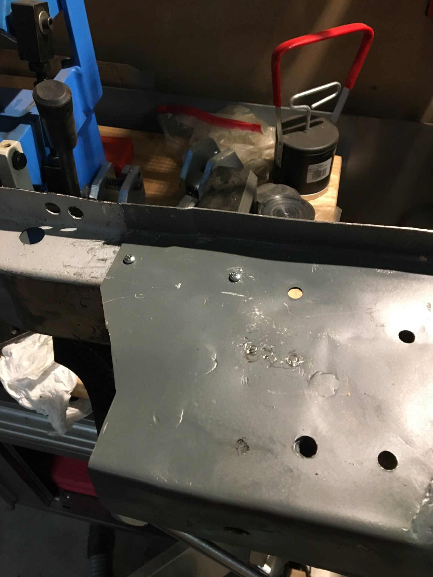

Did some more hammering and E wheeling for a good fit
Cut the excess to the floor patch off.
All in the correct position.
Top corner corrected and made some spot welds.

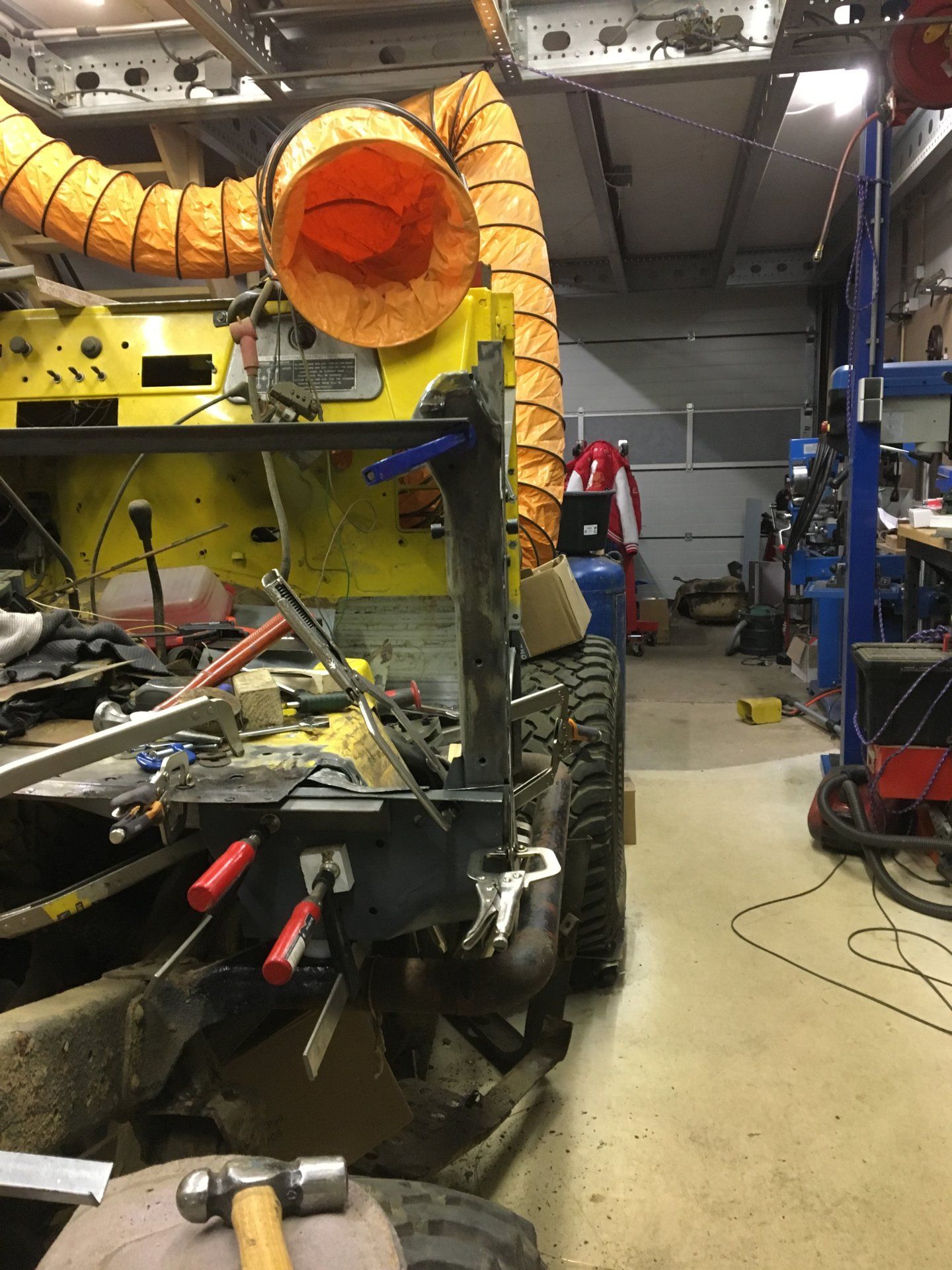

Welded up the B pillar, at least most of it and started to allign everything on the PS.
The crossbeam and the temp body mounts in position on the PS.
Having the PS kick planel in position is important as the A pillar is lose ar the bottom.
It is interesting to see how everything relates.
And fitting again.

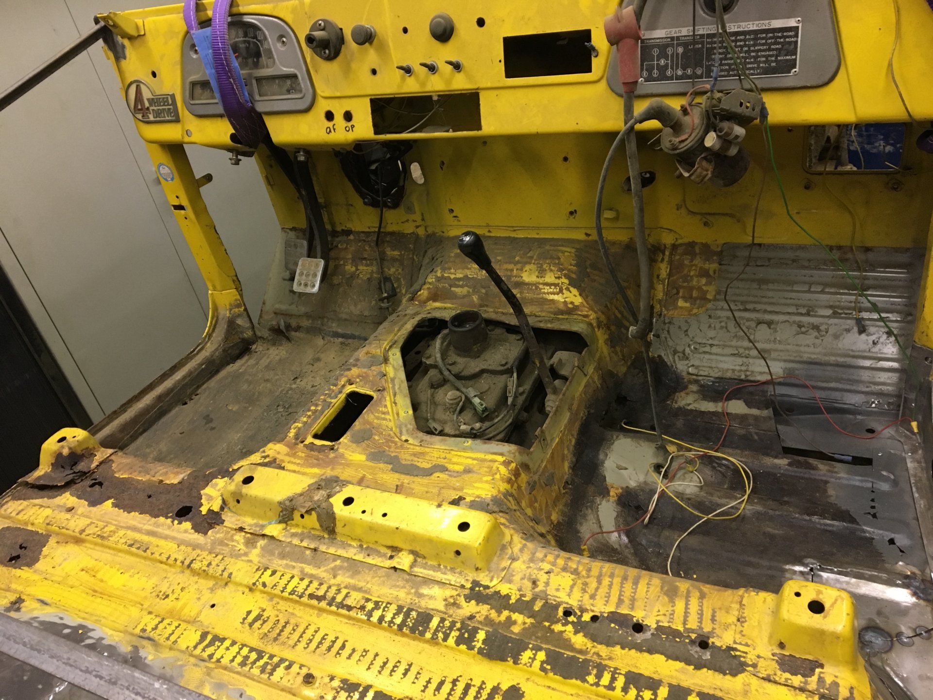

What you see is the entyre wiring harness the PO used. Just enough to get it running.
