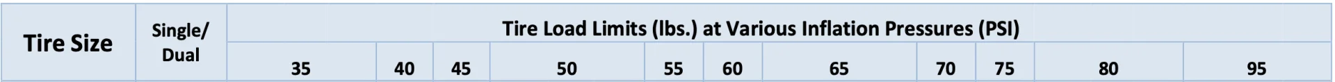

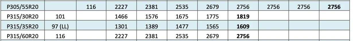

Its just reinforcement for a higher pressure ceiling for what those increased forces act on the tire.
People are confusing load range and load index. Load index is like for like regardless of the tire or its rating. Contrary to the LT info below actually (well get into that).
Load ranges denote PSI limits as a function of tire construction.
And on top of that, as shown, pressure adjustments past limit in XL are for rigidity and do not increase load. It may be used when towing for example for stability.
Above you are shown two Ps, in different sizes, but exact same load limits while one is SL, the other XL. Both though are 116 ID.
The PSI load limits are identical across the board, and one is no more "strong" than the other in that regard.
Its just that the larger tire has more volume and that same volumetric pressurized air and can hold the same weight despite being a "weaker" SL construction.
Load was never an issue for anyone here. And you literally dont have to look at anything other than the LOAD ID when shopping. IE 111- 118 - 121 etc.
Just meet or exceed that and you are good. And its stamped on every tire made. Even with LTs. It's the same scale being used. And you need not apply voodoo.
The reason why the LTs are a LOWER LOAD LIMIT PER PSI, is because of heat concerns.
On top of that, for the same given volume and pressure, a thicker LT will actually carry more load despite what you see below.
These are not figures of "what the tire can support" these are figures for how much load can safely be run (heat etc taken into account) at that PSI.
LTs are in every metric stronger than Ps, no matter the amount of mental gymnastics people do here.
Do you rationally think, a thicker, stronger, more reinforced tire, in the exact same size, at the exact same PSI can actually hold less weight?
We are skipping common sense to ego boast and espouse BS that actually doesn't even apply to reality.

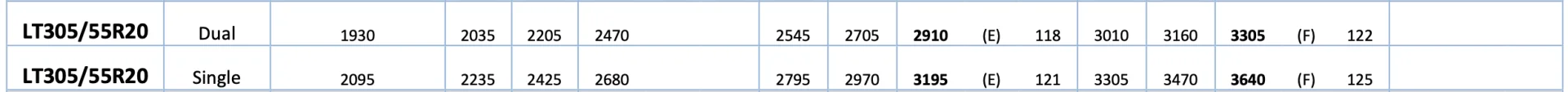

It goes back to what me and @TeCKis300 are harping on constantly, this chart is being severely misused and misunderstood.
Even as far as having bogus claims of 35 PSI minimums that are completely unsubstantiated.
One more thing with the pressures not being equivalent here has to do with rebound. An equal LT at equal pressure with a P will not rebound the same way.
And that means the thicker carcass resists compliance and the compound gives less thus dissipating less force and generating heat whereas the P will give allowing the air to compress inside the tire instead of the tire flexing and heating up.
Running an LT and adjusting for some imaginative ignorant equivalence using a load safety metric is an exercise in futility.
You will literally skid all over the road with some of these Es at 40-42 PSI. It's just dumb, and 50% of people here run them according to these flawed ideas.
This also makes it a pain in the ass to read tire reviews. (horrible in the wet)... Were you at an obscene PSI? Probably so.
Different makes and model tires has literally nothing to do with it...
And more importantly, anyone running 26 PSI please for the love of god, don't do this. It's actually life threateningly dangerous.
Its the only reason i really bother anymore to talk about this subject. Some people just listen to the forum like gospel.
