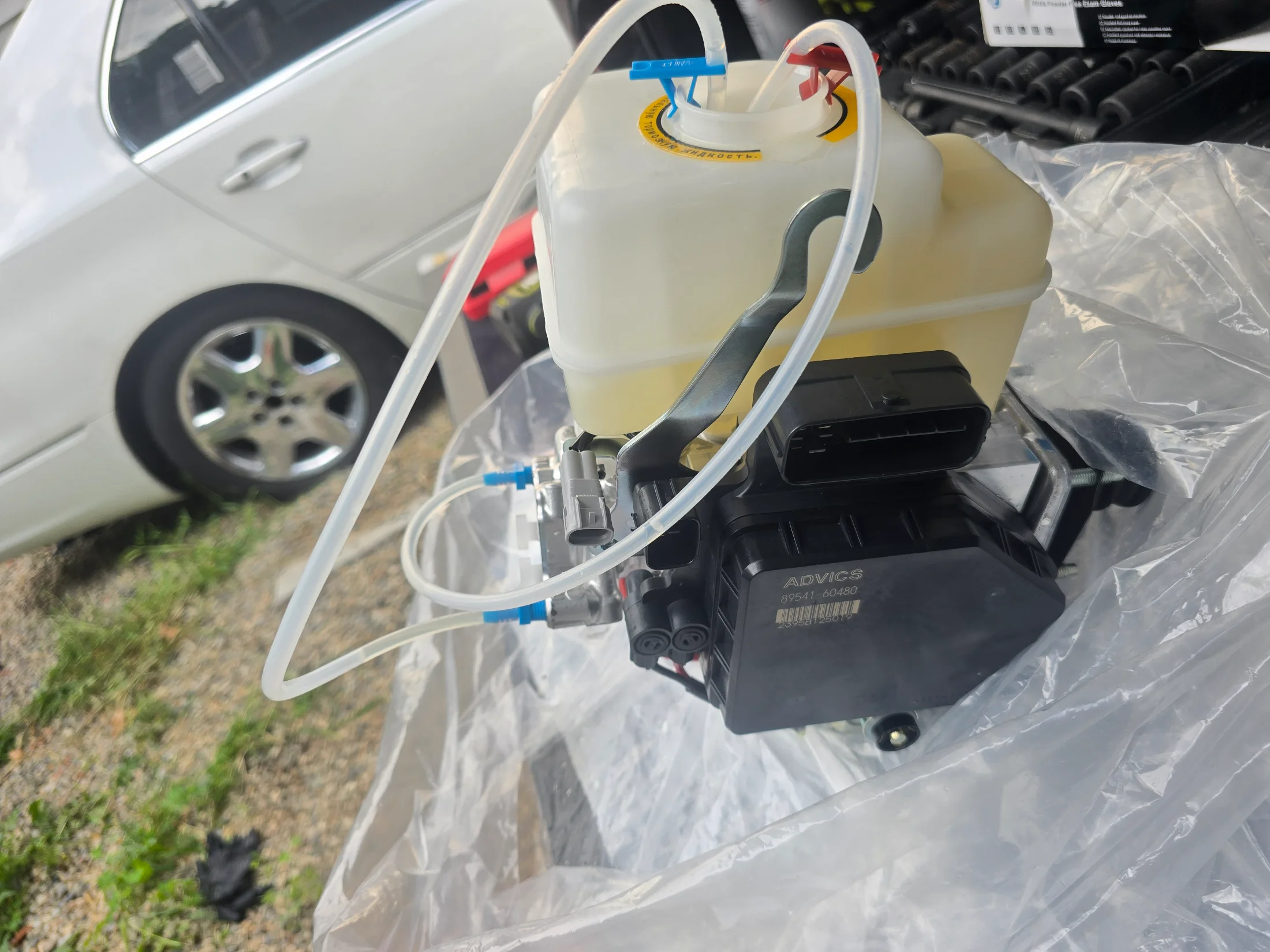

I am going to take a look at the cap and see if that cpuld be the issue before spending $1300 on a master cylinder and brake booster. I was watching videos online so just bench bleed the master, remove the 4 bolts and few houses for the brake booster install the master and brake booster then bleed the brake lines like normal?

Just ordered a master cylinder brake booster from bell lexus they had there 15% off, so saved $200 was only $1100 should be here wensday. I will do a write up on how to replace the master brake booster.

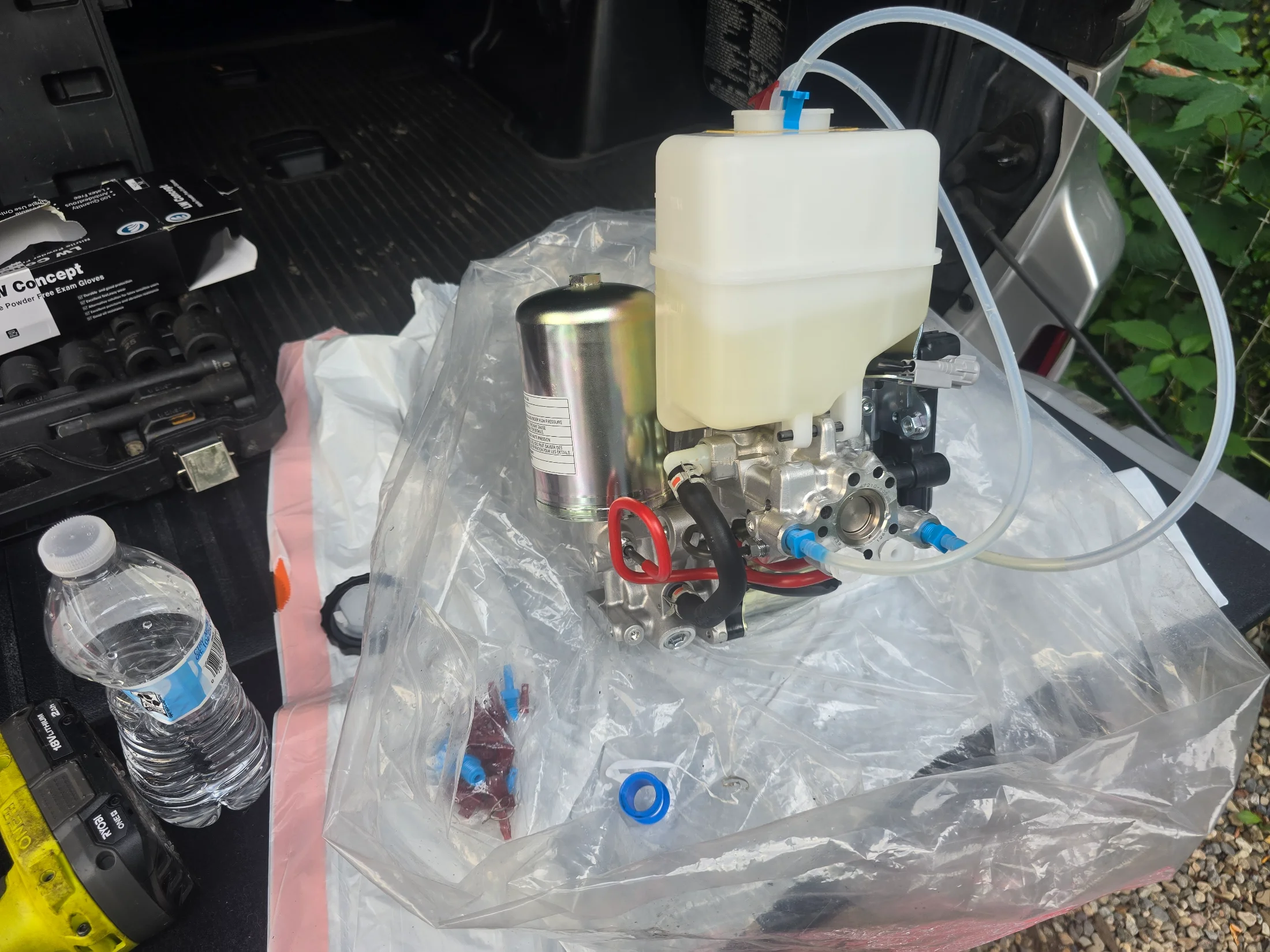

So update I tried bench bleeding it, spoke to bell lexus was told you have to use tech stream to bleed the master cylinder. Can I just pump the brakes and bleed using the calipers bleed screws.
The FSM does say you need to use tech stream. You can get a mini VCI cable and a copy of the software for $50 off ebay
I do have a scantool arriving tomorrow that does have the ability to bleed abs systems, I hope that will be able to take care of the issue. If not I will go online and get tech stream as you suggested. Thank you for your help.

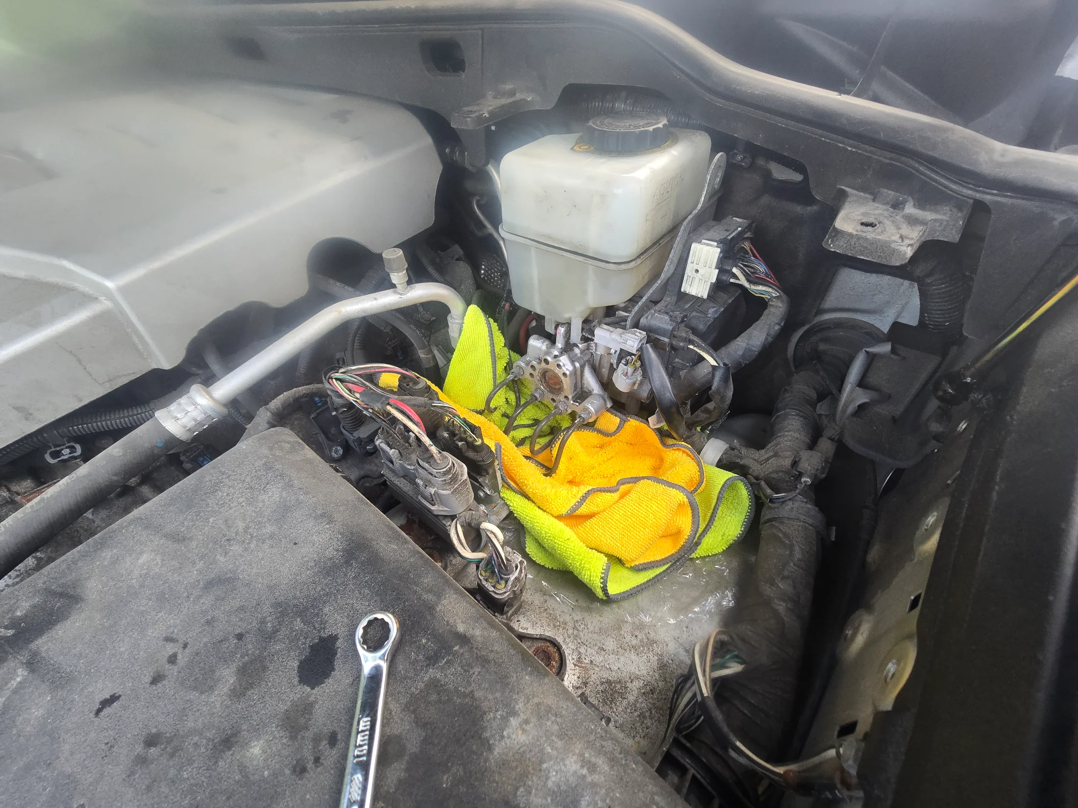

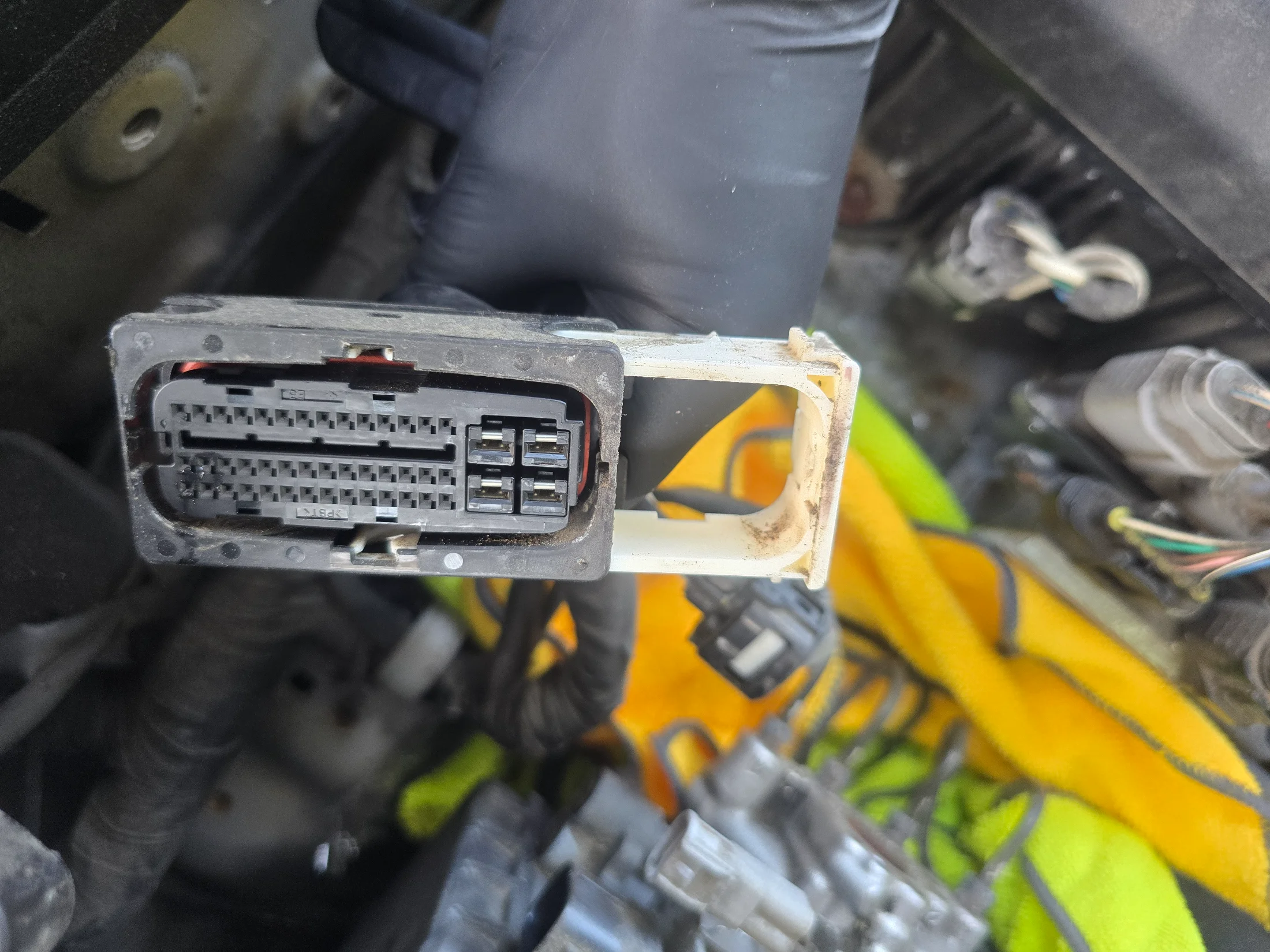

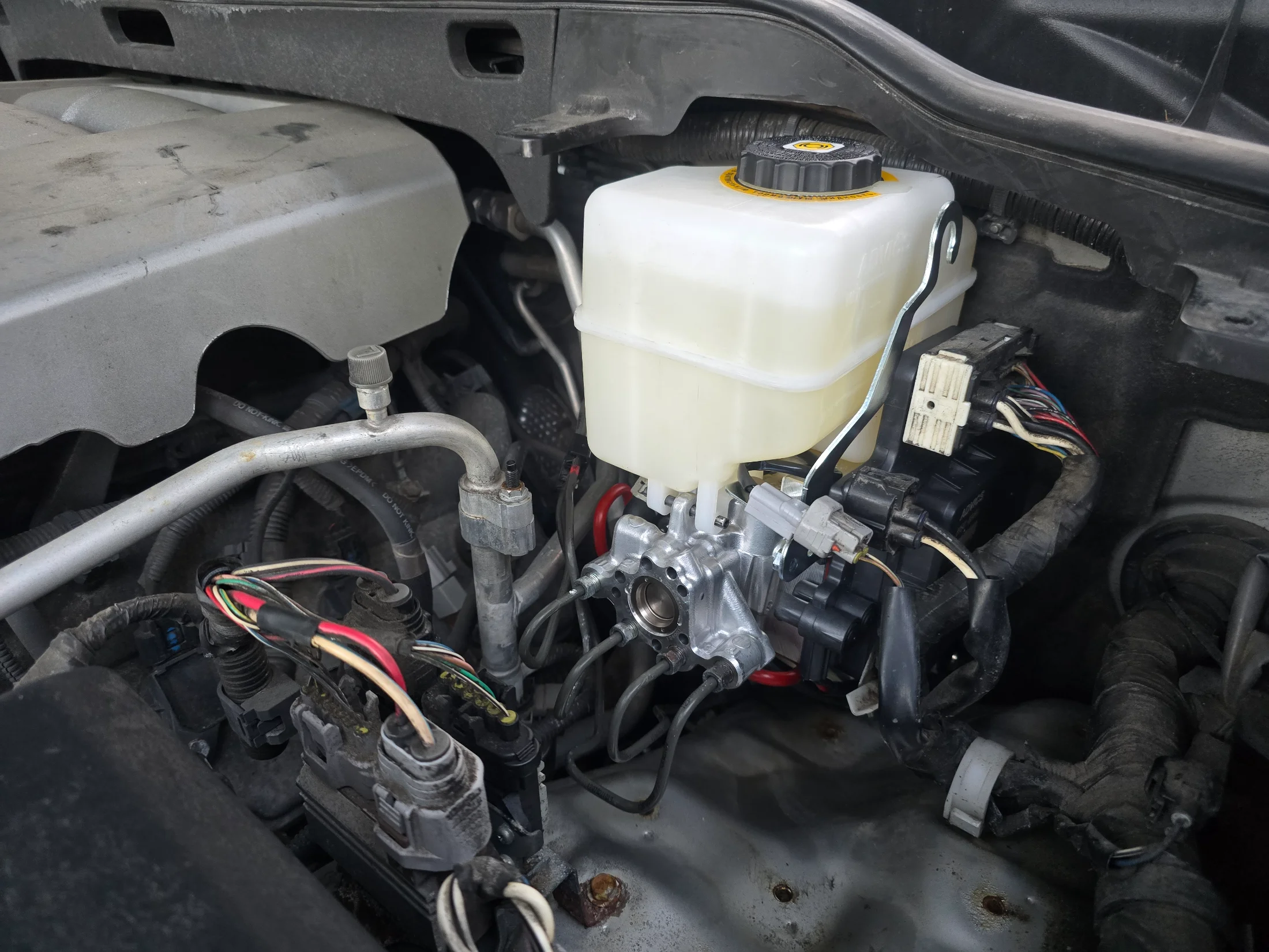

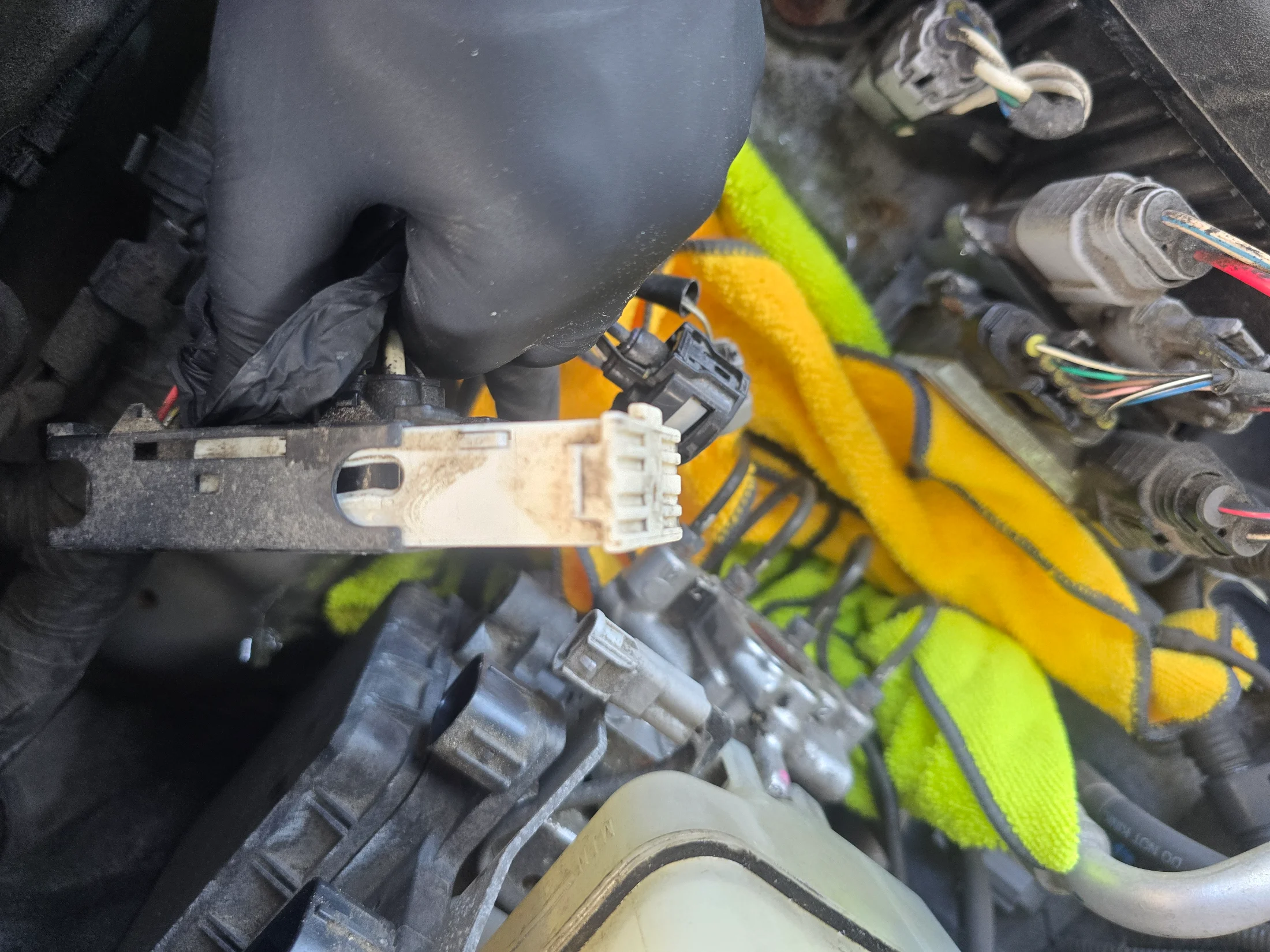

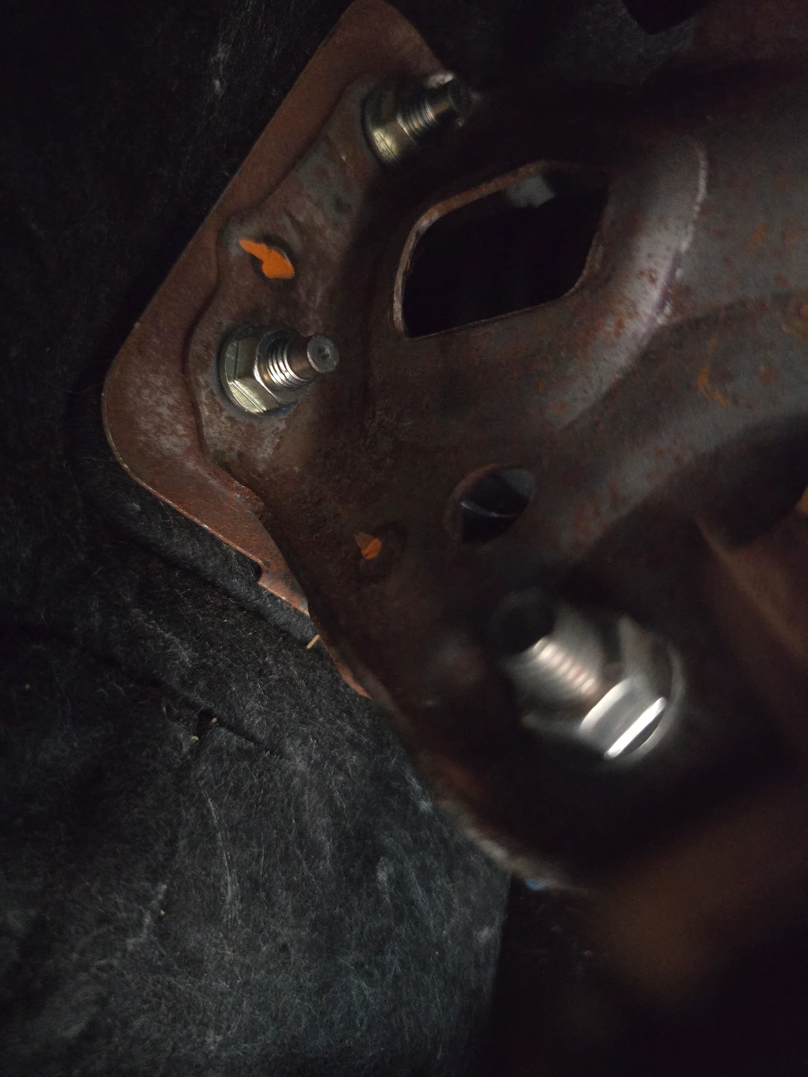

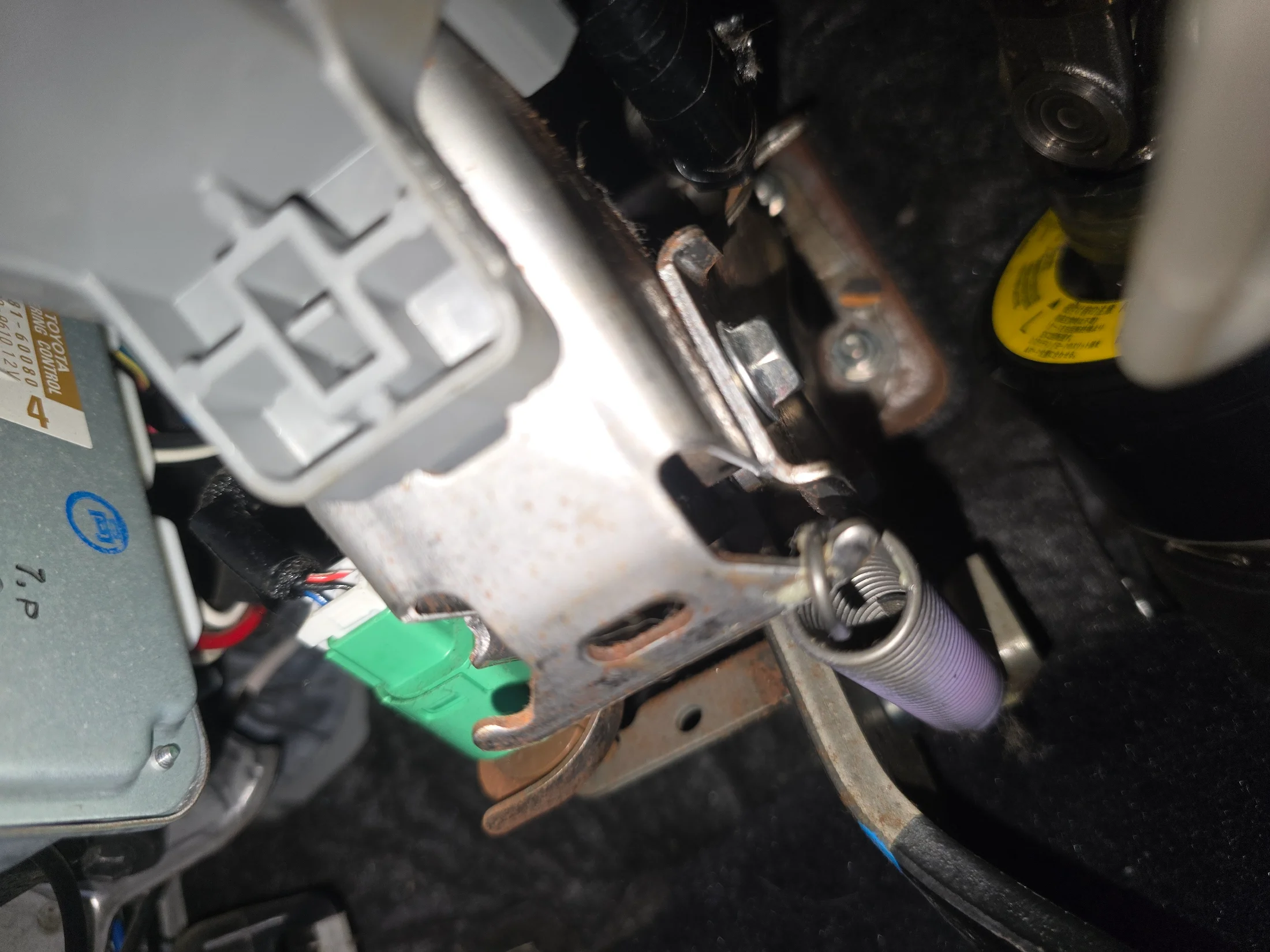

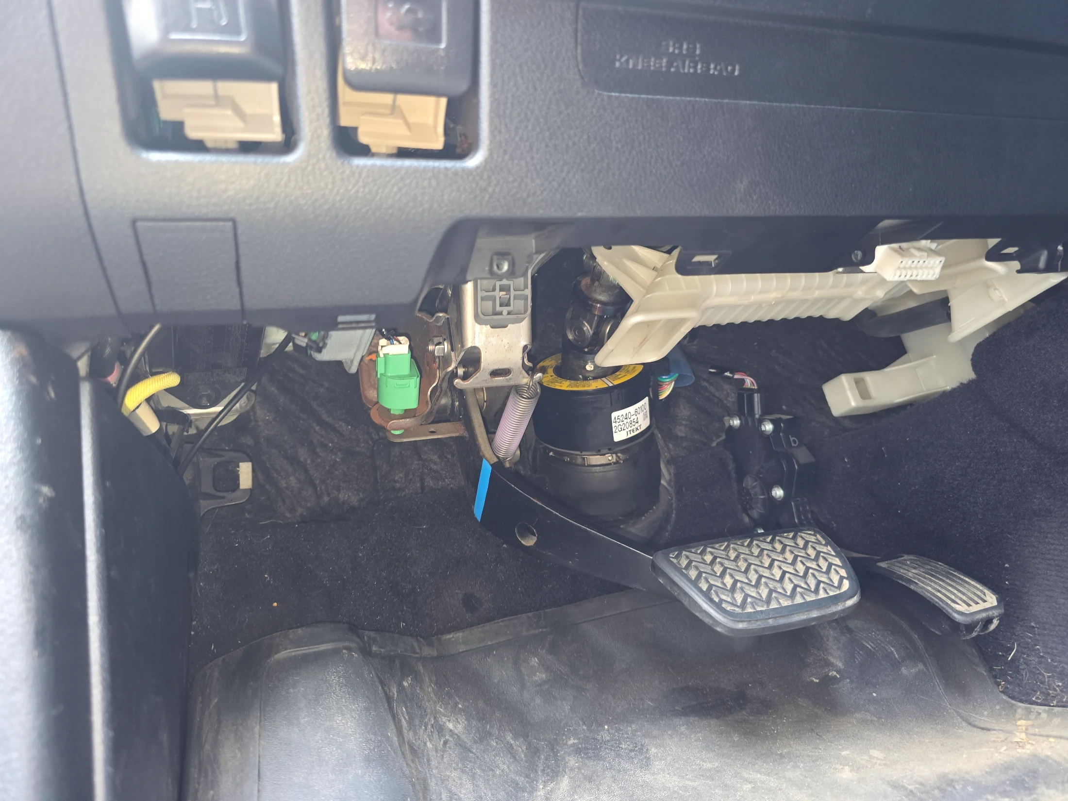

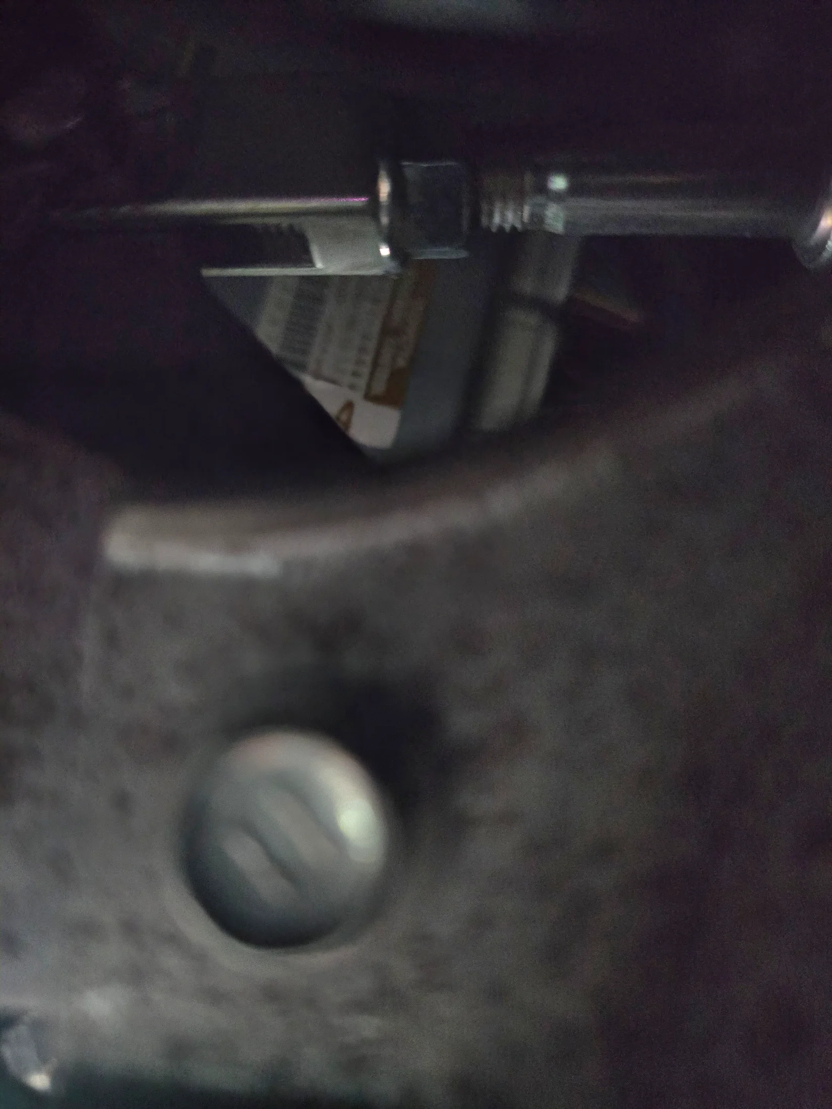

So here is a rough write up on how to do the master cylinder disconnect battery push on the brake pedal after its been disconnected. Remove plastic kick plate 2 philios head screws. Remove 4 bolts shown need stubby wrench 12mm with flex entension and 6 inch extension on rachet, regular 12mm wrench, and 12mm deepwell socket with 6 inch extention.

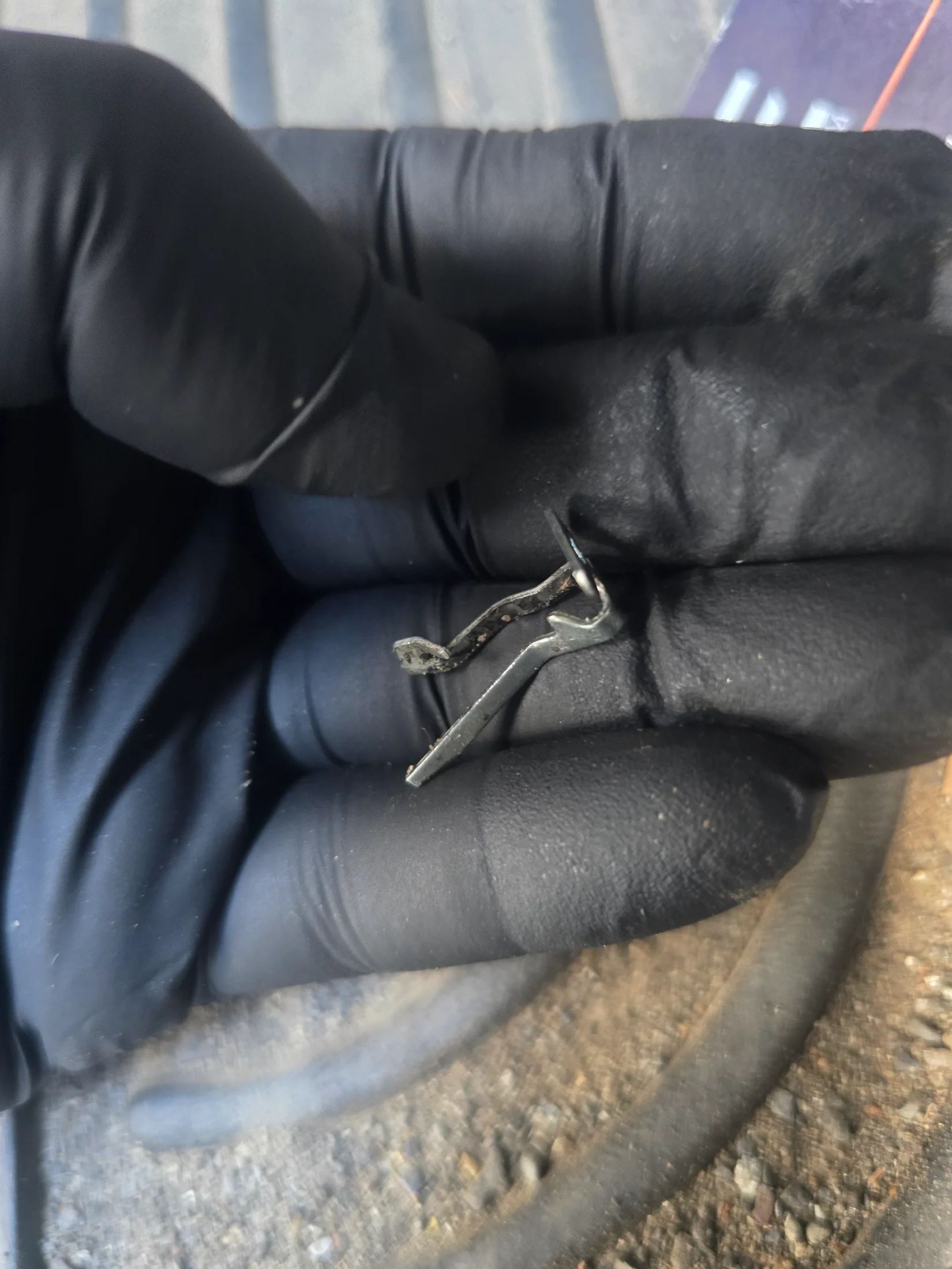

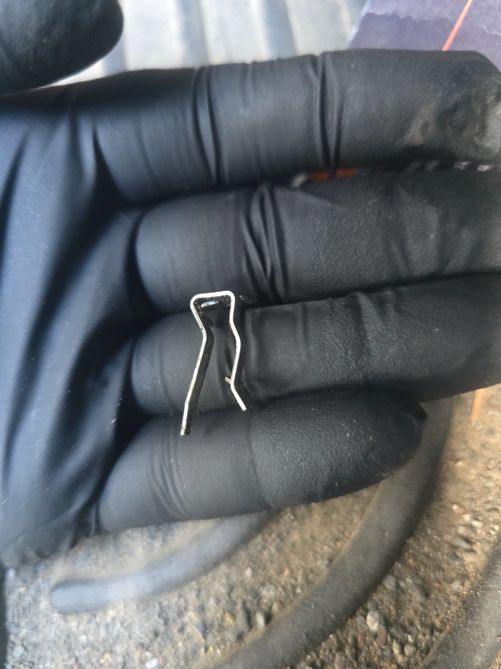

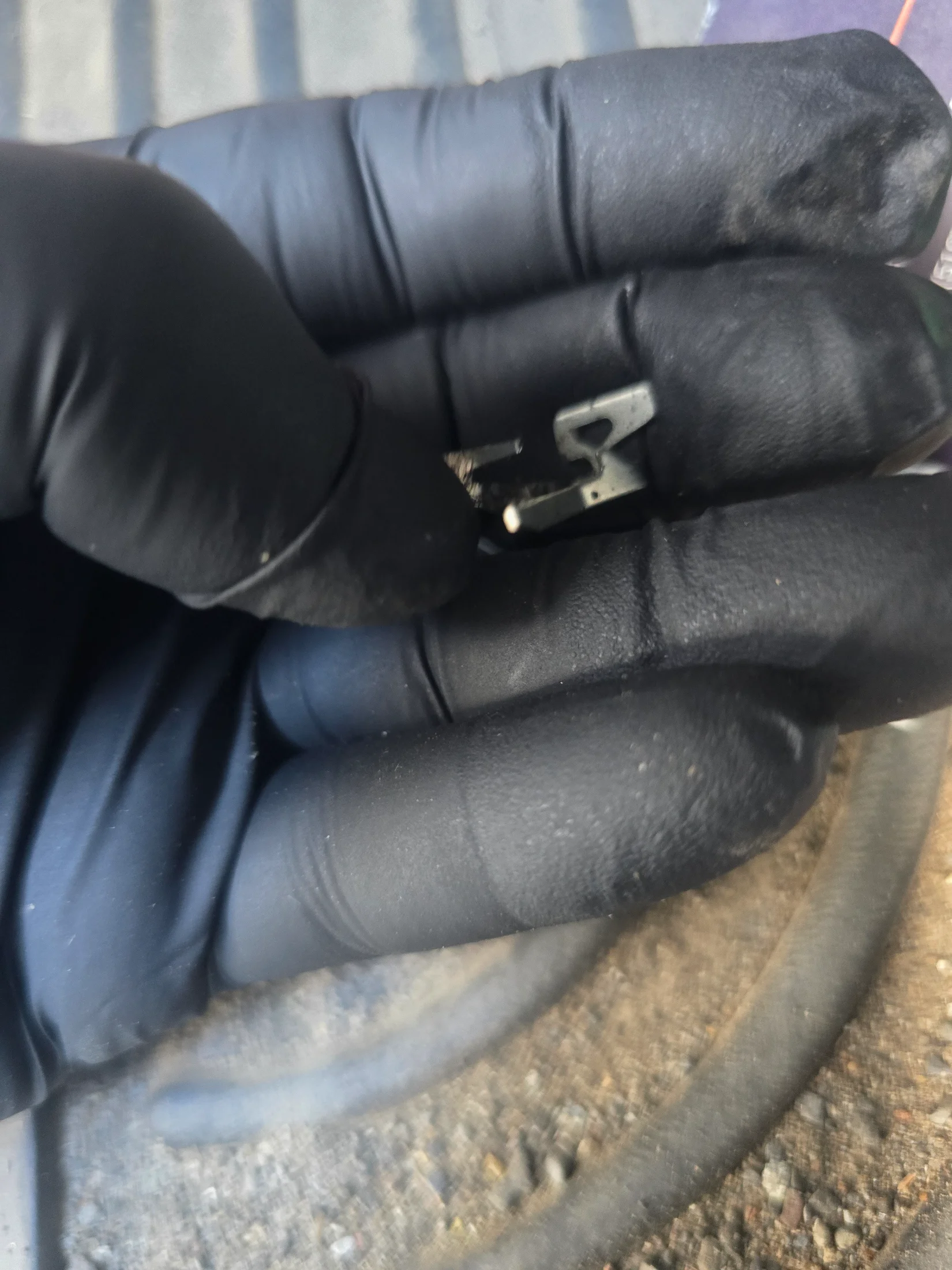

The pedal will have a bracket with a pin and a special clip on it you need 2 picks to get it put I recommend turning the clip upside down and removing it that way.
Put plastic down then rags underneath and round the master cylinder, put plastic on the driver fender of the truck. Remove all clips loosen 12mm brake lines and remove old booster push lines down while pulling booster up at an angle.
Make sure you rinse any paint that gets brake fluid on it immediately. Bench bleed the master cylinder install is reverse of removal. For the pin that connects the booster arm to the pedal put it in the left side first line it up with the hole in the pedal and push it through. Go over the top of the pedal when doing this. Bleed brakes like normal start with rear passenger, then rear driver, fromt passenger the driver front.

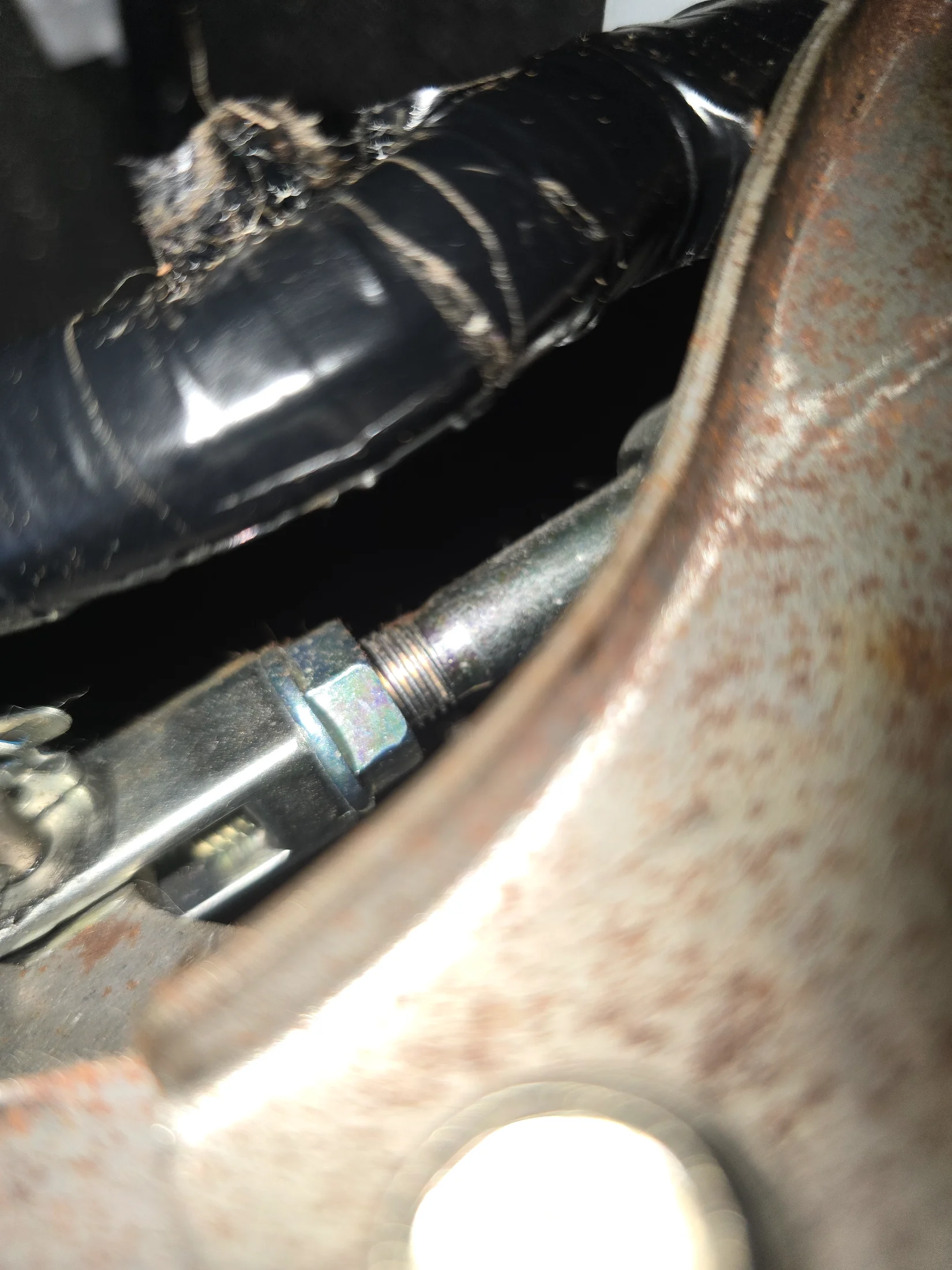

Its possible I may need to lengthen the arm that goes to the pedal maybe its still engaging part of the way so the brakes are pressed down partially. I did not measure the lengths of the master cylinder/booster arm

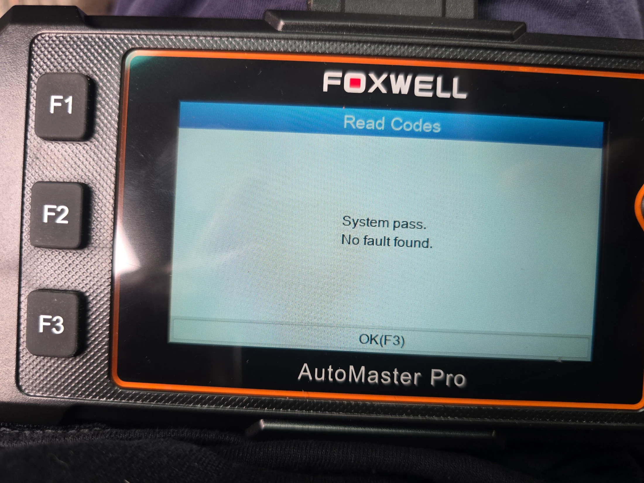

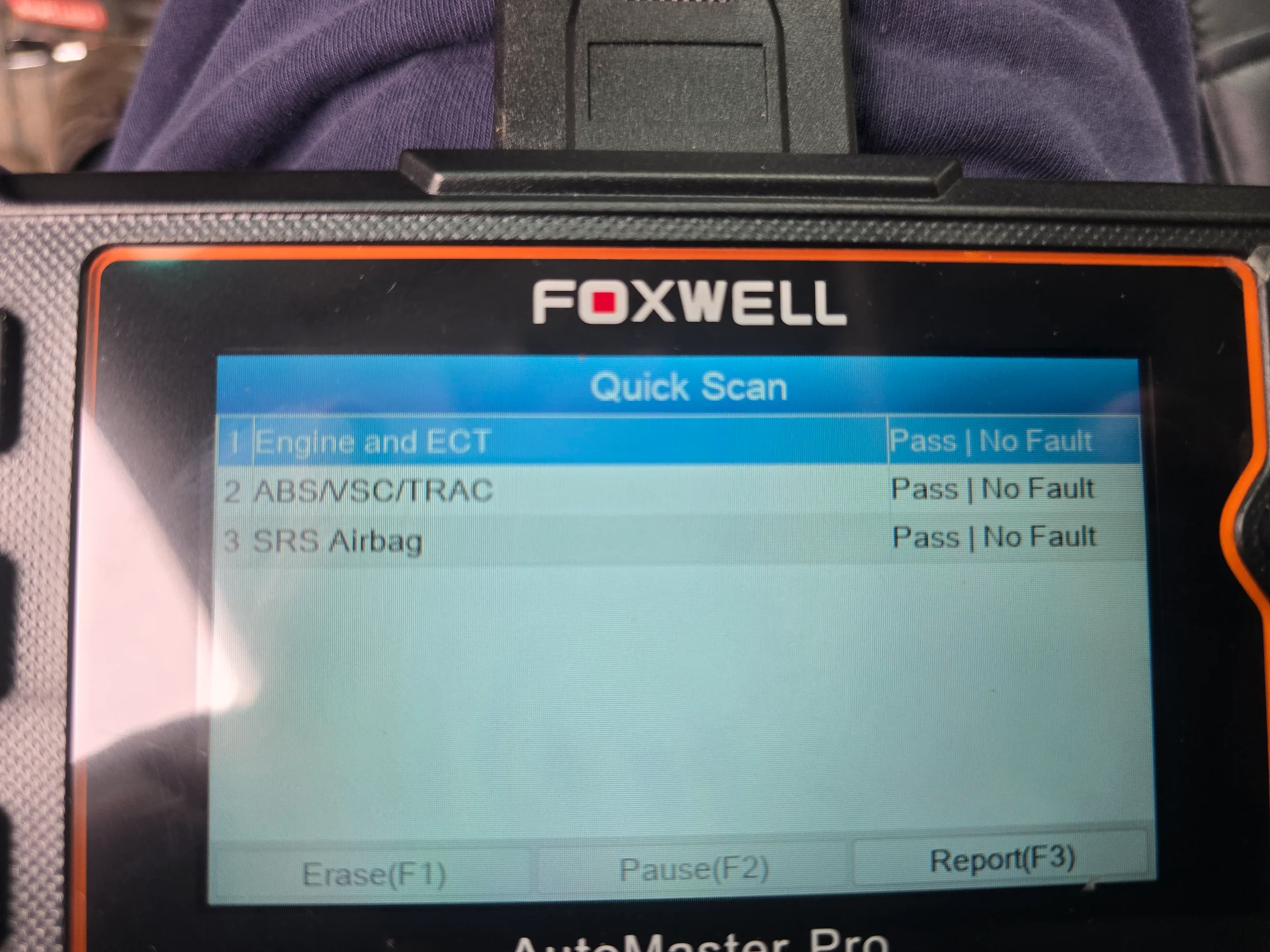

I cleared and read all codes there is nothing, I am going to check again for giggles right now.

So rod length is the same, there is no stored codes or pending codes I am stumped. The truck did this with the original oem calipers also that's what led me to replace all 4 calipers.
