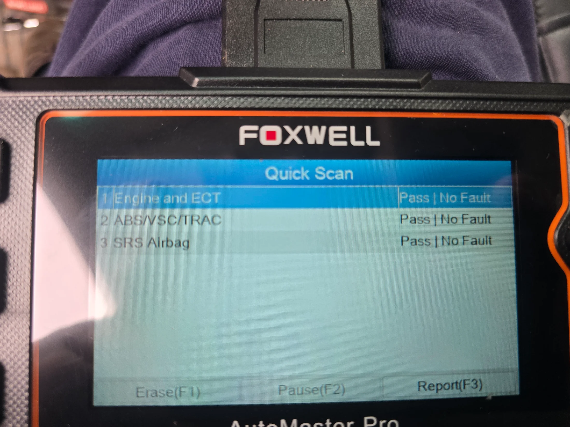

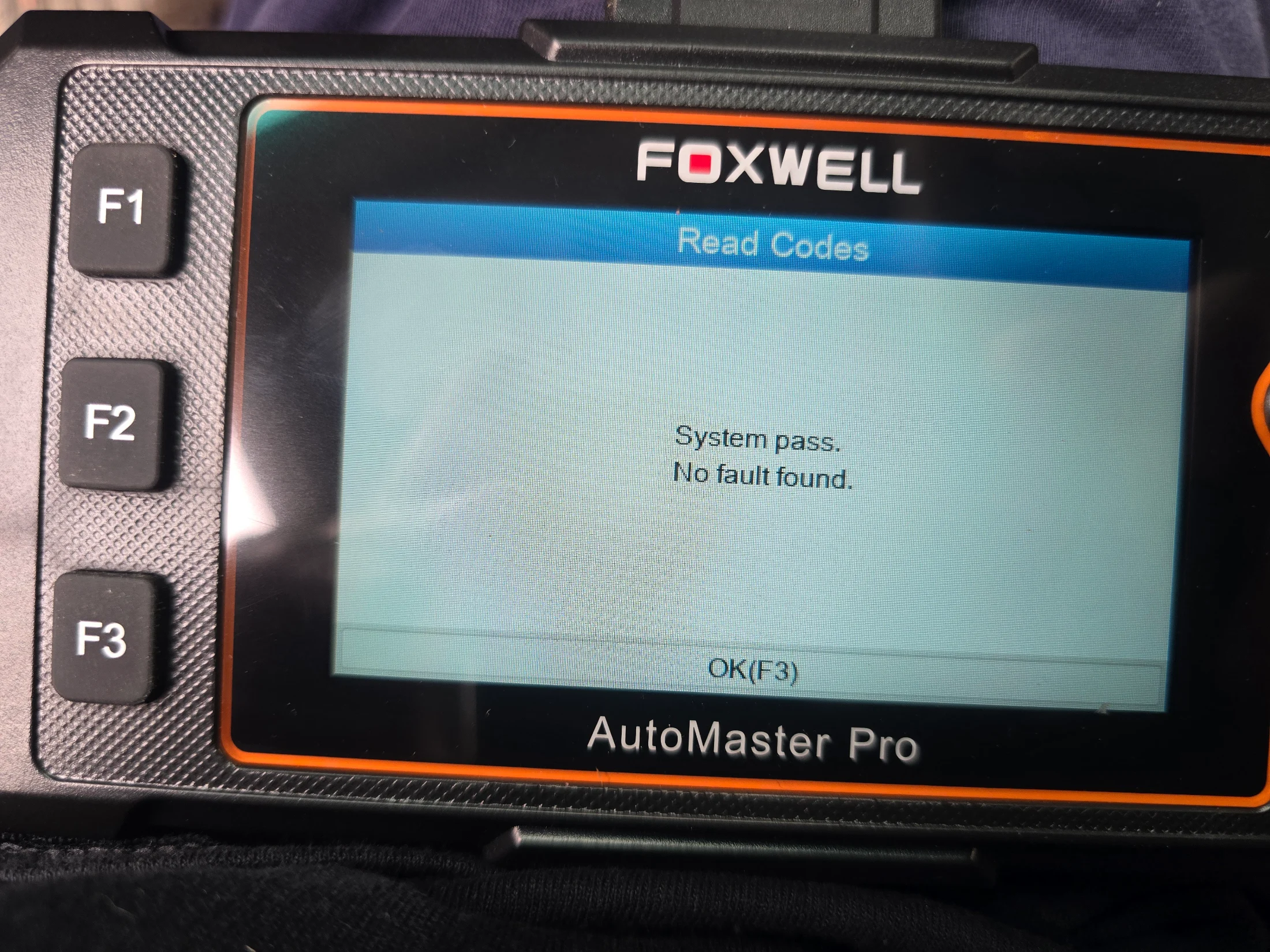

So rod length is the same, there is no stored codes or pending codes I am stumped. The truck did this with the original oem calipers also that's what led me to replace all 4 calipers.

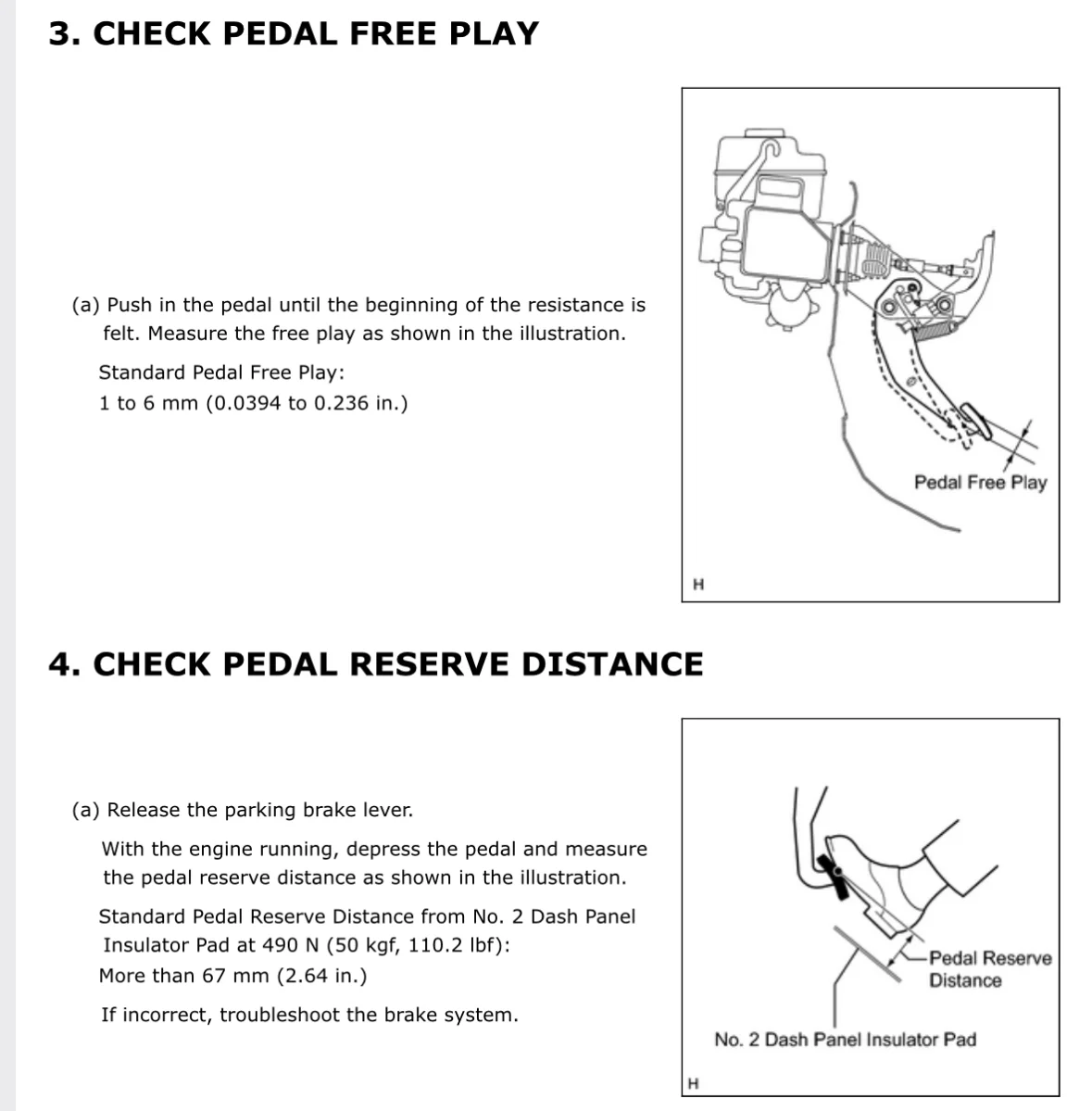

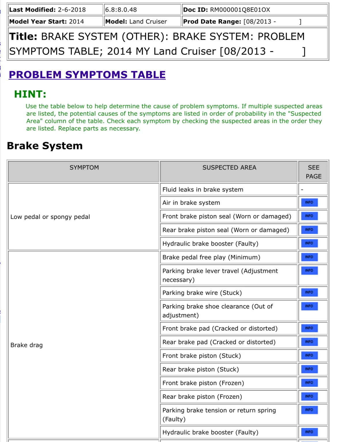

If it’s all 4 that are hot, not just the rear, the FSM says to check pedal free play. Otherwise the only commonality is the booster you’ve already replaced.
