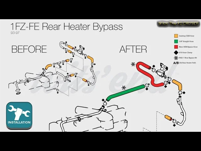

I will check under the passenger seat, now that I know if it’s location. Could have been bypassed by prior owner as I’m not original owner. I’m assuming the bypass would be noticeable either at the heater core under the passenger seat or in the engine compartment near the firewall? Curious is the rear heater core a common failure point, hence why someone would bypass?
Rear heater bypass can be seen at the firewall, yes. In a 1FZ, you'll see it next to the heater control valve and valve cover on passenger side.
People bypass the rear heater because it simplifies the cooling system by eliminating a bunch of connections and a few small pipes, and it's easy/cheap - and sometimes parts of the rear hard lines are in bad shape, so they can be a failure point. Some are not exactly easy to replace with the engine in. In my case it was the smaller sections under the truck that were very crusty. I never need the rear heater, so it was a very easy way to deal with it. I've eliminated failure points for now & can choose to replace things at my leisure, if I ever want the rear heater.

It isn't the rear heater core that is the problem, but the lines going to the rear heater. In the rust belt US States, those metal lines rust out really fast. Most don't know those metal lines are there until they start losing coolant. One needs to remove the engine to replace the upper metal line, so it is easier to bypass.
Mine did rust through, and I did bypass it for a long time. I now have replacement lines installed since I pulled the engine for a swap.
