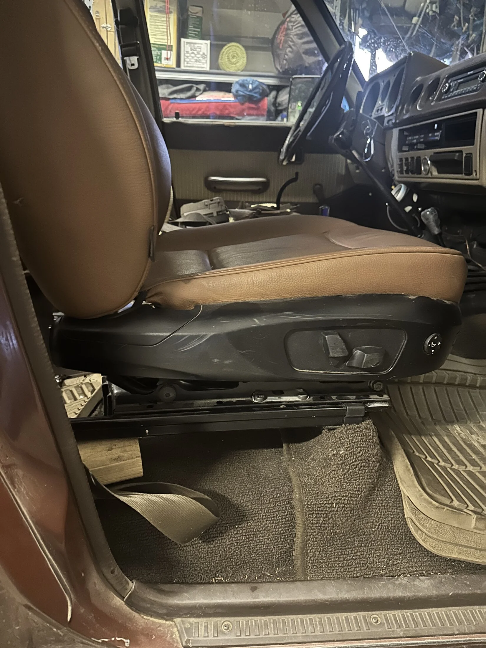

Hi All, I’m in the middle of a seat swap that will more than likely require me to lose the rear heater. I tried putting in the seat on the tabs on the floor and it sits up pretty high. I’m 5’10” and my head has less than an inch of clearance.
I’ve chatted with @NookShneer and he has been super helpful. I wanted to see if anyone had suggestions on these questions.
I would like to keep the heater so I’m going to move it to the center console area. For now I’m planning on capping the lines off under the cruiser with 1/2 inch heater line. Is there a way to do this without pouring a bunch of coolant out? I’m looking for some tricks on this.
As far as moving the heater goes, mostly I’ve seen people use 62 heaters. Is there a reason I should go this route over my current 60 heaters? More than likely I’ll need to go with a tuffy or smitty console and modify. Let me know if you have any suggestions on this too. Thanks a bunch for your help.
