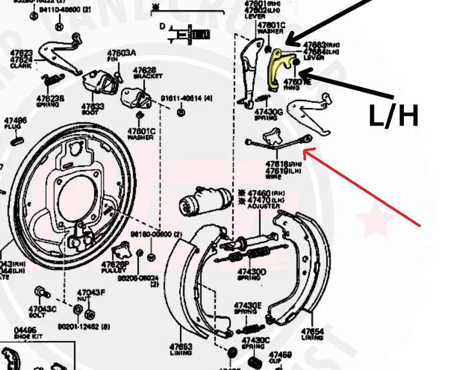

You mean like for like correct? Just refurbishing your rear axle, not trying some kind of frankenstein disc setup?
The only points I offer are:
  • Consider a delete of the auto adjuster mechanism.. it kinda sucks
  • I see you're in Australia.. so avoid the Online Auto Parts rebuild kit for rear drums - the little cable I have highlighted below (red arrow) breaks within the first few uses on their kit..
