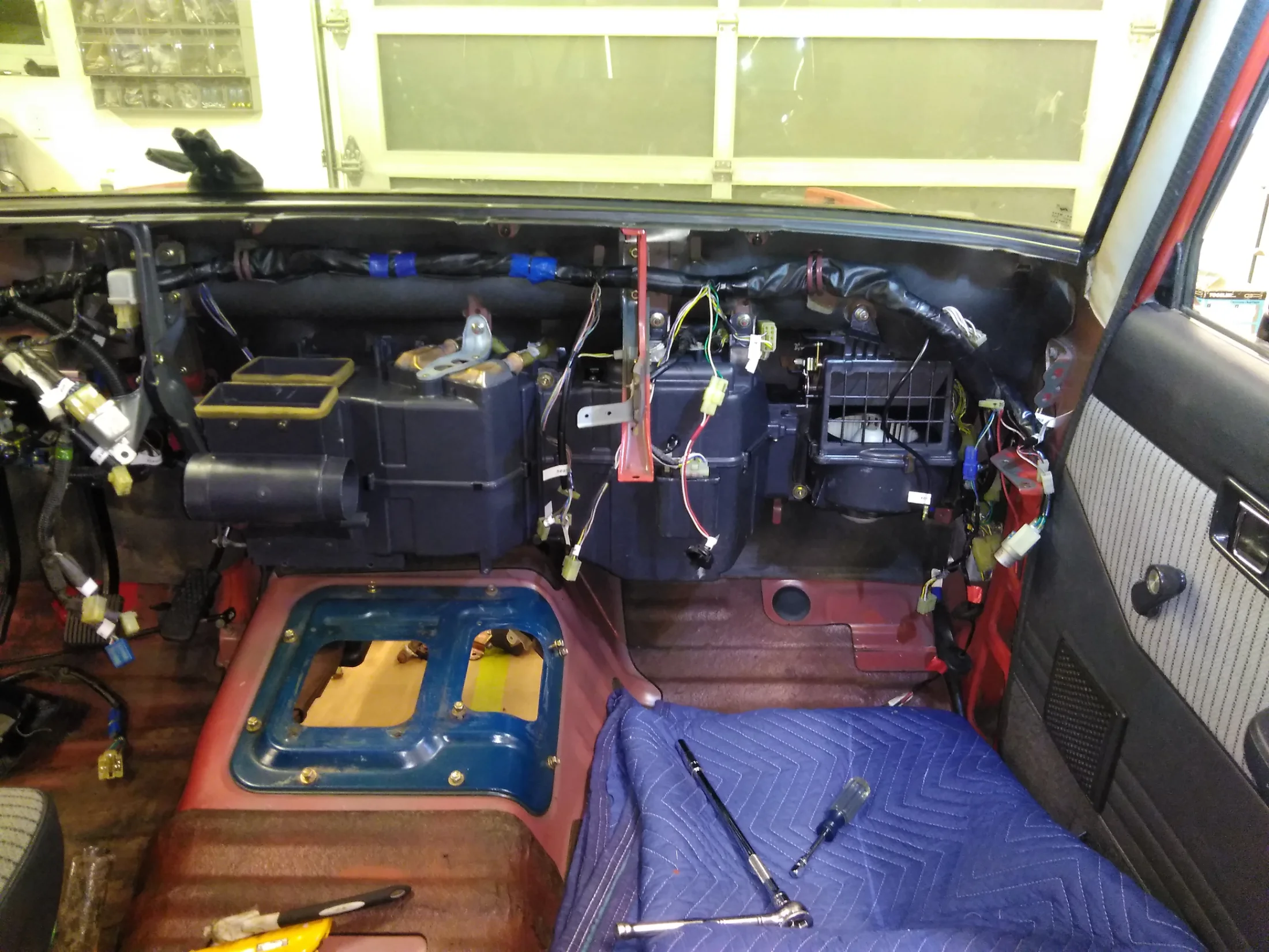

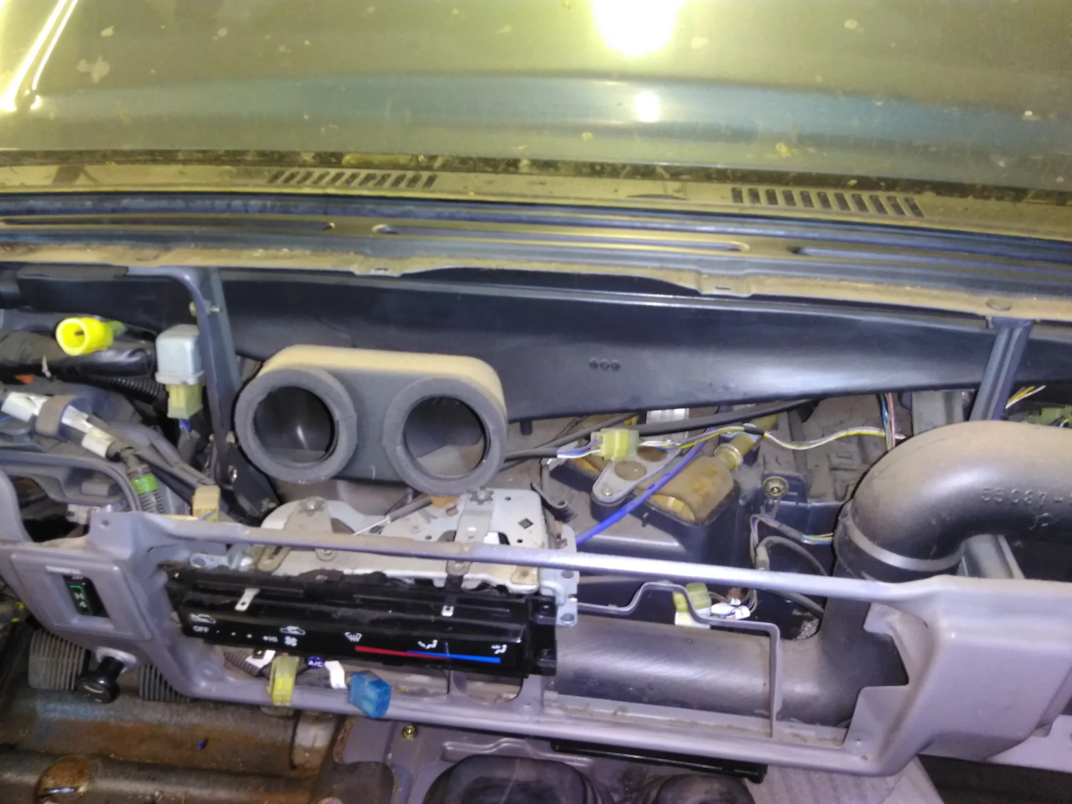

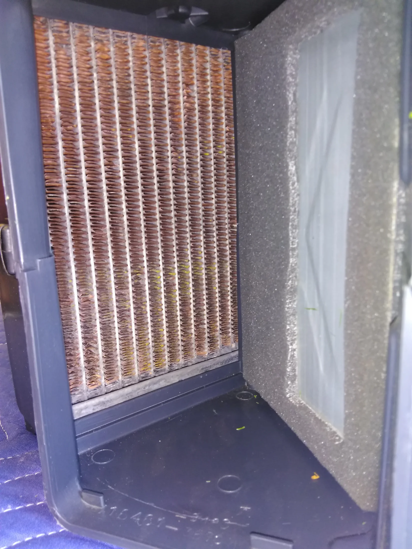

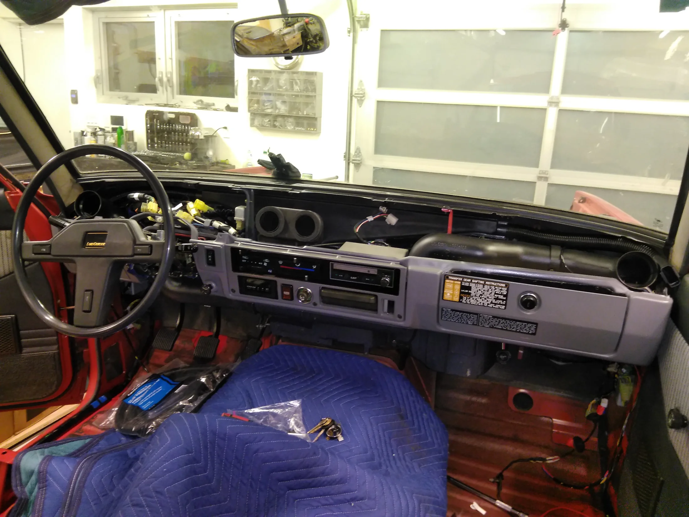

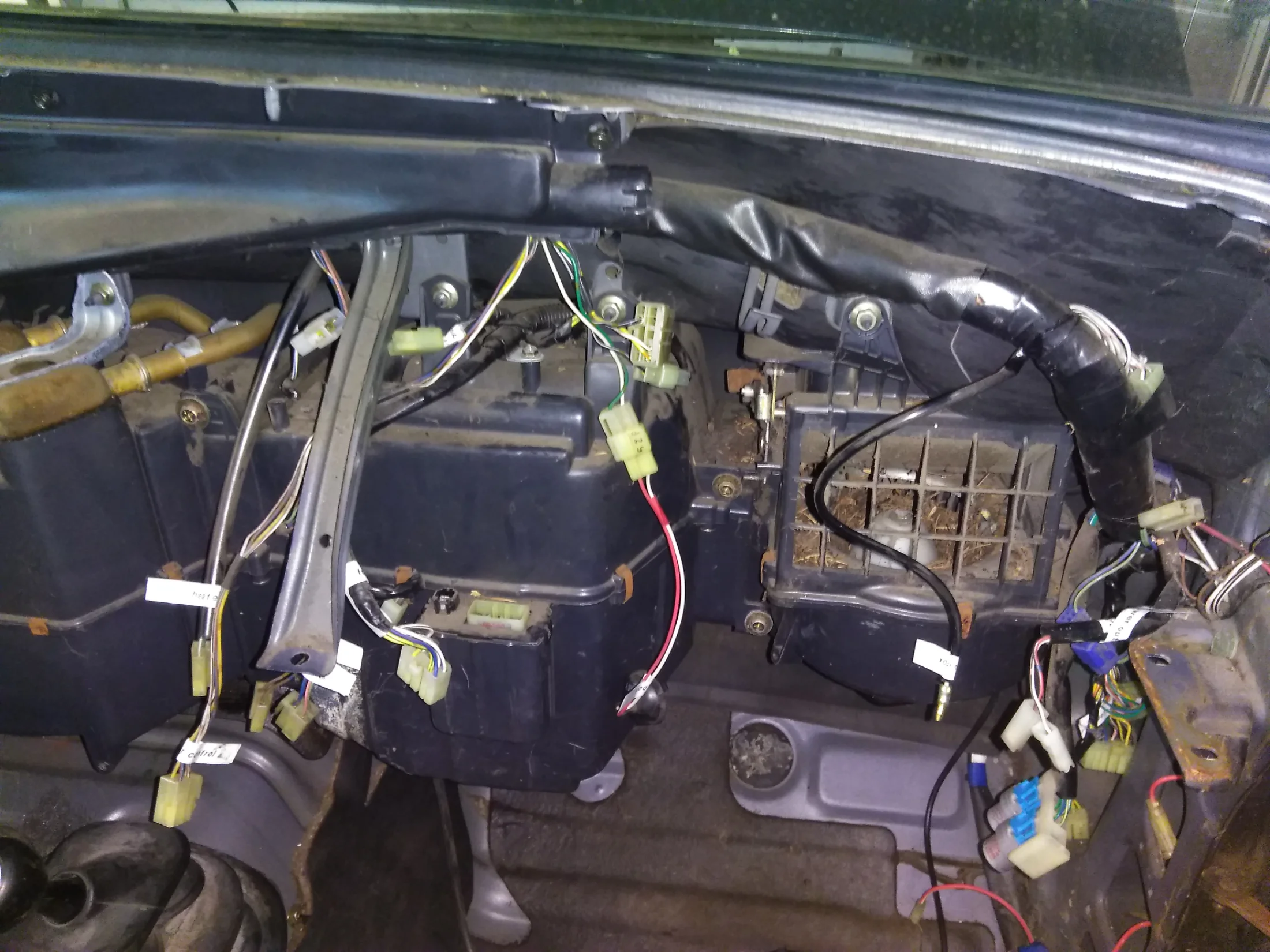

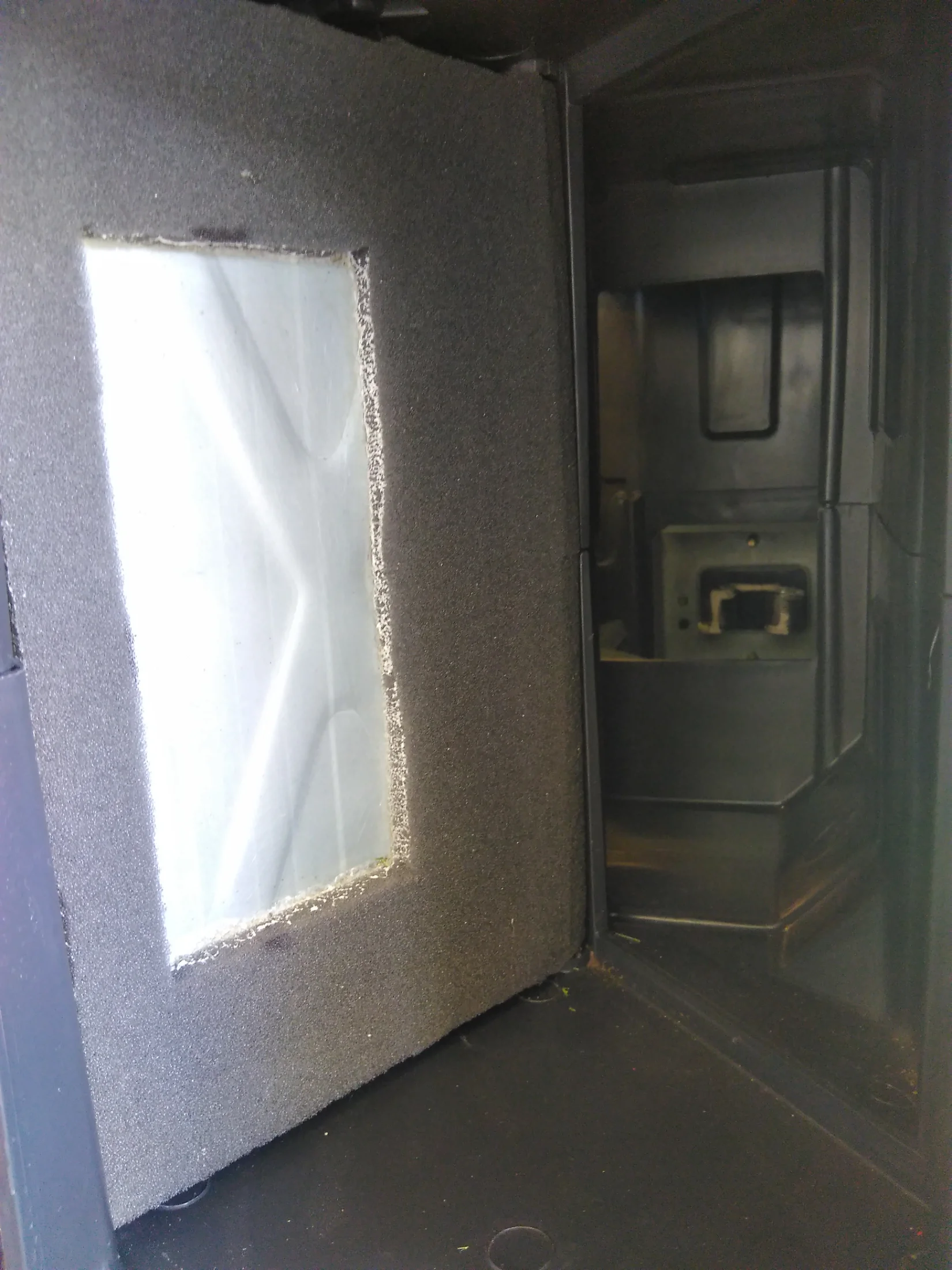

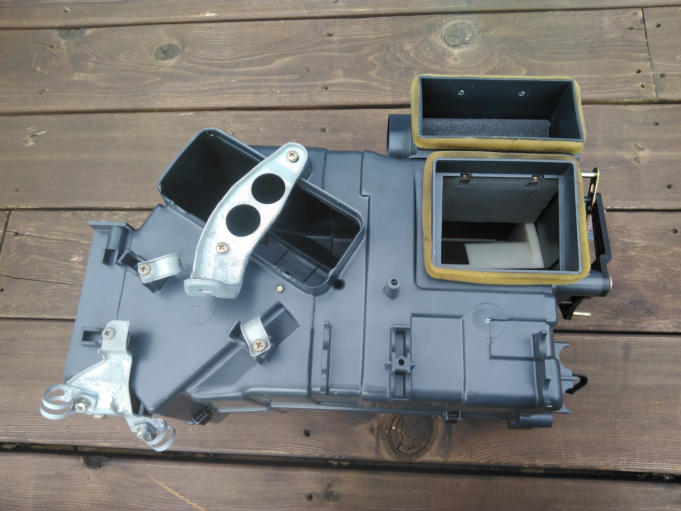

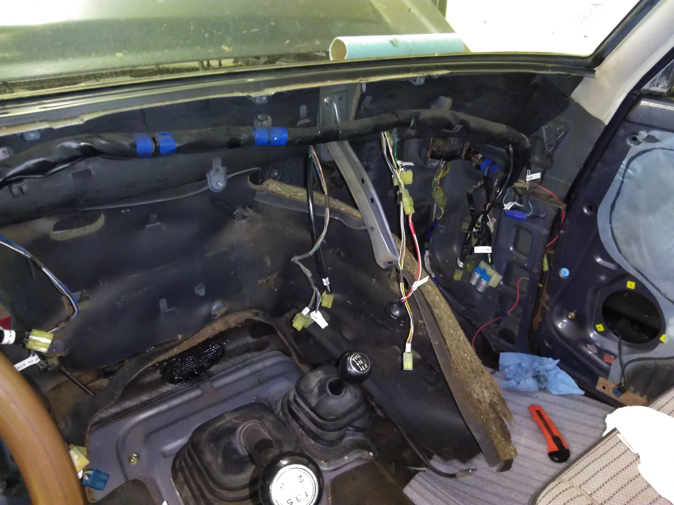

Honestly it’s a pretty simple affair. Just label bag the screws and bolts as you take things apart. There are no surprises. I have a ton of pictures of mine as it came apart so I can probably help if you get stuck on reassembly. And it’s a worthwhile project. I would recommend getting some 1/4” grey foam before starting so you can redo the flaps in the heater and A/C boxes. When I get a minute I’ll post up a few pics of the process.
Here's a few. I swapped a diesel from a blue HJ60 donor truck into a red FJ60, that's why you see 2 different colour trucks

Agreed. Once you get going it’s not that complicated of a process. When I did mine the Haynes manual was actually the most helpful. And there won’t be a better time to clean and refoam your ducting. I actually put a new dash pad and glove box in at the same time.
