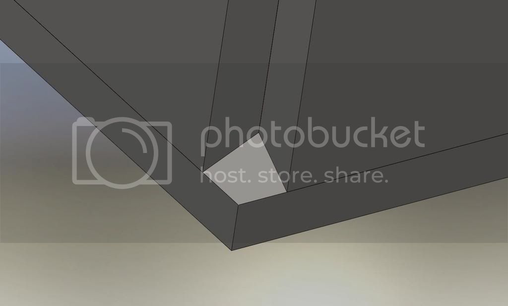

Hey, looks great. Did you use Solidworks? I saw that you got a weight calculation, so that's why i'm thinking SW. I've been playing around with bumper designs in SW, too. I'm trying to figure out the best way to design the parts so that I can also just send it over to the cutters and then go pick up my bumper puzzle.
How do you determine the sizing for the angled pieces on the ends? Did you have to grind angles onto them, or did you just make it work?
I'm curious because if an angled piece is cut square, it'll end up slightly bigger than it should be, which could affect how everything lines up in the end. Maybe that's only an issue on really complex plate shapes.
Just wondering the best strategy/method for determining sizes to be cut for angled plate pieces.
Not sure I understand what you mean by the angled parts. The way I did it was make my upper plate (the one with the two holes in it), then made the vertical pieces (both left right and middle). Then created a plan with points to get the general shape. Kinda hard to explain. All the pieces you see were drawn in CAD then exported to the CNC plasma cutter. Circle the parts you are questioning and I will try to explain better.

I'm referring to the lower angled pieces going from the left and right vertical pieces, down and in towards the truck and the bottom plate of the bumper.
Looking closer at your first pics, I can see that you left an area to fill with weld where each piece meets along the top plate and vertical pieces.
I have a woodworking background. Where you can't fill a gap with wood, then grind it smooth. (ok you can if you use wood filler, and sand and paint it)
Ideally, to build a complex shape with no filler and with compound angles you need to shape the edges of some of the plates on an angle such that they join together perfectly.
I guess I need to "get" the concept of filling gaps as you weld. So, this is how I'm treating some of the angles on my SW model.
The plates are cut square, and then I'll fill with weld?
Also, what's the optimum gap that isn't too big/too little for welding and achieving max strength and weld penetration?
