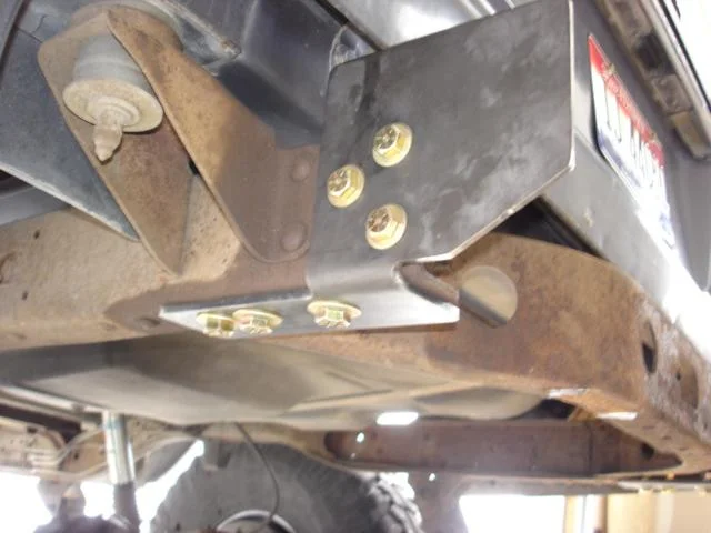

attachment.php
Can you get me some more detailed photos of this area for me? I'm trying to figgure out how I can account for my 2" body lift when I do the install.
So what exactly would you like pictures of. I could take a pic of how the top edge of the bracket comes to the bottom edge of the tailgate. Is that what you are after? Really, the frame and bracket dimensions set the position of the top of the bracket.
Not sure. Can you think of a way to space the bumper up for a body lift? Is the bracket built in a way that it sets the bumper height off of the bottom of the frame, and that the bumper can not be spaced up? Any way I could move the brackets to the inside of the frame, and put a 1.5"-2" block in to move the whole assembly up? moving the brackets inside change the scale of the angles of the bumper?

I'm still very interested in the bumper. A few more questions before I can commit.
1. Concerning the bumper spacing with my body lift: Does the Top plate (the ones with holes for spindles) weld to the top edge of the bumper bracket I posted in the picture in this post: IH8MUD™ Forums - View Single Post - Rear Bumper Build
"Any way I could move the brackets to the inside of the frame, and put a 1.5"-2" block in to move the whole assembly up? moving the brackets inside change the scale of the angles of the bumper?"
