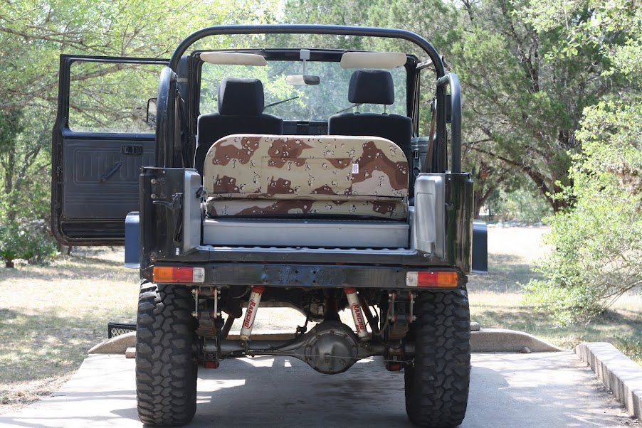

Need some help with this one please. Just picked up (3 weeks ago) a 72 FJ40 with SOR roll bar. Wife want's a bench seat in the back and ordered the CCOT one. It is really nice but we want 3 point harness back there. Who has installed some? What manufacturer? How did you connect them? I looked around using the search but didn't really find exactly what I was looking for. Pictures would be great!!

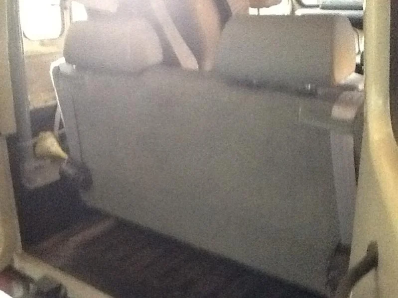

I've had the little passengers seat in the back of my 42 for over 4 years and am quite happy with it. I can say it fits 2 car seats well. The attached 3 point harnesses are great. My nearly 3 year old could sit safely back there without her car seat but I like the added protection of the car seat.
It's grey vinyl very close to my stock front seats. Will upload some detailed pics when I get a chance. Glad I bought it 4 years ago...$200 cheaper back then.
Negatives other than price are it's a pain to remove (mine's bolted to the floor). If putting it on top of drawers you might be able to rig some quick release mechanism. Also no fold and tumble so what little storage you had before is now nonexistent. The back of mine is a carpet material so with the top off it wouldn't shed water well.
EDIT:
Sh#*@ iPad pics
I have the 3 point like pictured above, they are mounted to the floor which is supported. I also want to add a bar above shoulder level. If you are concerned with fold and tumble space, make a bar that is removeable, they have the really nince steel clamps to mount it to the cage so they can be removed, not a quick process, but sturdy and has options.
