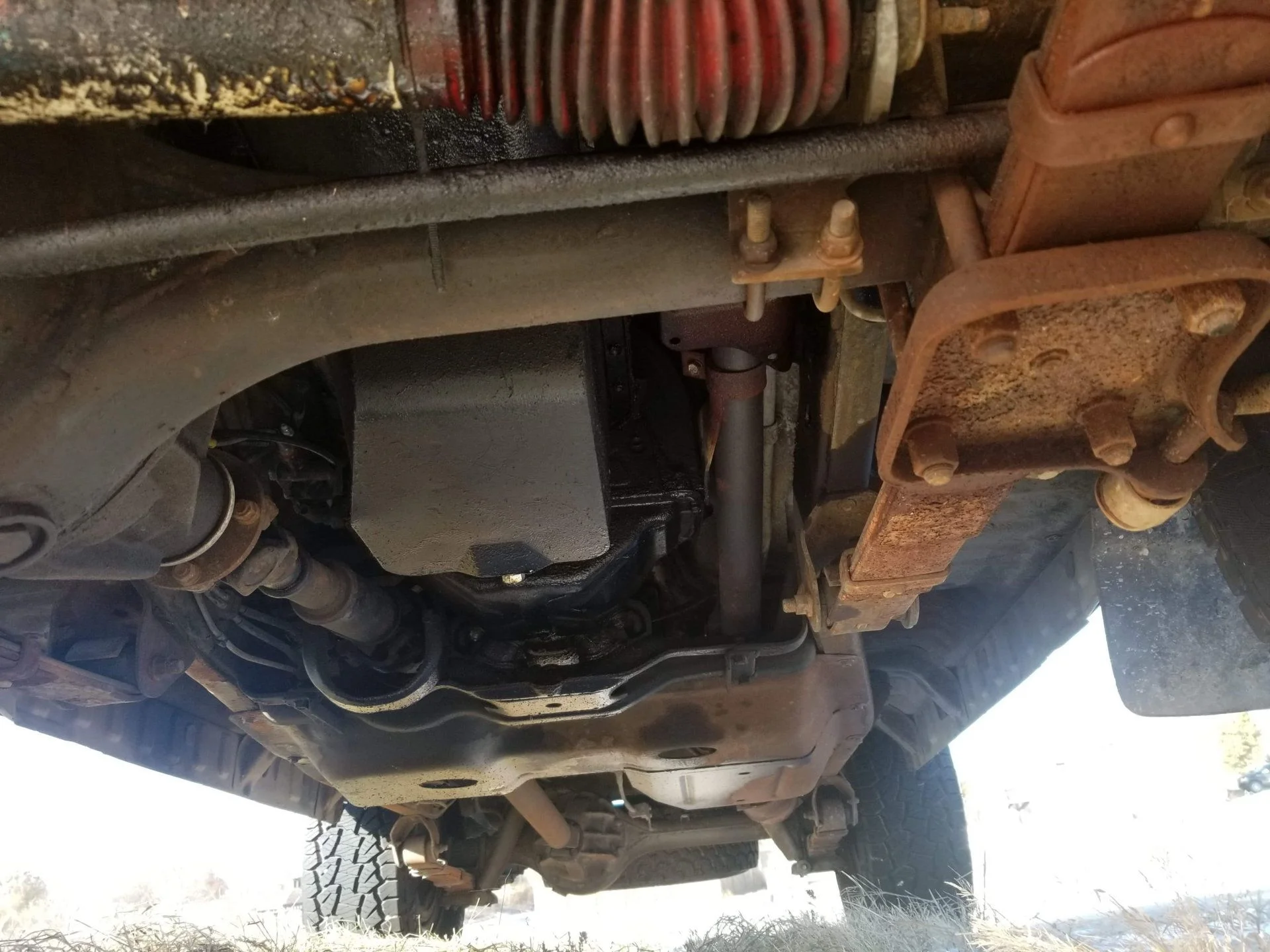

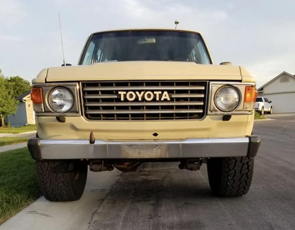

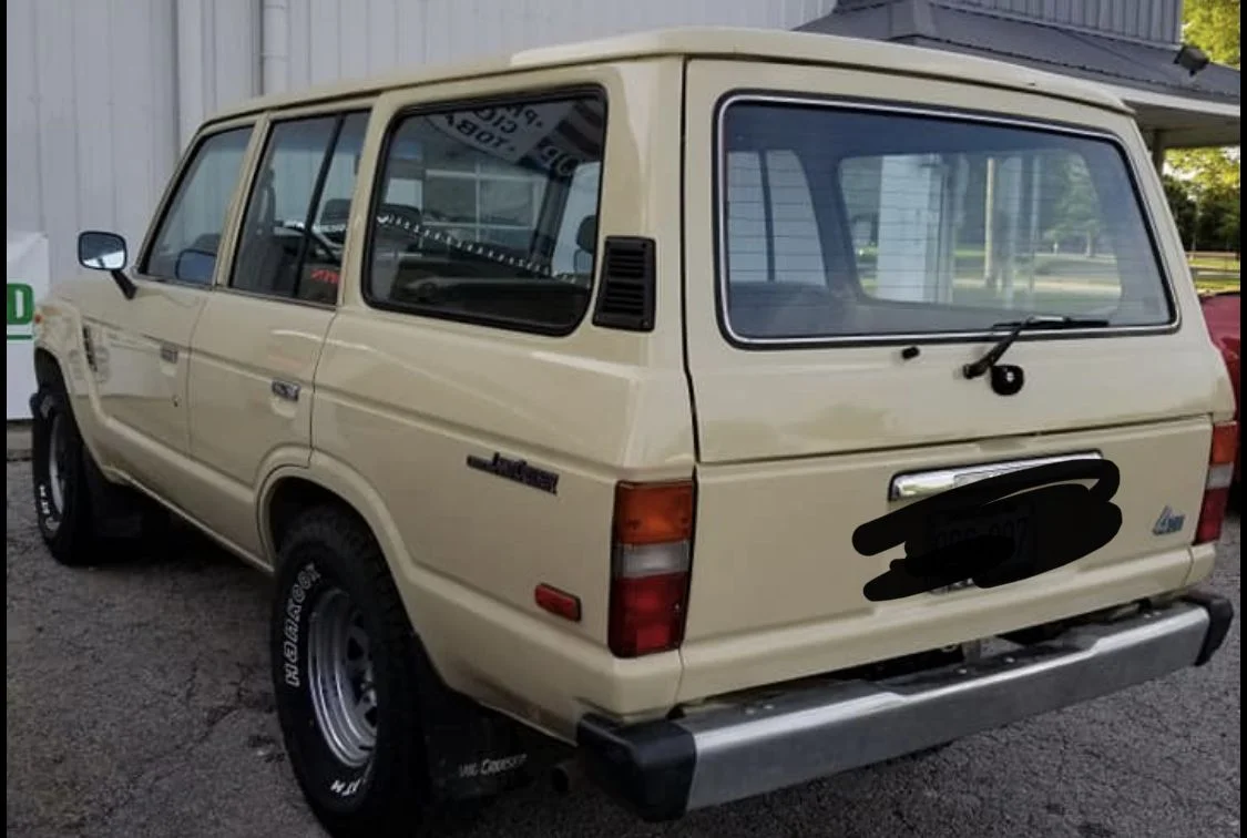

Hey guys, I’m about to purchase my first land cruiser and it’s a 1984. It has some oil leaks as it looks from the pictures of the bottom side of the car. I want to know what gaskets I will need to replace, How hard are these to replace, and are they expensive? It also has 172k miles on it and is in pretty great condition from the pictures I’m seeing. Runs well. I’m looking at paying $13k for it, that seems right for one in this condition that has sold on eBay. It has also had an engine rebuild and has been repainted. It has one tiny bit of surface rust, but that’s it. Let me know what you guys think. Just want to hear what you guys think as you have much more knowledge on these cars! Let me know if you would like to see more pictures or more info on the car.
Outside looks fine enough. Looks like the owner wasn't too interested in what was going on under the hood. Looks like nothing has ever been touched. Definitely give it a full tune up according to the factory manual (don't leave out steps) AND CHECK THE VALVE CLEARANCES. Guaranteed they're tight.

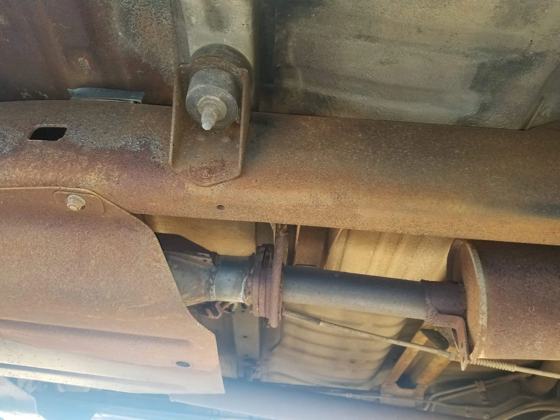

Looks nice. Suspension is saggy and will need replacing. Surface rust all over underside that will need addressing but it doesn't look deep.

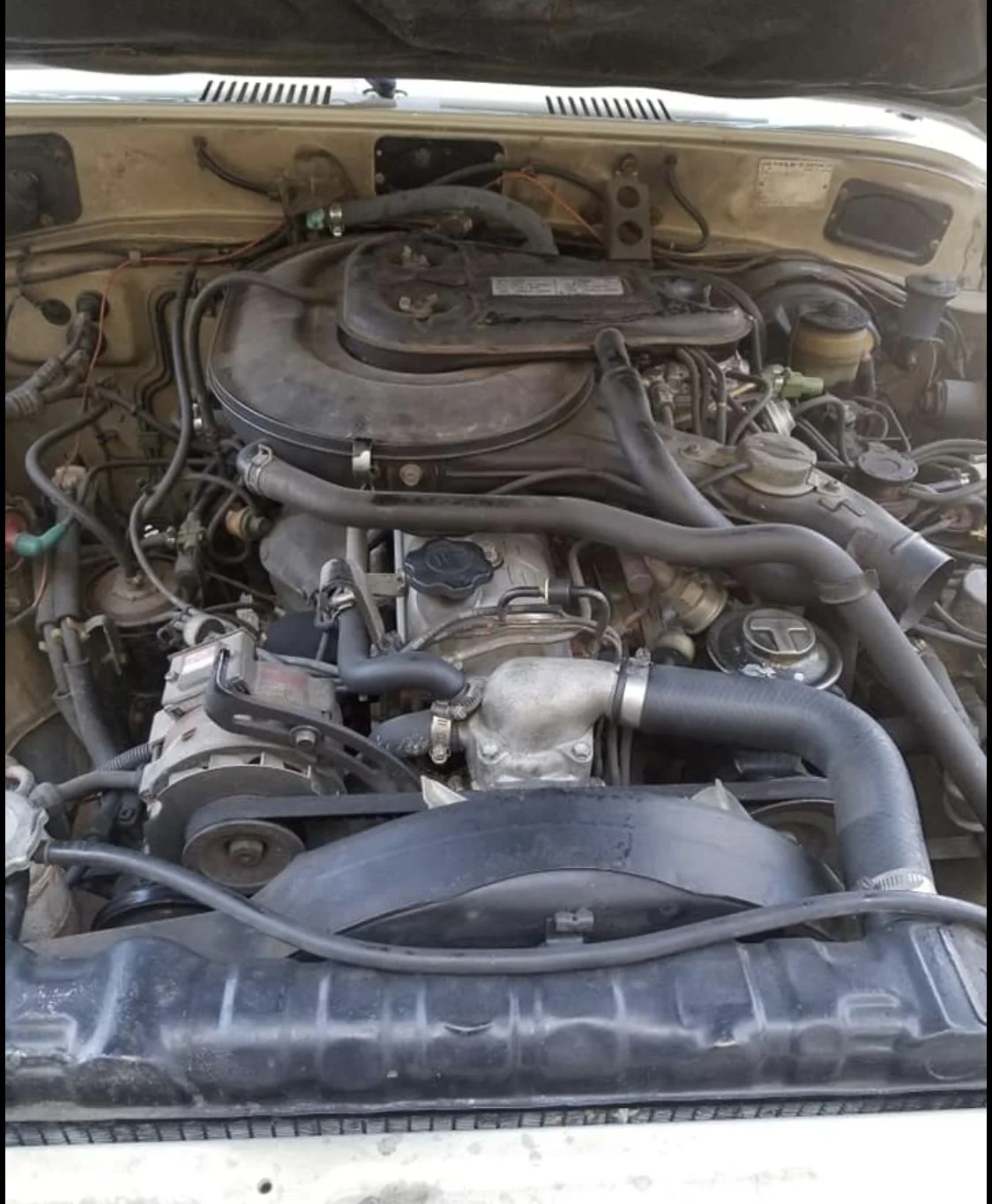

Engine was rebuilt? Looks pretty original and dirty to me, I'd be skeptical of that. Rear main and/or input shaft seal looks leak/wet, also potentially oil pan gasket. If a motor was rebuilt all of those items are replaced, otherwise its not considered rebuilt or even resealed. Transfer case is pretty wet by the output shaft. Another area for inspection.

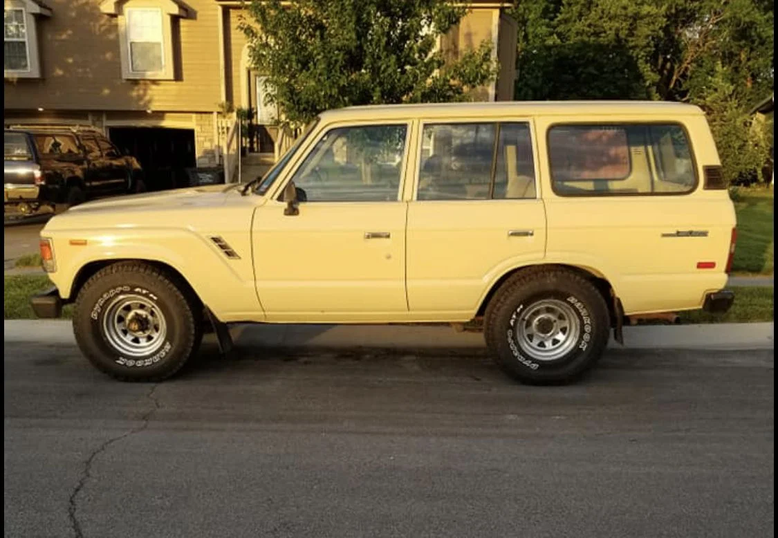

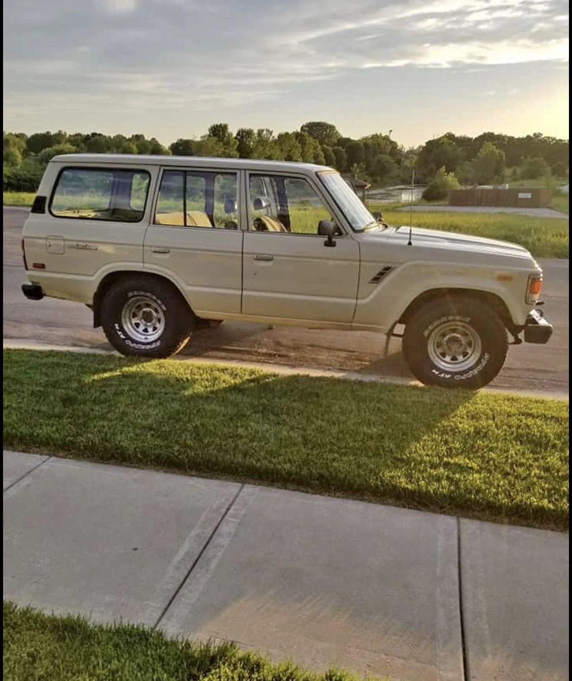

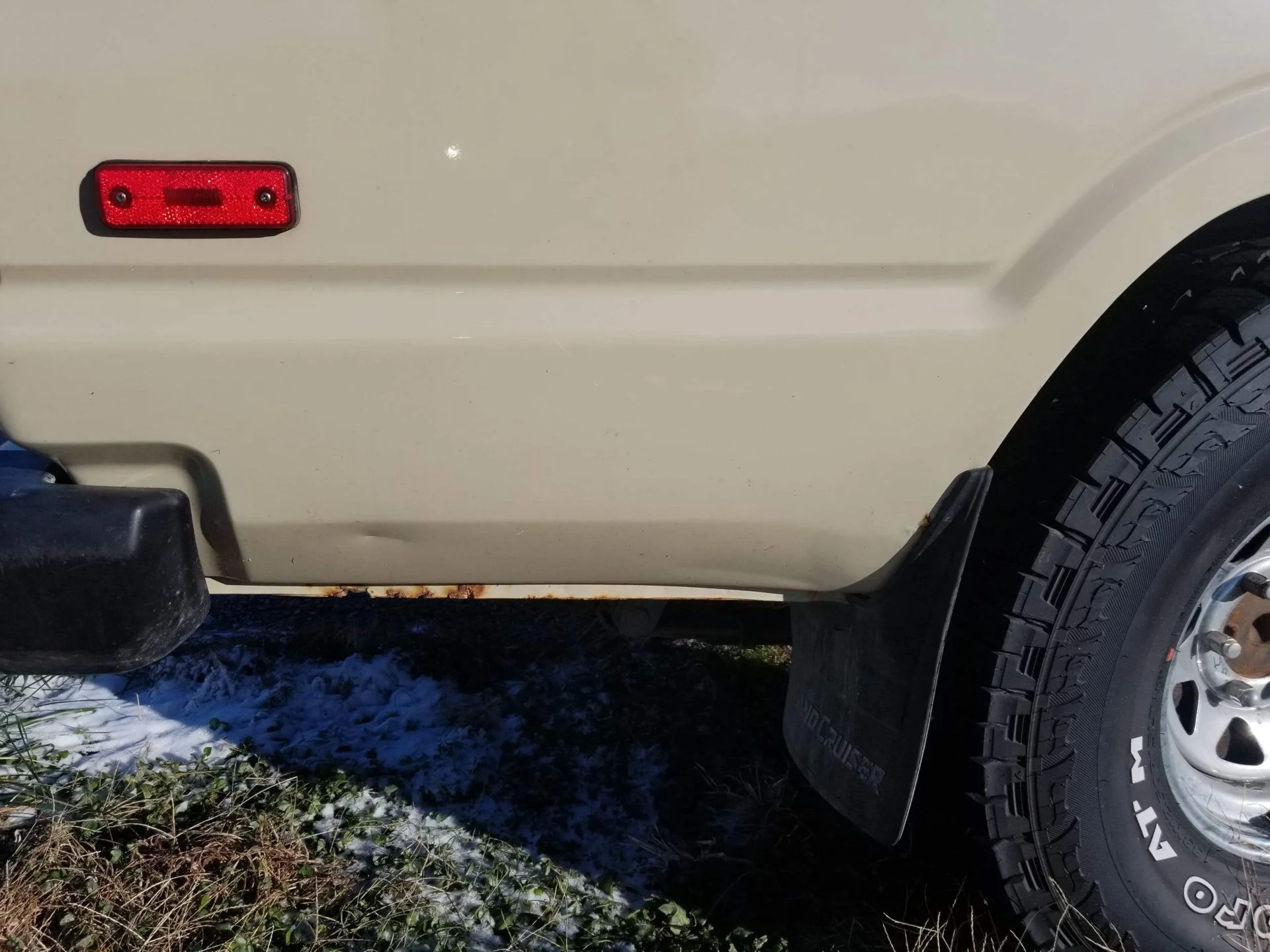

Respray looks questionable, i'd knock around for bondo and look for wavy panels and inspect the crust around the wheel wells, looks uneven. Inspect all seams on body and below.
Mechanically the top half of motor looks clean, dry and original which is good, but won't know until a compression check is done. If it runs smooth, starts up at cold start well, I'd trust its alright for at least a while.
Leaks will happen and continue to happen. No matter the case, expect to spend a few grand over the next few months baselining it if it will be driven often.
Right, the fact that it was resprsyed warrants closer inspection. Look at that photo inside the drivers door. At the bottom of the a pillar there is something that looks like rust poking through. That is not a good place for rust, if it is rust.

I’m driving 6 hours to go check out this car (so I really hope there is no bondo. should I be deterred away if there is bondo? The car spent all its years in CA up until last year when the current owner bought it. So that would make it less likely that it would have rust damage that would have required bondo or a more permanent fix, correct?
The entire west coast of California is salt water with breaking waves creating salt air. The Air Force has a directive for aircraft within 5 miles of sea water: wash with fresh water once a week. Just because a car is from CA doesn't mean it's except from rust. If the cruiser lived near the beach, the steel is toasty
We don't know, not all of California is dry and arid. Considering your questions regarding bondo, I would probably try to get someone to go with you that has more knowledge. Essentially, bondo is OK when used sparingly, but usually bondo covers up dents, rust quickly and cheaply but falls apart over time, leaving you with the rust again or even more rust due to time. Sheet metal repair is the only way around it, but we can't tell the extent without seeing in person and inspecting panels. Some use magnets, others use paint depth meters, and ultimately, just looking at the panel will usually yield the answer. You can also tap with your knuckle to hear the difference between a good metal panel and one covered in bondo.
