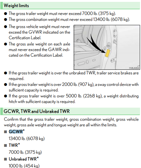

FYI, my 2017 LX570 manual says when you cross over 2000lbs towing GVWR trailer weight, use of sway control is required. Crossing 5000lbs a WD hitch is required. Just curious as to why required if rated tow cap is 7100lbs. Currently using an Equalizer WD anti-way hitch to tow a Airstream 23D, 6000lb GVWR trailer.
Likely for legal liability reasons.
Am I understanding the question is why sway control and then WD is required at various thresholds?
Simple answer is because of the dynamics of an overhung (aka ball towed) hitch. Tongue weight has the effect of reducing weight off the steer axle, reducing its directional control.
There's more to it however. Depending on what's towed, it's not always true that sway/WD control is required at those same thresholds. Large boats with long tongues don't have as substantial of tongue weights and one can tow well into higher weight just on the ball. Open car haulers, dump trailers, and heavy utility trailers are also often towed without the benefit of either.
Travel trailers are a different animal. They have significant tongue weights. Combined with substantial side area that can catch wind. Both together require more due diligence and and the benefit of WD/Sway control. Depending on the hitch used, those may not be separate distinct functions and are integrated. I would highly recommend even a 2k lb travel trailer use a lighter duty WD hitch. It greatly increases the threshold of sway and safety factor because side gusts can be no joke in the wrong situation.
