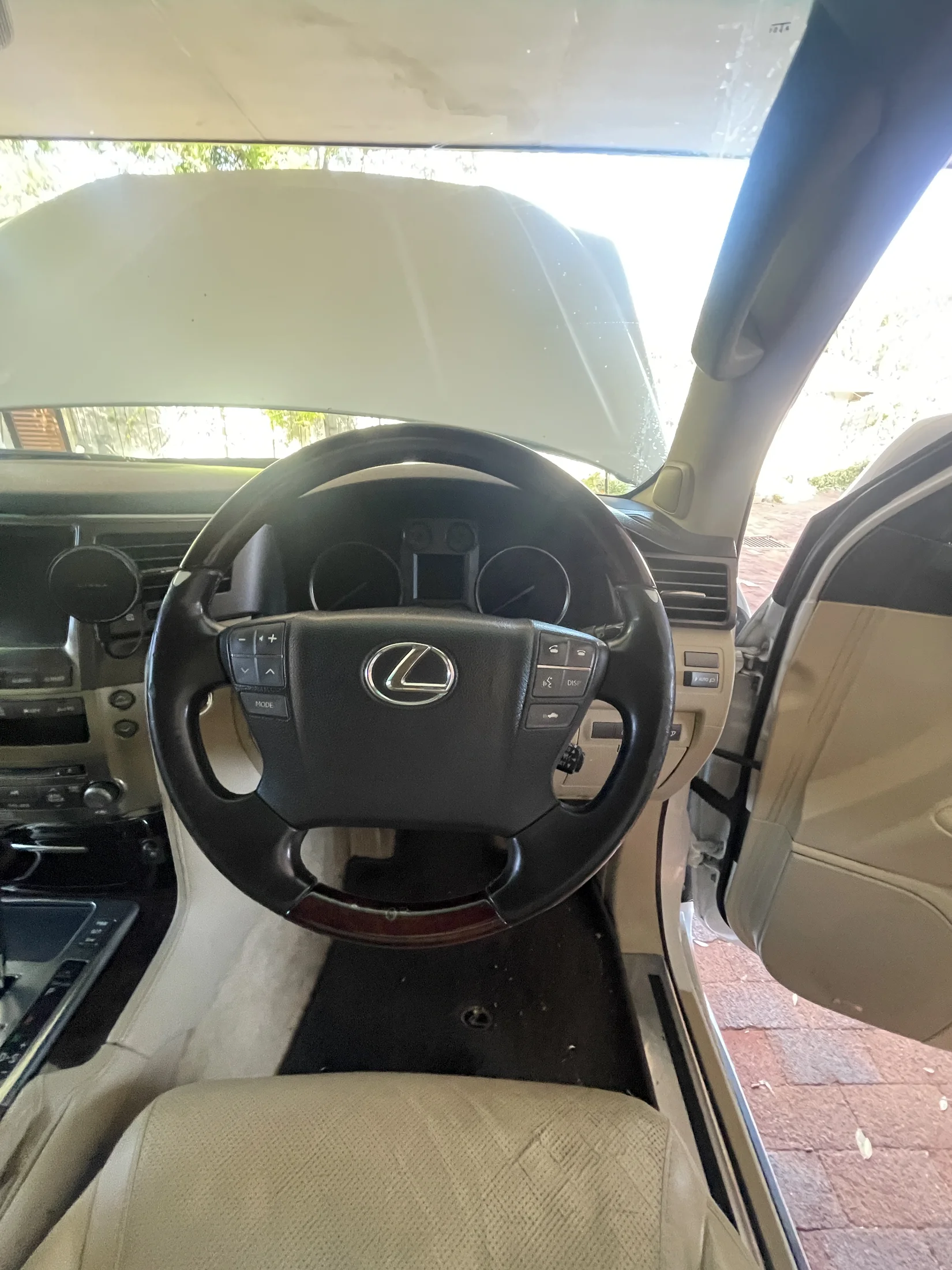

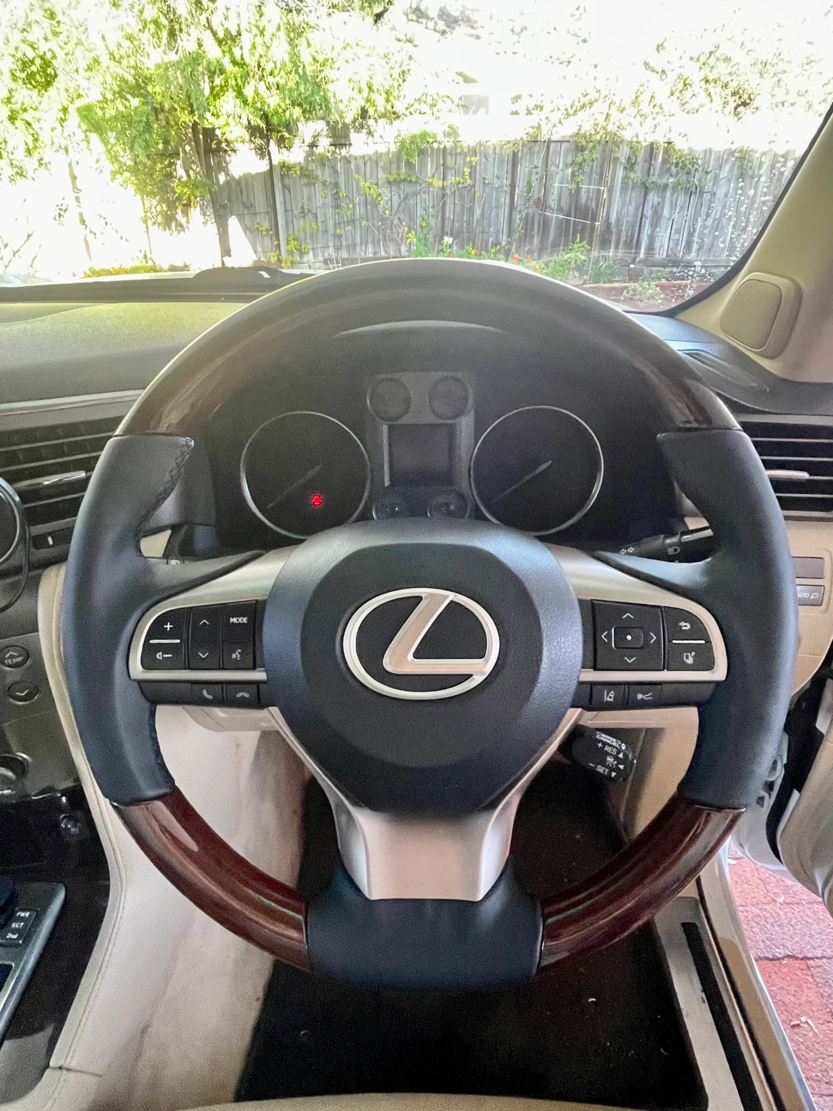

I bought a very similar wheel through alibaba recently and installed myself last week. Very happy with the quality, and completely plug-and-play with all existing features.
Similar to the youtuber, I have an early-spec(2008 AU) without the heated wheel, so I still don't have that, but the new wheel retains the radar-cruise and most of the other buttons have functionality except the lane departure, which I don't have.
