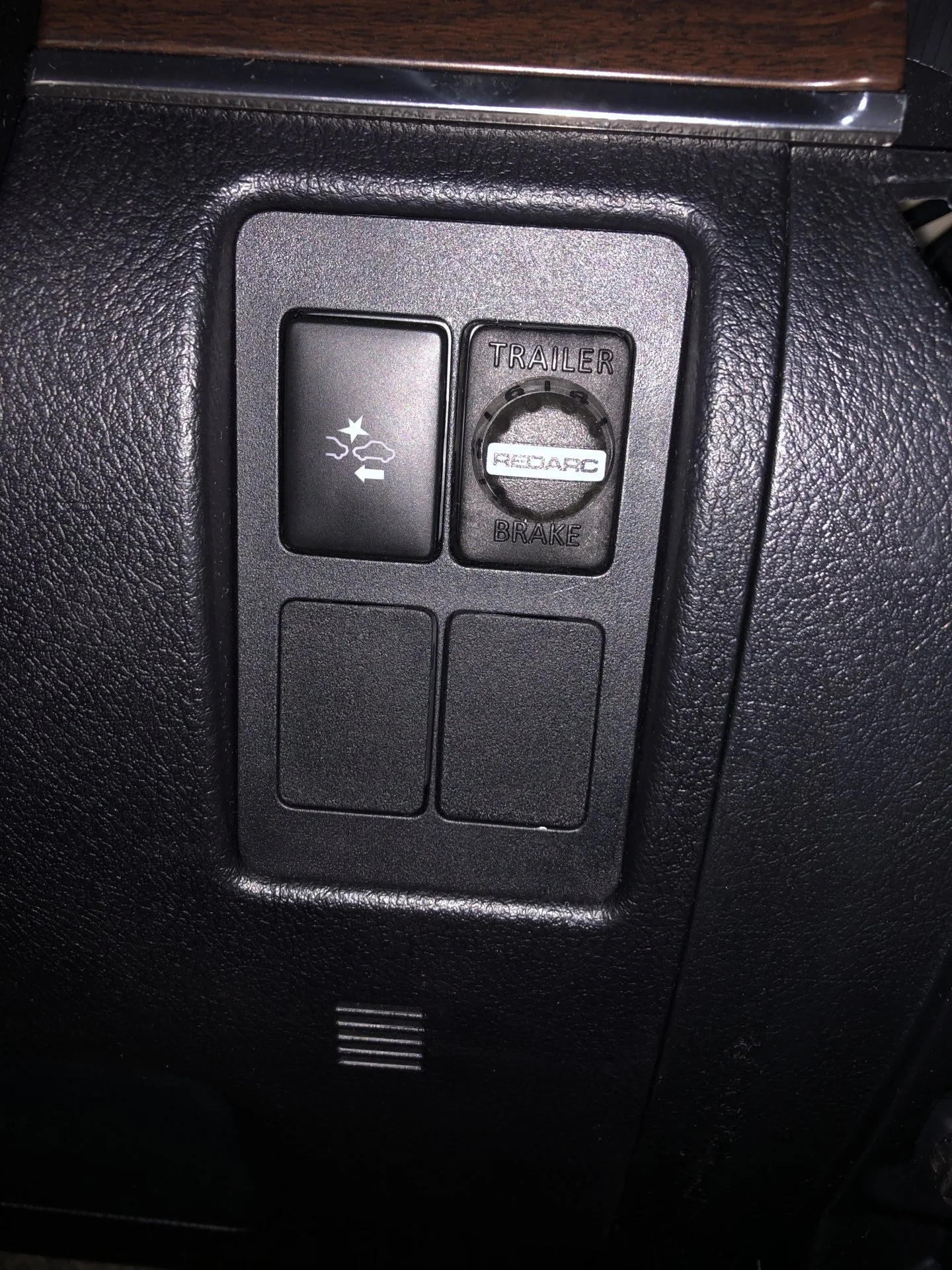

Where did you mount the controls for the Redarc? I like the built in look option!
I put mine in the panel by the right side of the steering wheel, but have seen them done many other locations.

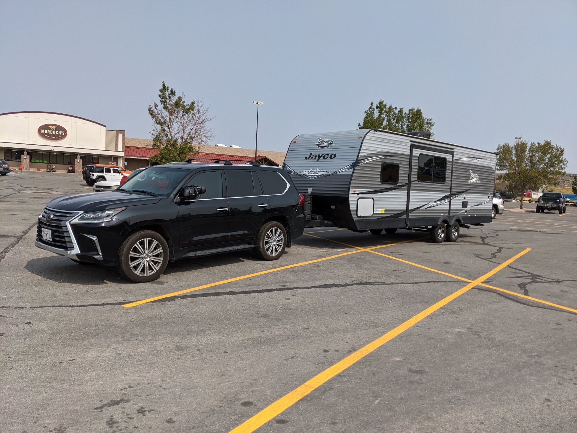

So I have a ’16 LX570 and had many of the same questions last year before renting my first travel trailer. Outside of 1 or 2 posts across all of the forums, there was very little info WRT towing heavy with a late model LX.
My trip was from SLC to Jackson, WY. All in all, I was very happy with the performance of the truck. I was carrying 6 people in the vehicle and the tongue weight was close to 800 pounds, so I was near max payload weight, in fact max everything. Anyway a few pointers from my experience below.
Setup
- I got the Redarc brake controller and clip on tow mirrors for my vehicle before the trip. I liked the clean install of the Redarc, although getting to the brake controller harness in the dash was a PITA to connect the controller.
- I rented a 24’ Jayco Bunkhouse for the trip. Length was 27’ - ball to rear bumper. I suspect the trailer loaded was in the neighborhood of 6500lbs. I initially wanted to rent a larger 26’, but didn’t want to get over my head as a newbie towing. The travel trailer I rented did not have a WD hitch, not ideal, but we managed.
- Everything else was stock on my vehicle, including the 21” tires.
Tow experience
- Overall the LX performed beautifully. Despite not having a WD hitch, I had very little sway, except a few occasions - later on this.
- Avg 8.5 to 9 MPG
- When cruising, recommend transmission in sport mode at 6th gear. Sports mode is your friend for engine braking and acceleration.
- AHC is a champ. It is amazing how much the truck sagged when loading the hitch, to only see it fully level after the AHC engaged.
- I had AHC in comfort, not thinking about adjusting it to sport suspension mode. I think sport mode may provide a little more stability in sway situations and I will try in the future.
- Only at one point did the engine labor. I was on Hwy 89 in Star Valley, WY. Probably close to 7500 ft altitude and a decent uphill grade. Needed to floor the gas for the car to maintain 60mph for the long uphill
- I closely monitored my tire pressure most of the trip. As I was concern about the heavy load on the 2 ply 21” tires. I increased the PSI per the manual for towing and my TPMS indicated that the tires were around 44-45psi while moving. Higher than I liked, but I was okay.
- On our way back on i-80, near the UT/WYO border, the winds did pick up, and I did experience 3 or 4 white knuckle moments with sway. It was enough to get my attention. I slowed my speed down to ~65mph. Issue is that the speed limit in that section is 80mph, so when trucks passed us it exacerbated the situation. I think in the small stretch of road a WD hitch probably would have greatly helped. Since my trip only involved being on i-80 for a short period of time, I was okay with it. But if I needed to drive a long stretch of interstate - esp in windy Wyoming- I definitely would have liked one.
I moved mine to the very same button location as @CharlieS when I installed it on my new LC. On the previous LC I had it on the left side and from time to time I would bump it with my leg and it would spin the adjustment knob leaving it at 10. I can‘t see it as easily in its new position but I know where it is by feel.

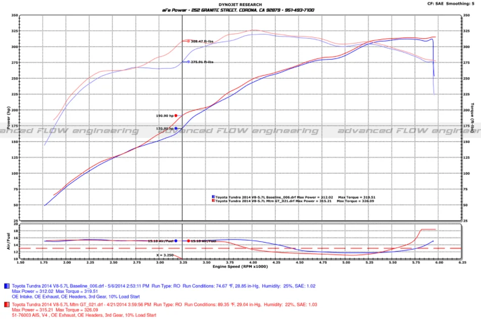

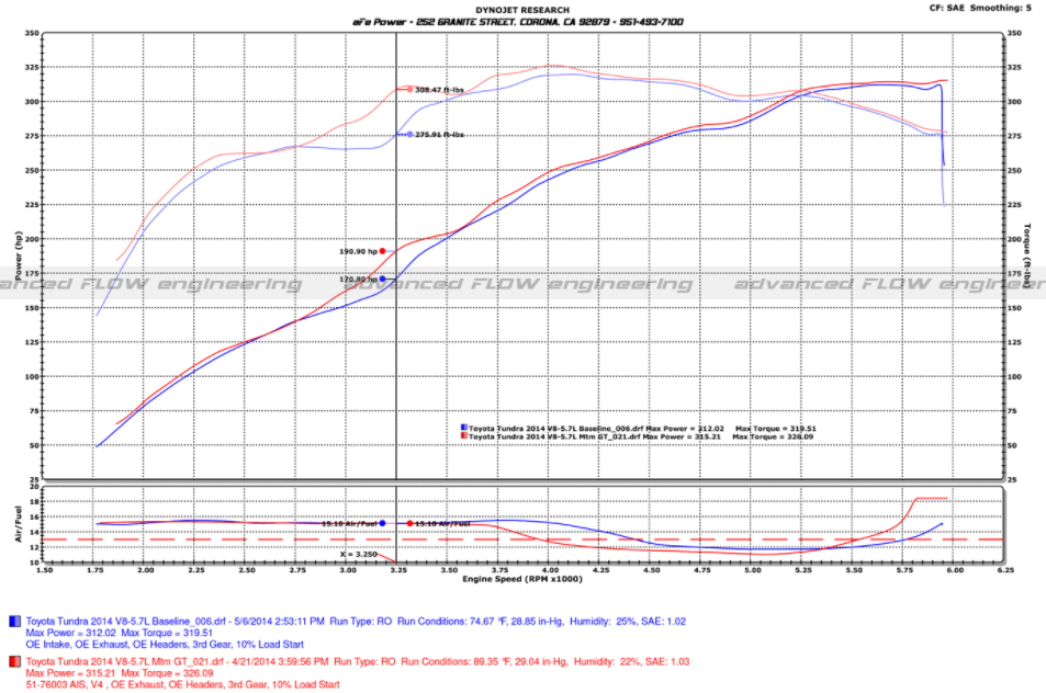

Yes, I would encourage more RPM. Max HP is @ 5600rpm for the 5.7L. Not to necessarily shoot for that as a target unless you need max oomph, as it's also its own relative peak stress level, but there is lots of room to operate with higher RPMs.
The idea with rpm is to use more combustion events to help do the climbing work. Rather than big heavy combustion events at max torque, apply more lighter combustion events. RPM also helps with additional coolant and oil flow, both in the engine and transmission.
The 5.7L is overall a strong and flexible motor. It's likely happy to operate low, high, and everything in between, so it's really just an optimization recommendation.
Perhaps also interesting is the climbing performance available at max HP. HP is ~200HP @ 3500 RPM vs ~320 HP @ 5600 RPM.
