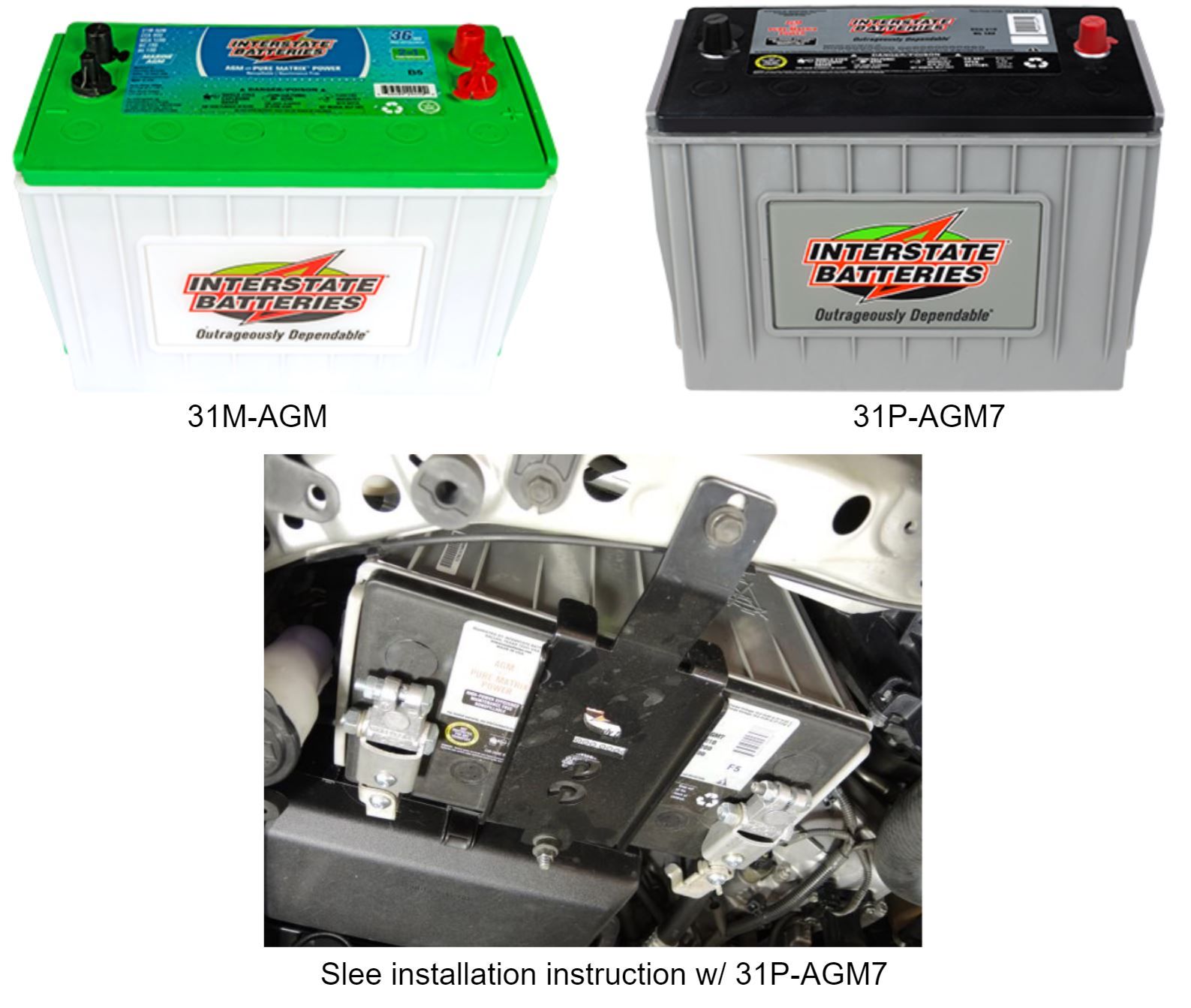

Btw, for fun, I had put together this image comparing the 31P to the 31M and then offering a view of Slee's installation of the 31P w/ the terminal extensions. You can see what markuson was talking about...
I have the Slee upgrade tray and the Interstate 31P-AGM7 which is actually the second truck I've done the exact same treatment to. The most recent one I installed in May, and it died a couple of weeks ago. My battery tester showed 3% health even on a 100% charge. I use the Odyssey OBC-20A conditioner/charger on the AGM batteries at least once a month to keep them topped up since the alternator has been shown to not quite get it to 100%. I returned the 31P-AGM7 to get a warranty replacement, and they suggested I try the 31M as well. We wheeled it out to the truck, put it in the tray, and the terminals don't quite work with the Slee setup. I replaced with another 31P, and all has been well since. I think the key to a good long life with these AGM batteries is to put it on a good conditioner/charger periodically and monitor from time with a battery tester (like this one https://smile.amazon.com/gp/product/B01M0ARG3X/?tag=ihco-20) to make sure everything is ok.

Hey guys, my 200's battery died on Sunday and been letting her sit while I figure out what to do next.
Ordered the Slee primary tray replacement that allows for Group 31 fitment, should arrive tomorrow.
Called Interstate's distribution center in the East Valley of Phoenix and they only have the 31M-AGM in stock; 31P-AGM7 is currently out of stock.
From markuson's post, quoted above, it seems that the 31M won't fit too well and I should just wait for the 31P.
Then I saw Taco2Cruiser's post on Northstar, also above. The NSB-AGM31 is *slightly* smaller all around than the 31P, so theoretically should fit in Slee's tray. Would the Northstar be a recommended alternative to the Interstate?

A Northstar 31 marine fits (just barely) within the factory plastic battery tray. Which in my opinion is better because... what is really gained from adding a heavy metal tray that requires drilling, when there is already a super strong metal tray?
I made my own tie down, but from what I remember the interstate is 9.375” tall versus the Northstar which is 9.78”. So not putting in the Slee tray, will buy you some additional space for the Northstars tall profile. Double check my numbers though. But I think you can play with the Slee tie down to make it work.
Given the Interstate is not available locally (apparently sold out across the entire East Valley of Phoenix) and the X2Power 31M is on the shelf at multiple local Batteriesplus stores, I may just be going the Northstar route.
As the voltage booster is now on order from Oz, will see if the 31P is back in stock when the HKB arrives next week and then make a decision. The ease of getting a replacement weighs on the mind, though. Maybe I'll just get impatient, go X2 when am home on Friday, get her back on the road, and throw on the HKB whenever it arrives.
Decisions, decisions...
If I do go X2, will let you know what (if anything) I use from Slee's primary tray kit. That gets delivered tomorrow.
