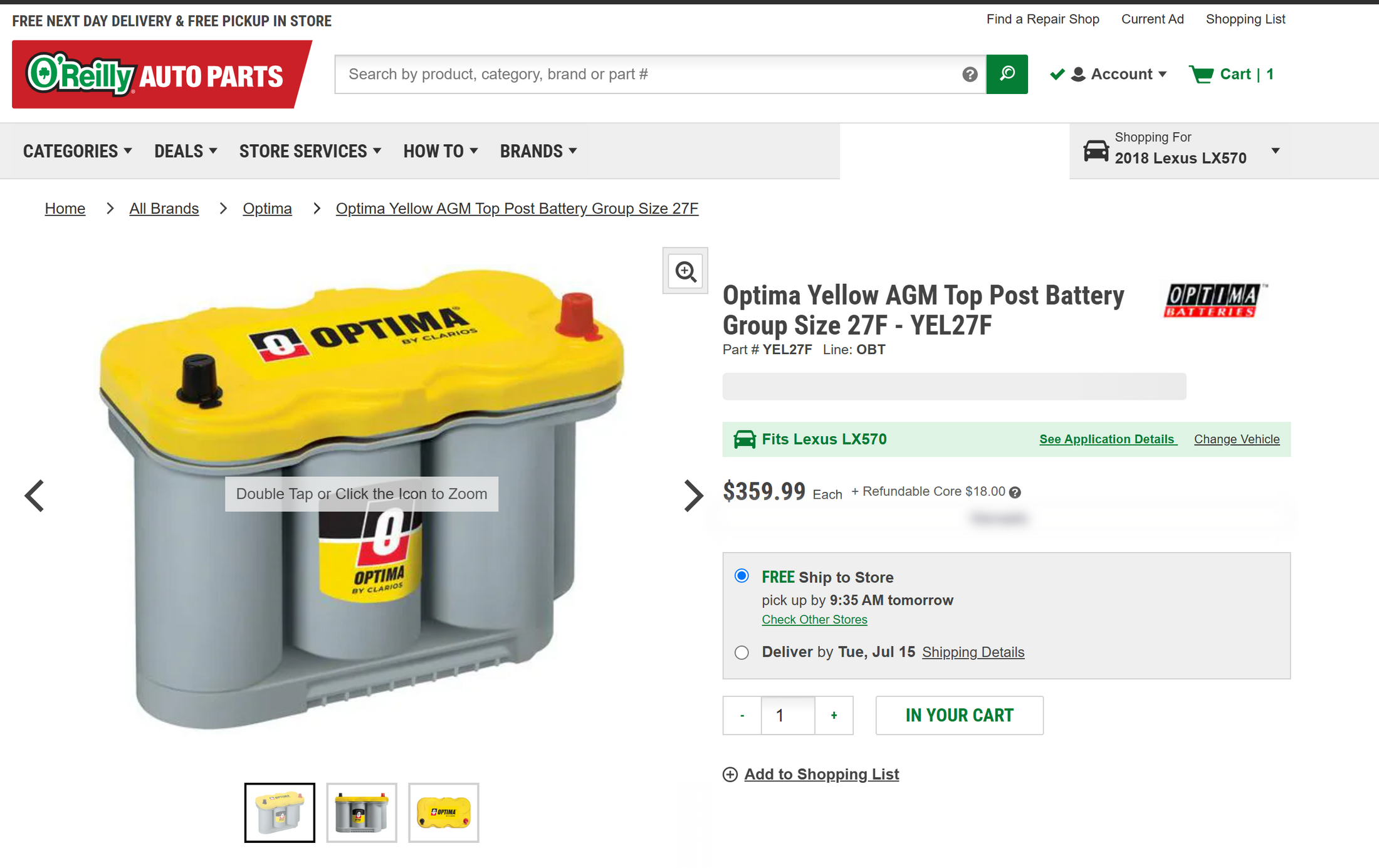

Optima Yellow AGM Top Post Battery Group Size 27F - YEL27F​
I think the next best 27F AGM.
I just saw this. Apparently Optima is now distributed by Interstate batteries - this is news to me. These batteries used to be amazing IIRC, then they had a fall from grace regarding warranty denials, poor craftsmanship/performance and I haven't checked into them since.
Maybe they've improved since partnering with Interstate? Regardless, post what you end up going with and if you're questioning your battery, get a new one sooner than not as @TeCKis300 alluded to.
Skip the AGM. There was a time when they were awesome, but with the advent of temp compensating and smart alternators, AGMs in modern cars that are configured for lead acids, will be compromised, die an premature death, and will never deliver on promised value.
