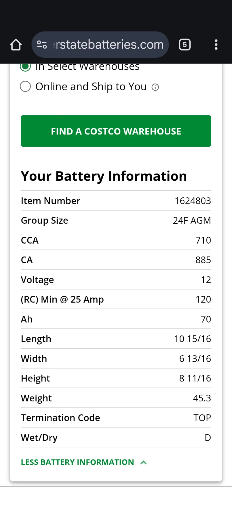

I wasn't aware. Costco website gave me this 24F when I put in the 2018 Lexus lx
Ah, yeah. I believe the 24 is a similar height so the clamp will technically hold it down, but a 24 is significantly shorter in length than a 27, and that reduced volume ultimately means less reserve capacity.

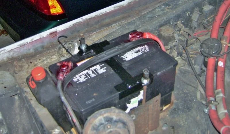

So, back in the 60s & 70s the battery on Ford pickups sat on the passenger inner fender. The positive cable ran about 12" towards the firewall and went to the remote-mounted (on the inner fender) starter solenoid. The positive cable then went from the solenoid down to the starter. The negative cable jumped the gap from the battery over to the front of the engine.
Because of this unique battery placement, the terminals were reversed on the battery - Ford designated their replacement Motorcraft batteries as Group 27 F ( for "Ford"). Worked in Ford Parts back in the 70s and this is how it was explained to me.

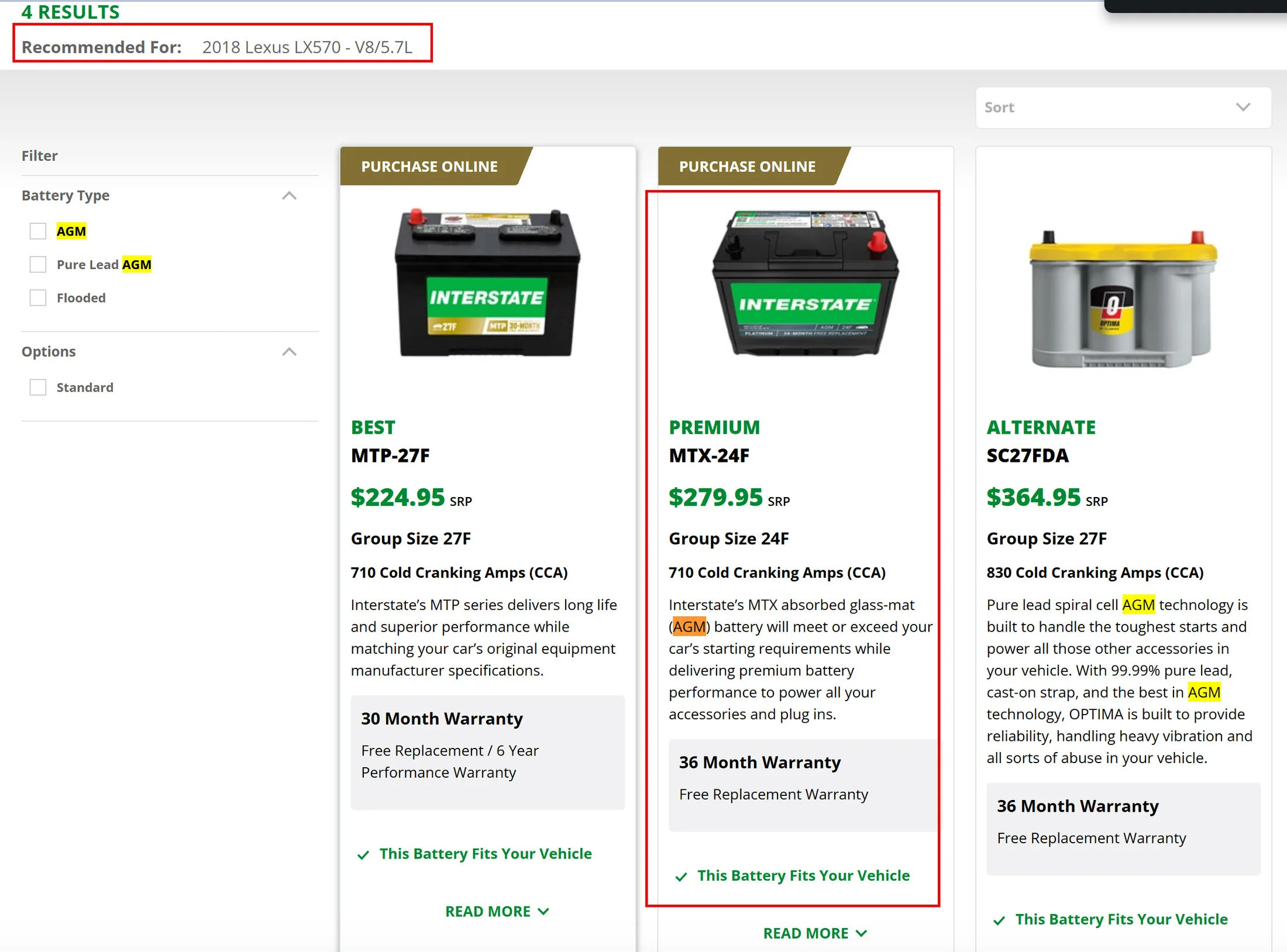

Strangely, Interstate website gives the following: right two are AGM for the 2018 Lexus LX
I installed in my 2013 LX cause Costco had no 27Fs in either local stores and the auto parts stores want $269 for a Diehard Silver 27F. I got the 24F for $123. I can go through 2 of those for the same price as a Diehard Silver 27F. Around 10 CCA difference and not much reserve capacity difference.
They didn't screw anything up, the 24F is an alternate group size for the 200.

I’m using an interstate MTP-27F in mine with great results. Have also had MTP series batteries in two other vehicles without issue.
I understand their marketing will push you toward an MTX-24 as “better” but that isn’t necessarily true.
