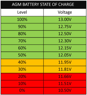

Before I left home, the battery registered 12.68v. When I returned, the battery registered 12.98v. This is on stock diode in an 11 LC200; voltage booster is still in transit from Oz.
Isn’t full charge for an AGM at 13.0v, per the attached?
The alternator was probably charging at the “cold” setting for most the short errands (higher voltage).
But, this leads me to think the stock diode might be doing the trick with keeping this X2 near top off.
Am I being lulled into a false sense of security thinking the voltage booster might not be needed? Will the charging profile change on a long trip and/or after eating into the X2’s capacity with a few nights of lights and tunes? Or maybe I just have a freak alternator / diode setup that is a little outside the typical bell curve in favor of AGMs?

In addittion the voltages you measured will go down as the surface charge wears off to what is called a float voltage. All of the electronics have a small but steady parasitic draw. It maybe enlightening to install a dual voltage meter to monitor battery state?
Good to know. Learned something new. Thx.

I’m at 12.81v after sitting over night.
12.81 is about a 95% charge - at least according to the chart above. That seems to be pretty good.
It depends on the battery. The WindyNation 100Ah AGMs have a full charge at 12.84V and are fully discarged at 11.64V. Email the manufacturer and ask, don't just assume.

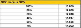

Here is the official reply from NorthStar's Director of National Accounts, Transportation Products:
Thank you for reaching out to NorthStar Battery.
A fully charged 27F battery will range between 12.7 – 13.0 volts.
[edit 9/11/18]
By way of follow-up conversation, the below was provided in supplement:
The chart is below. I will caution you that this charge (SoC in general) is based on Open Circuit Voltage (OCV), which means when the battery is not connected to anything. Once the battery is connected to a circuit, you would then be looking at Closed Circuit Voltage (CCV) and that chart is based upon amp load of the circuit and therefore there is no standard chart.
